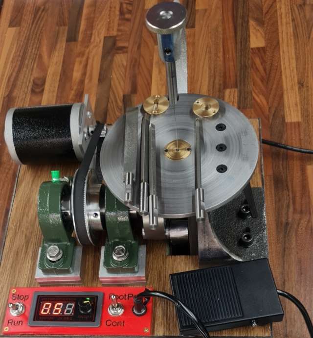

                  Peter Cook 6
                    @petercook6
                    I use the same sewing machine motor as you do, but use a cheap thyristor speed control like this with an on/off foot switch.
                    One switch is wired as on/off, one is wired as foot/continuous and speed is controlled by the knob. Stop/start with the foot switch always returns to the same speed.

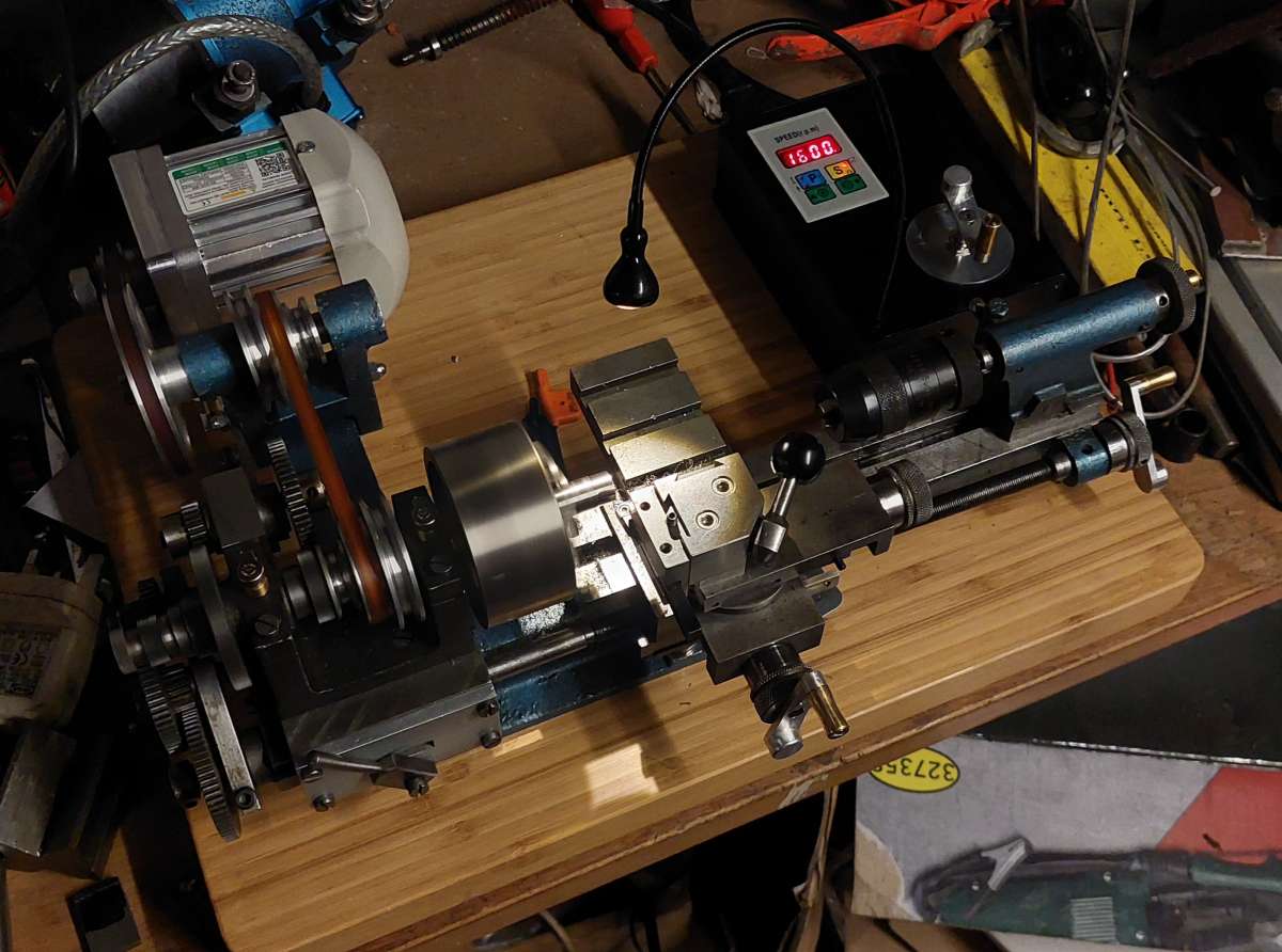

                            I run a Perris (Cowells predecessor) lathe using the Vevor brushless sewing machine motor I mentioned in that thread. I re-boxed the controller in an aluminium enclosure and used a 10-turn potentiometer for speed control (electrically isolated since the potentiometer ends up at high voltage). The torque is only limited by belt friction at any speed.
                            20221223_174052Andrew.

                                You can now get those brushless motorising units configured for use as power unit for general rotary equipment, with a generic machine control pendant rather than sewing machine specific. £140 on the bay half that from aliexcess.
                                550W- 2.2KW Brushless Servo Motor & Controller Driver For Belt Sander CNC Lathe
                                I would take the power ratings with a pinch of salt, but one would certainly be a contender. I have the sewing machine version, not put into use pending conversion to VR control. Somewhat surprised to learn that it gets mains voltage down to the VR. I thought the hall sensor control side was 0.5 to 5 volt. I did have some notes from my previous fiddlings, but cant find them now.

                                  Andrew, can I ask how hot the motor gets when you are working the lathe moderately hard?

                                              Andrew Entwistle
                                                @andrewentwistle
                                                Hi Martin,
                                                I have not worked the lathe hard so I don’t know how hot it can get, I’ll do a test with something like 1″ steel and will get back to you, probably the end of the weekend.
                                                Andrew.

                                                    #749352
                                                    Peter Cook 6
                                                      @petercook6
                                                      I have installed this motor with this controller on my filing machine. I use a 24v power brick to supply it. Its a 100W brushed DC motor 100mm long and 68mm diameter. It works very well. Quiet, lots of speed control plenty of torque to drive the filing machine. It was simple to install and although the controller has a push on/push off switch in the knob I included switches on/off and foot/continuous to make it a bit more ergonomic.
                                                      Filing Machine 2
