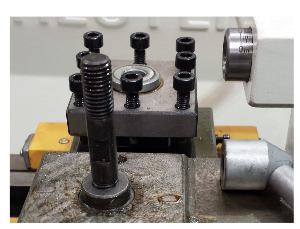

            Thanks john that’s the one I’ve been looking at, but I think it will need a bit of modifying I took my tool post of today and where it’s mounted on the top slide it’s not flat and after removing the 10mm threaded bolt there is a raised boss, that looks to be about 20mm dia x 6mm, I didn’t measure it but it looks like it would need a 20mm x 6mm deep hole drilled in the base of the quick release tool holder, so don’t know if that could be done, has any body else have any ideas.

                      Mike,
                      I can see that the boss would be a problem and instead of removing it , I think I would make a spacer to fit over it to bring the topslide "up", as it were. That will retain the strength. Ideally surface grind the spacer and topslide, or failing that make the spacer slightly thicker than the boss. Think big rectangular washer.

                        Thanks guys this a photo of the top slide 10mm bolt, the stud is 20mm x 4mm, base of slide is 25mm to centre.

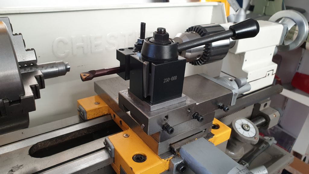

                          Lainchy
                            @lainchy
                            Posted by John Hinkley on 13/01/2020 12:11:54:
                            Mike,
                            Edited By John Hinkley on 13/01/2020 12:14:20
                            That's exactly what I did with mine…. Square plate, 1/4 thick as I recall, 18mm hole in the centre. I want to screw it down to the compound, but not done that yet. It works well. Do avoid the slanted parting tool holder though unless you're prepared to mill off some of the bottom. The ordinary flat parting tool holder works well with a 3/32nd HSS blade.

                            Lainchy
                              @lainchy
                              20190615_201203.jpgI'll upload a picture in a mo showing the plate and the toolpost.

                                Mike 90
                                  @mike90
                                  Thanks for that lainchy it looks to be the arc 000 wedge tool post, did you use the bolt that is supplied and is it long enough, and does it use the standard tool holders or the shorter ones.

                                  Lainchy
                                    @lainchy
                                    Yep, with the plate, everything is standard. The original tool post bolt goes into the box of bits for the lathe, and you use the one supplied with the new toolpost. The only thing I'd say, is that the flat holder for the parting blade, has the height adjuster right down, as in, the blade is almost as high as it will go, but so far, its been perfect. You need this blade holder…** Link ** if you're going that way. ARC's pricing on the holders is pretty good.
                                    Sorry (Edit) Standard tool holders are fine. 250-001 – just the 007T and a 3/32nd blade if you go for the HSS blades. 1/16th is too thin I find.

                                    Mike 90
                                      @mike90
                                      Thanks Lainchy recieved parcel yesterday from arc that was ordered Monday, and today I finished modifying my arc quick release wedge type tool post, as suggested I Turned the supplied thick washer down to 5mm to fit over the boss on the cross slide, and bored out the 10mm tapped hole to 18mm, and l am very pleased with the results,
