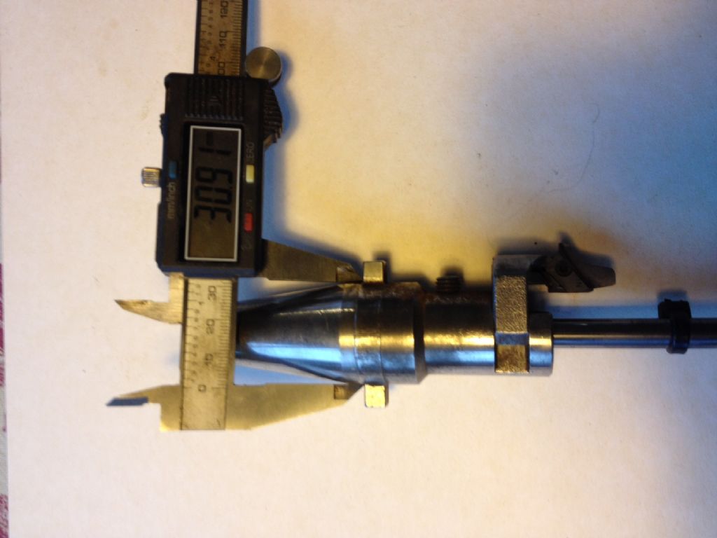

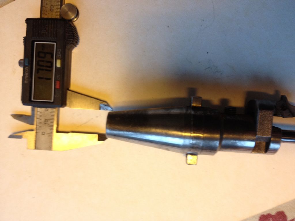

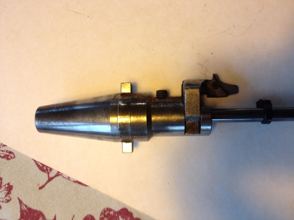

In my continuing clean up of the workshop I've come across this, but am unsure what the arbor is. I got it years ago with a bunch of other stuff.
I'm unfamiliar with NT arbours having only seen photos, but it looks a bit like one.
You will have to give some indication of the length between caliper readings
Roy
The length of taper is about 50mm
Looks like INT 30. The wide end of INT tapers in mm is very roughly the taper number and being home made will be approx. anyway.
