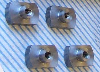

                              Of the ones I’ve made I have not even bothered to make them T section, just a bit of flat mild steel bar probably EN3 cut to a length longer than the width, drilled and tapped. So less depth of thread than a tee nut and not had a problem even on occasions when off the shelf threaded rod is used and that is often undersize.

                                SAM_0803SAM_0801We have made lots for both mills, rotary table and for a lathe faceplate. When you make your own, they can be a much better fit and longer also with a choice of different threads than you get with bought ones. My steel of choice is key steel which is slightly higher tensile than mild steel, but readily machinable. The most challenging ones I made were for holding the compound down to the cross slide on the Smart & Brown model A. They fit in a round dovetail groove and because there is not enough metal in them for tapping, they are one piece with the 5/16″BSF shanks. A custom tapered milling cutter was kindly made for us as the dovetail was not a common angle.
                                When you make the nuts, consider using metric threads as you can then easily buy fully threaded metre lengths and cut exactly the lengths to best suit every workpiece.

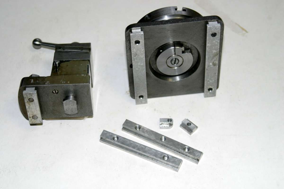

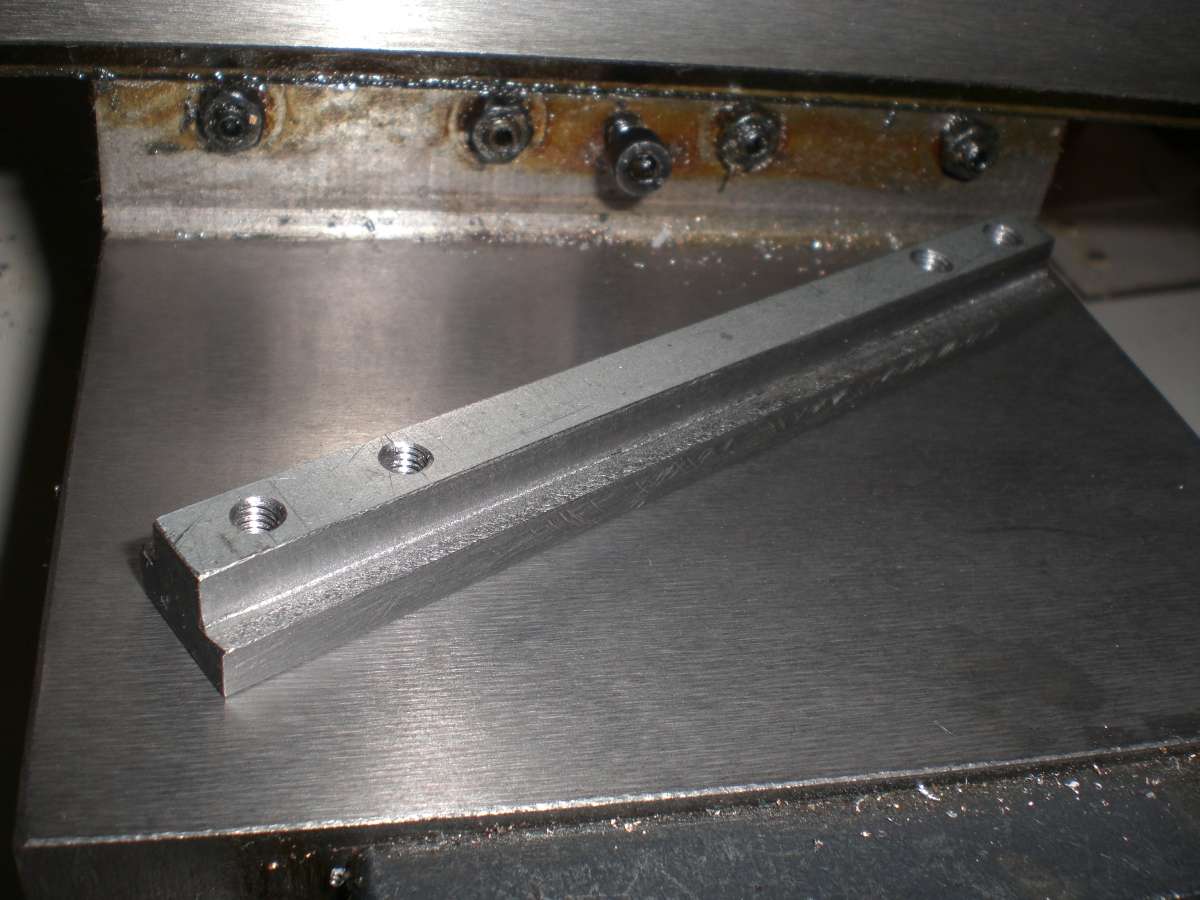

                                #704961
                                Nigel Graham 2
                                  @nigelgraham2
                                  For very delicate T-slots consider making a T-strip rather than single nuts. This is drilled and tapped with several holes, so it vaguely resembles a Meccano strip. Again, stake the end threads or use short threads on the studs so you can’t run the screw into the slot floor.
                                  I did such especially, with just two holes in each of two strips, for my EW lathe’s vertical slide vice.

                                  #704969
                                  John Purdy
                                    @johnpurdy78347
                                    Along the lines of what Nigel has said I have done that for GHT’s rear tool post and small rotary table for holding them on the Myford cross slide. Makes installation so much easier rather than trying to line up individual tee nuts. The ones on the rotary table, when done up tight provide a convenient way to hold it in the jaws of the milling vice with the underside of the base sitting on the top of the jaws. The two separate long ones were for a purpose long forgotten and the little short ones are for the tee slots in the rotary table.
                                    All are from 6061-T6 aluminum. I have never, in 30 odd years, stripped one out or had a setup shift except for the one occasion where due to an “interrupted procedure” (the cause of probably 50% or more of aircraft accidents) I missed tightening up the nut on one stud.

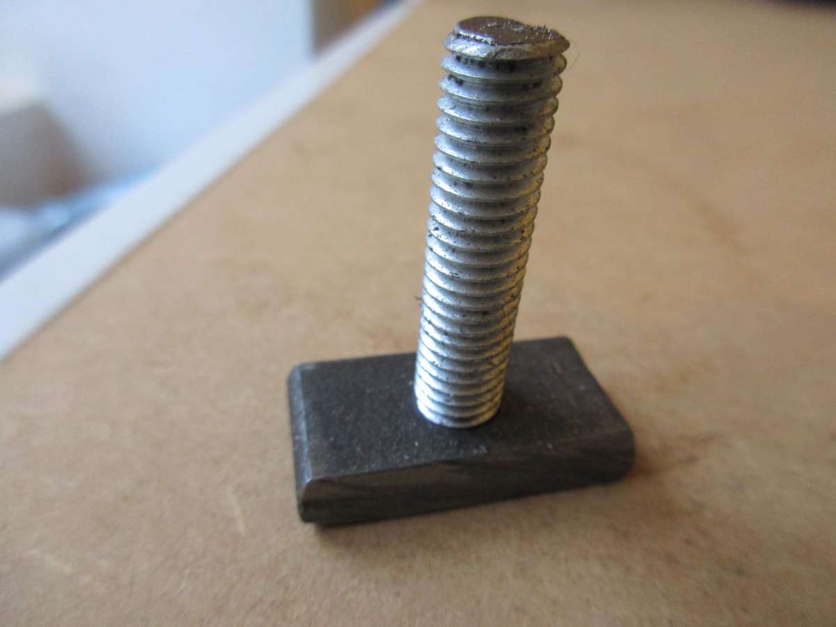

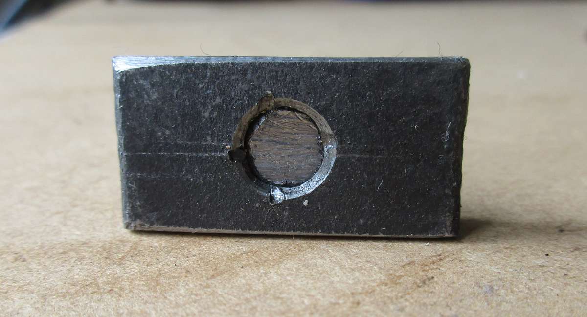

                                            Nicholas Farr
                                              @nicholasfarr14254
                                              Hi, as old mart, I’ve also made them from key-steel, as I had a short length the correct width, to just mill each side to the slot width.
                                              CIMG1350
                                              Also as JasonB, made flat ones, mine being black mild steel bar, which enabled a larger piece of threaded rod to be used in my mini mill slots, when clamping down anything with a wide slot.
                                              IMG_0873
                                              I just staked these on one side with a dot punch in four places.
                                              IMG_0874 - Copy
                                              Regards Nick.
