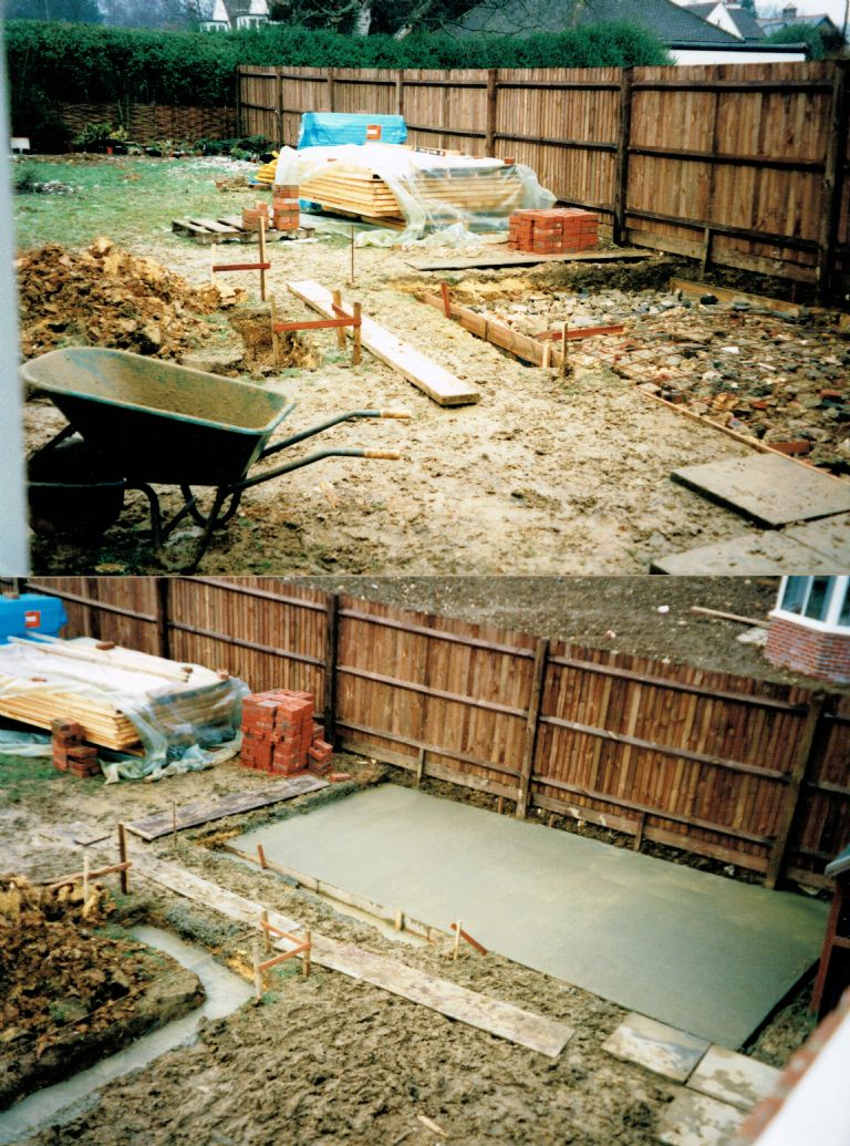

                  Mine is 4" compacted hardcore and approx 4" concrete with a sheet of A142 mesh, not moved for the last 25yrs. 2.8m x 4.9m. Topsoil dig out and onto the clay.

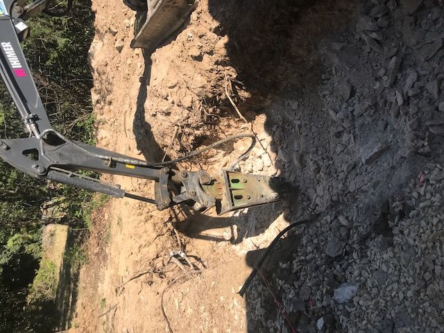

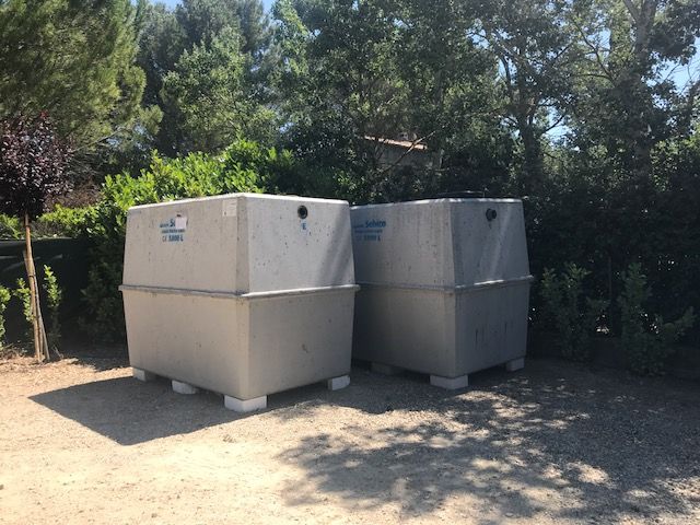

                                    @simondavies3
                                    Timely topic….
                                    The builders are hard at work on my garage/workshop extension (4m x 6.5m) with a feature that might be of interest to others:
                                    I am having two large (5000l) concrete septic tanks installed under the floor which will become part of the structure. They are roughly 1.9m high, 1.6m wide and 2.2m long with a manhole access. We intend to cut a proper trap door size hole in them and install a step ladder style access. Ventilation to be installed as well.
                                    I think we can assume that they will be waterproof……smiley
                                    Just large enough for a set of shelving for all of those things that like to be maintained at a near constant temperature – like paints, glues, etc, etc.
                                    Number 1 will be for workshop use, number 2 will be the wine cave…..
                                    The guys have just finished digging the hole – they got down to around 30cm above the desired depth and hit bed rock – this morning has seen the slow pneumatic hammering away, layer by layer.
                                    Gravel to be laid under the tanks, then side filled and then the real workshop foundations dug around them. When the floor is laid the tanks will become part of the reinforcement.
                                    Intending to get one of those super-smooth finishes on the concrete and then seal with 'something'!

                                        Simon, I hope they don't float away. When they install septic tanks around here, they fill them with water to stop them floating in the ground water. Even swimming pools can float if they are empty – think concrete Thames barges! Good luck and I hope I am wrong.

                                                    simondavies3
                                                      @simondavies3
                                                      Posted by Speedy Builder5 on 17/07/2018 14:33:08:
                                                      BobH
                                                      Bob, I hope they don't float away either but given the local geology and our annual rainfall of less than 18", I don't expect a problem – and the builder has installed several others elsewhere too that are still firmly underground.
                                                      Watch this space though!
