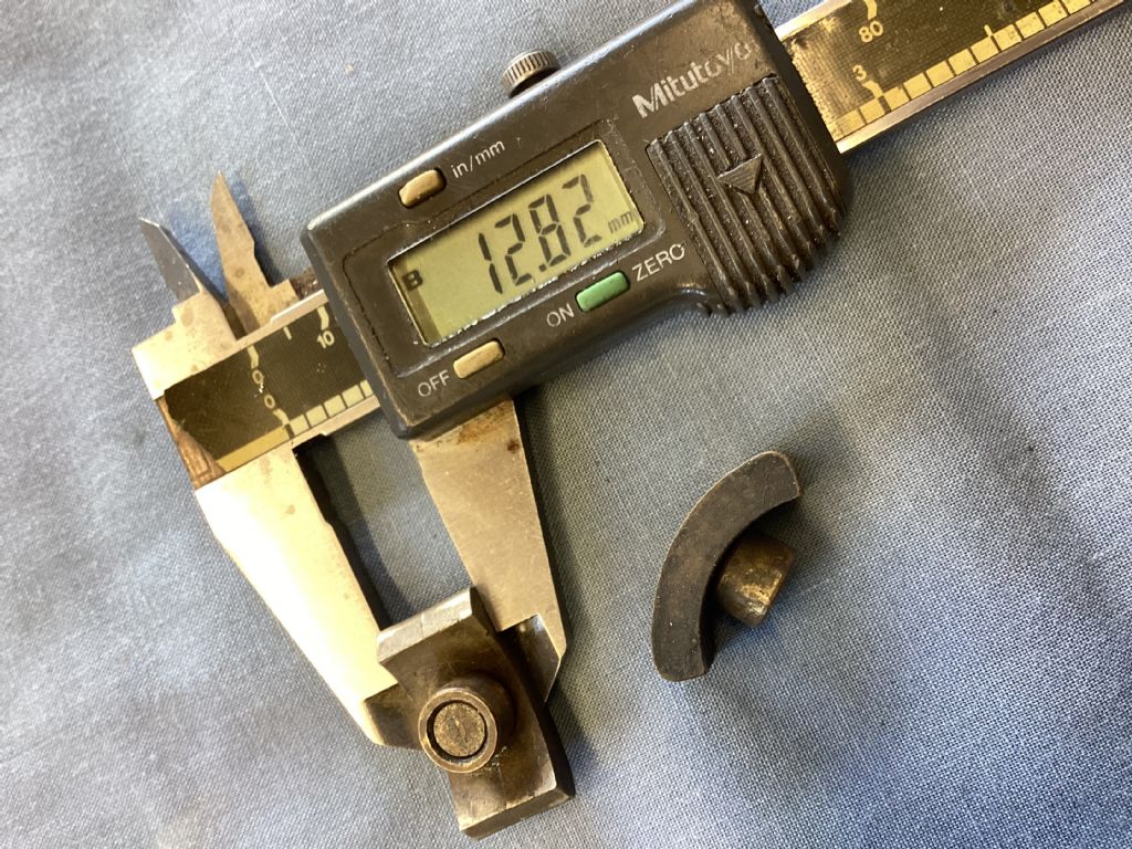

      Any ideas what these brass/bronze thingys are?

              Looks like they could be part of a centrifugal clutch mechanism

                I would not thought that it is part of a centrifugal clutch mechanism as they do not have any means of attaching a spring to hold it in to return them to the resting position when RPM lowers
                #659071
                  But do you have any suggestion what they might be ?

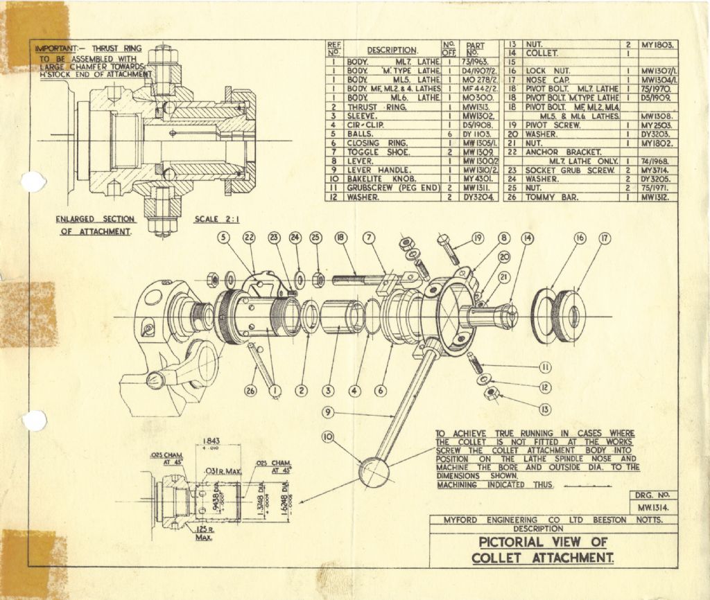

                    I have seen very similar, but with the boss on the outside of the curve, in a lever-operated lathe spindle-mounted collet chuck.
                    The closing ring, to which the lever is attached, remains stationary and only moves forward or backward when operating the lever. The bronze slippers run in a groove in the part of the closing ring that rotates with the chuck.
                    I must stress that the ones I have seen are inside out compared to the ones you show, so the above could be highly misleading.
                    Edit: part number 7 in this drawing:
                    https://www.model-engineer.co.uk/wp-content/uploads/sites/4/images/member_albums/91402/893454.jpg
