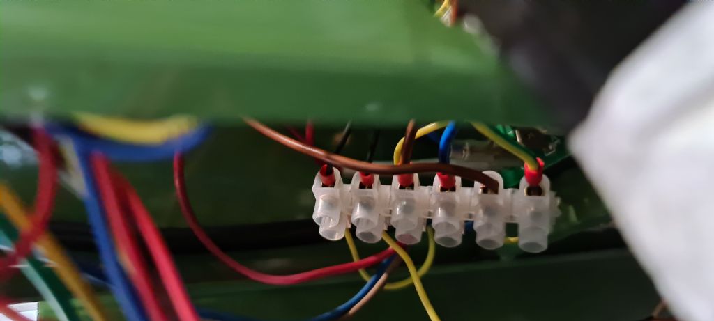

      Hi all bit of help – lathe had stopped working – traced it to a loose brown wire going into a white 8 block connector at the back – fixed that – but it again came loose so again reattached it only to find a yellow wire coming out of the same block had detached and I cannot see where it goes/connects to it seems to be the continuation of the black wires from the micro switch that controls the cut off when you lift the protection screen – I can see one of the yellow wires coming out of the block joins into a circuit board but the other is free hanging – any help? If you are looking at the block there are two blacks wires that are connected to yellow wires and it is the second yellow wire in that has disconnected

          Sorry its a 6 block connector 6 in 6 out

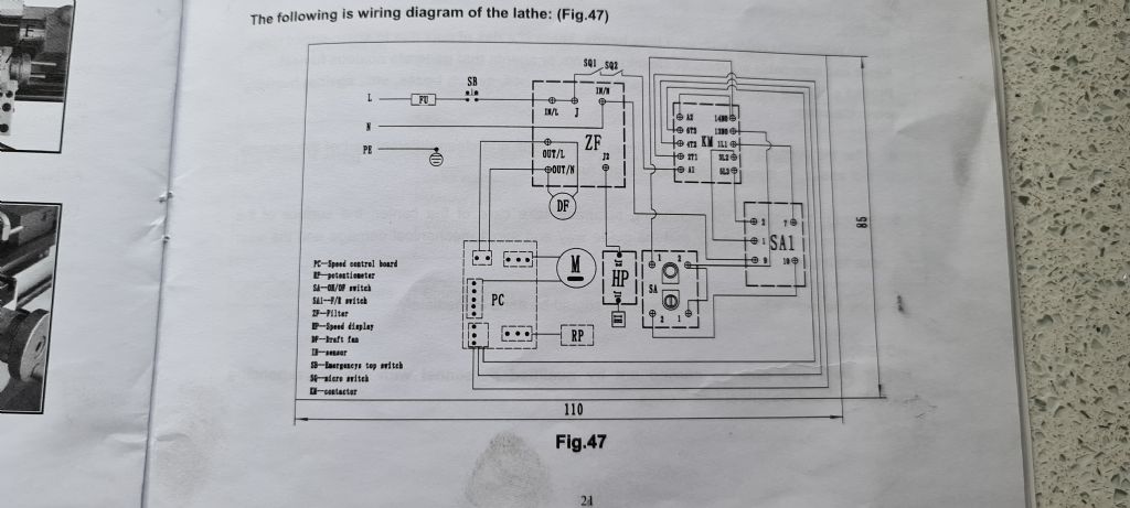

            A pic would be handy; there is a wiring diagram in the manual if you have it, if not I can scan & send you a copy.

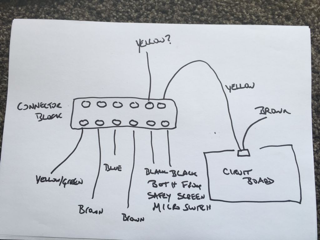

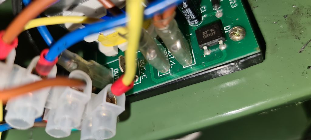

              re wire issue – see photos and diagram which may help
              > The white 6 block connector has 2 black wires which seem to come from the safety screen micro switch and connect to 2 yellow wires one of which goes to the circuit board and connects via a spade connector with a brown wire which seem to go to be connected to a spade connection saying out/L Which is beside a Connection which has a vacant connector which says out/E the second yellow wire has detached and I cannot see where it was connected to – Looked at wiring again and on the circuit board beside the empty Spade connection saying out/E there is a connector saying out/N which has a blue wire connected via a spade connector but it is very very loose and I believe the hanging yellow wire may connect here can anyone confirm the safety screen cutoff micro switch would be wired to the outL and the second wire to a out/Nimg_3846.jpg20200608_152612.jpg20200608_132409.jpg

                wiring diagram is apparently not for the brushless motor and hasnt been updated  – apparent in china they dont wire using colour codes !!!! i will post pic

                      That was my thought and how I found the first loose brown wire – unfortunately there are no obvious loose screws or empty holes lol – the only but is the blue wire going into the spade connection on the circuit lard marker outN when I pulled very gently on it it came out making me suspect the yellow wire was in this connection as well – considering all the other spade connectors have 2 wires makes this seem logical but I don’t want to risk connections the offending yellow wire and blow something- live in Northern Ireland so dont see warco coming to fix it even though it’s only 2 months old

                            Got sorted as I thought the yellow wire linked into the blue out/N – the scary thing is that it seems no two lathes may have the same wiring colours – when they checked a machine on the shop floor there were no yellow wires or white 6 block connector must admit I was concerned with the routing of the wires from the speed controller to the back of the machine passing under a turning part. Bring back good old British engineering
