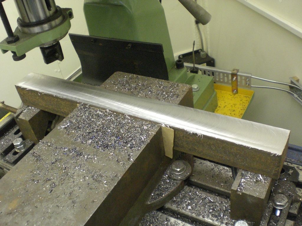

      Hello,
      has anyone had any experience with the war i major milking machine. Is it capable of cutting steel. Are there any better value alternatives?

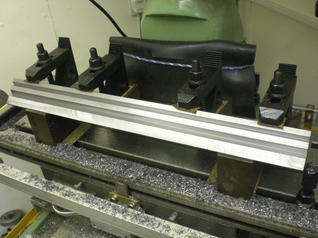

          Nicholas Farr
            @nicholasfarr14254
            Hi Harry, here's photographic evidence that my Warco Major cuts steel without any problems.
            Regards Nick.
