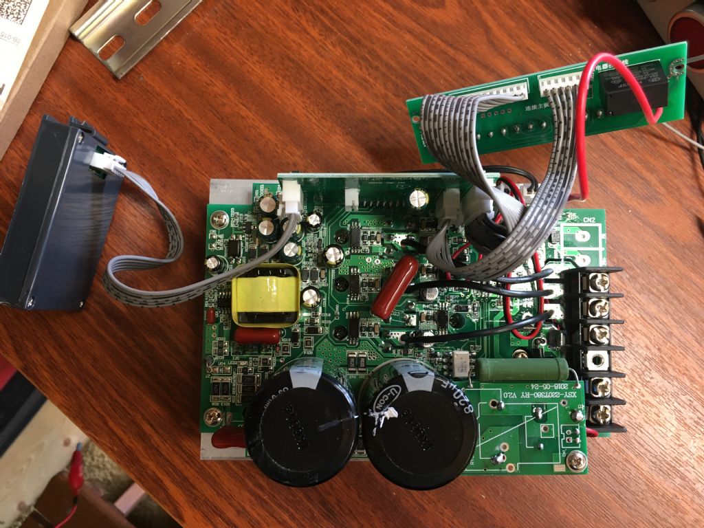

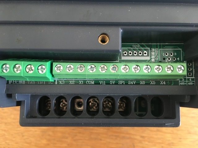

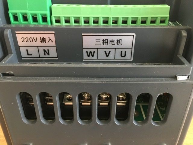

      I have a couple of 2.2Kw XSY AT4 which I want to use to power a couple of 380V 3 phase star wired motors using 220v single phase supply.
      I've bench run a 1/2hp motor successfully using the key panel for control but have run into a problem when trying to control speed using a 10K pot. For some reason I'm only able to obtain exactly half the max hz set in the vfd that I was able to achieve with the keyboard. I'm hoping someone will be able to advise why this might be the case and how I can get the full hz range using the Pot.
      Unlike the other ATs in the series the AT4
      1: has no earth terminal . I was planning to earth the cooling fins but measured 85v ac between the fins and supply earth. Is this to be expected? Should I earth it?
      2: has only 1 COM terminal on the control ports. The voltage between this COM and the 5v/10v terminal measures 5v Could this be causing the half max hz with the Pot?
      The manual that came with the vfds is the same AT series manual that other people have posted for the AT1 Thanks in anticipation.

            I wondered whether the two COM terminals on an AT1 are interconnected. The diagrams in the manual show the pot connected to one with all the other controls connected to the other one.

              Had a look at the Manual and it says the voltage is 5/10V. And then silence – very unhelpful! It implies to me the reference voltage can be either 5V or 10V, therefore I'd expect a physical switch or parameter setting allowing it to be changed. And it sort of follows that a pot connected to 5V when VC1 expects up to 10V will only be able to run the motor up to half speed.
              Disaster : can't see a parameter setting in the manual, or any sign of a 5V / 10V switch on the VFD. Might be worth looking inside the case to see if there's a tiny slider switch on the board. Sorry if teaching granny to suck eggs but disconnect from the mains first and take extreme care not to touch anything metal inside because those big capacitors can store enough energy to deliver a hefty shock.
              Should be possible to prove whether or not it's lack of 10V causing the problem by substituting a 9V battery for the 5V terminal. (Connect – to COM and + to top of pot.) Wind the motor up gently from 0V on VC1 : if it keeps speeding up when the pot goes past half way, it strongly suggests 10V is needed. If the motor doesn't go faster beyond the pot's half way setting, don't push on regardless up to 9V in case it damages the input electronics.

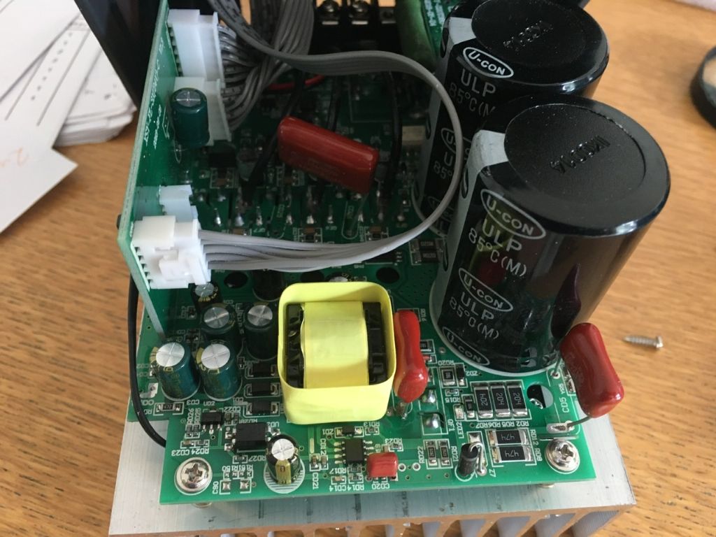

                    Posted by Andrew Firman on 23/05/2020 16:14:02:
                    As I have two of these I’ll check inside the one that has not been powered up. I’m not an electronics engineer so whether I’ll be able to identify what various components do is debatable.
                    Andrew F

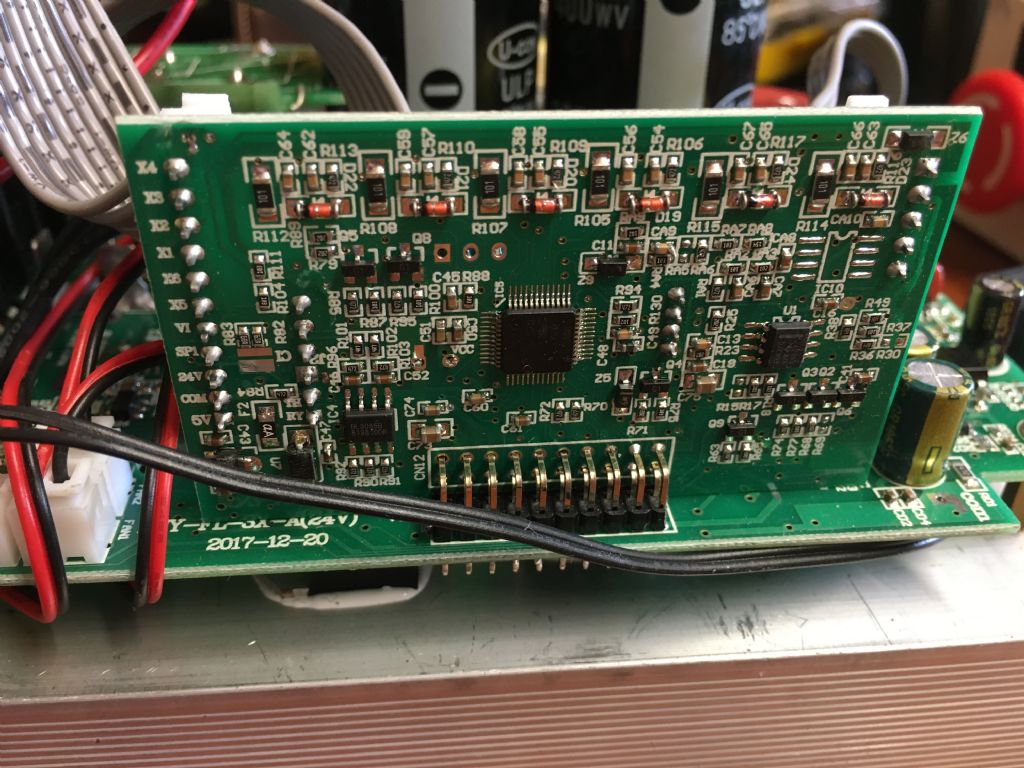

                    Can you post photos of the insides? If there's a switch or jumper should be visible, but it may be tiny. I don't understand the 5V/10V thing at all. I've read worse manuals, maybe some clot just left a paragraph out when it went to the printers!

                        #474322
                          Looked at the photos and can't see anything resembling a switch! Pity now you've confirmed 10V will fix the problem!
                          It seems perverse that the manual says wire the pot to a voltage source that can't allow full speed. Something is missing!
                          The control is more likely to be voltage than current, but it will need some current. I don't think changing the pot will make any difference because too high a resistance would cause trouble at the low speed end not the high. However the manual says 4.7kohms rather than 10k. No harm in trying it, and it may be necessary – see next!

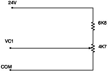

                          I think the answer is to drop the 24v terminal down to 10v with a resistor to give the pot more range. I'll do the sum and draw a circuit in another post. Watch this space!
                          #474331
                            This should do the trick. A 6.8k ohm resistor between 24V and a 4.7k ohm potentiometer should put 9.8V onto the pot, close enough for government work.
                            Can't help thinking this shouldn't be necessary, but it should work until an AT4 expert explains!
                            I recommend going down to a 4k7 pot because it should avoid the current / voltage problem you mentioned.

                                    On my AT4 version, after some head scratching, I found the earth was located on the outer left-most terminal of the of the left hand green block above the 220v power input on your picture above- it is marked PE in minute lettering obscured by the casing (WTF!….yeah I know! …. don't start.), but don't take my word for it, check to ensure there is connection to the cooling plate.

                                                The PE terminal is quite easy to see when the board is removed from the case. There is a red wire that connects the terminal and the main board and then through the brass board supports to the fins

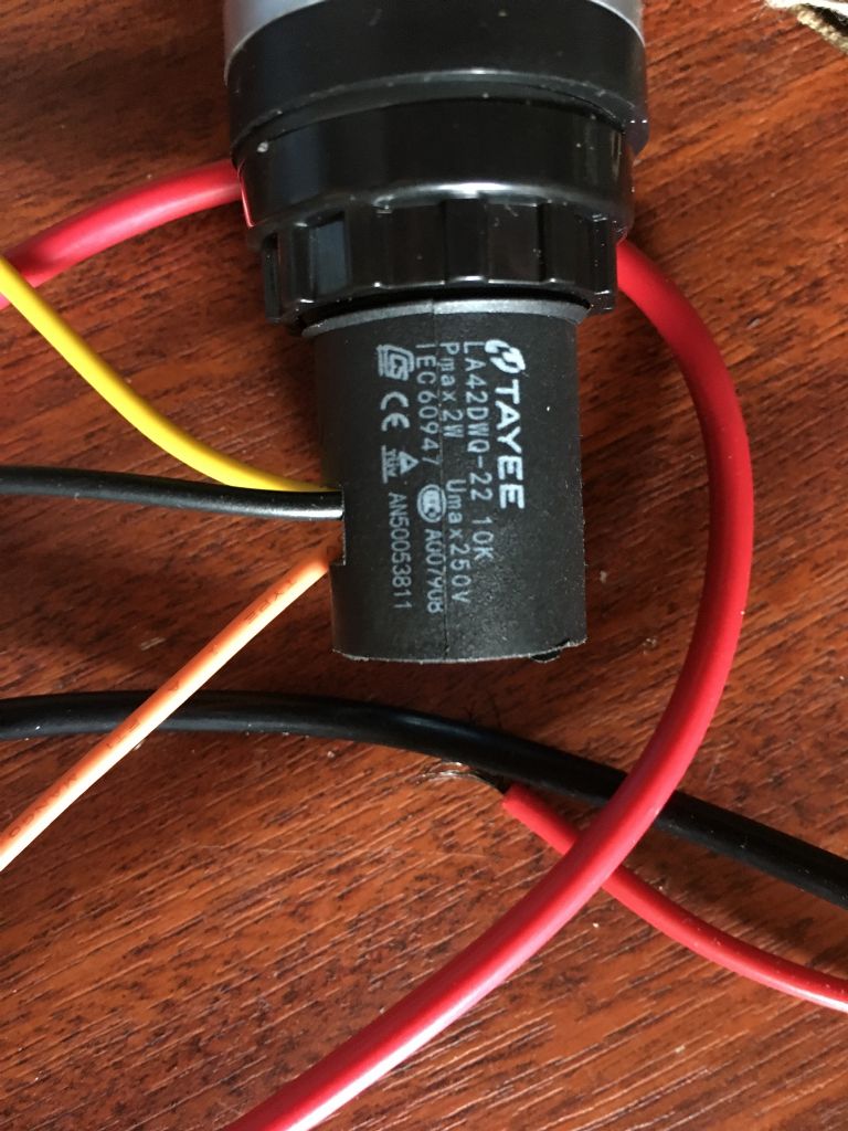

                                                The pot is new with a measured resistance of 10.7K . It seems ok but I don’t have any others to swap it with – awaiting a couple from China. I have set P10 and P11 to 2.
                                                I’ve checked the voltage between fins and a mains supply earth connected to the PE terminal and now get a reading of 3v ac down from 85v. Don’t know why it’s not zero but I guess one can live with 3v
                                                I’ve gone through all the “as supplied” parameters (including those not listed on the manual) on one vdf and once I’ve done it for the second one I’ll post a list listing all parameter settings “as supplied” .

                                                  The pot I’m using.

                                                      Don't get hung up on the value of the potentiometer!
                                                      It's used to divide a voltage, and, provided it doesn't draw too much current, almost any value will do.
                                                      The AT series 5V/10V output is specified to deliver up to 20mA. When a 10kΩ pot is used it draws 1mA. A 4.7kΩ pot draws 2.1mA The difference is trivial.
                                                      There are limits: the speed control input needs a certain amount of current to work, and a high-value pot might not provide enough. And a very low-value pot will draw too much current, possibly damaging itself or the power supply.
                                                      For this application I'd guess any pot between 1kΩ and 100kΩ will work, with 3.3 to 10kΩ being typical.
