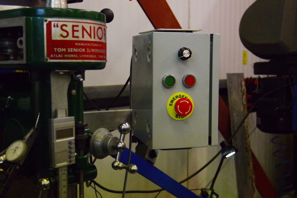

                                      #509304
                                      old mart
                                        @oldmart
                                        That photo of the controls for the TS mill shows the the VFD and switches inside a steel lockable electrical box. The plate visible on the top stands off about 3mm covering a ventilation hole. There is another hole at the bottom provided by the box manufacturer. The VFD frequency when running and "rdy" (ready) and "nst" (no start) LED's are visible through a perspex window cut on the door. All wiring except the mains in is shielded and the box has three plug and socket connections in the rear for the power supply, the motor and the remote emergency stop button.

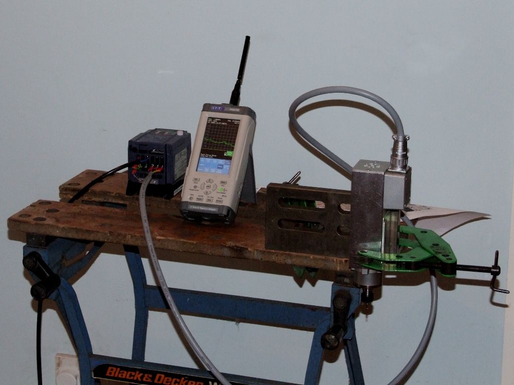

                                            #509357
                                            Anonymous
                                              There seems to be some confusion about the purpose of an input EMC filter. It is not there to reduce radiated emissions, but to reduce conducted emissions. So the fact that a radio works nearby is irrelevant. The filter should also protect the VFD from spikes and noise on the mains.
                                              The filter should prevent high frequency noise from the VFD reaching the mains. It should also help with harmonic currents. Simple diode/capacitor rectifiers draw current in short pulses, which has many harmonics. From the generators point of view this is bad. So there are regulations limiting the current harmonics caused by equipment. Larger and/or more expensive VFDs will have a power factor corrector (PFC) at the front end which causes current to be drawn in proportion to the voltage, ie, the current draw will be sinusoidal. In the absence of a PFC the input filter will reduce the current harmonics by passive means.
                                              I fitted a VFD to my CNC mill to drive the separate high speed spindle. Since the VFD didn't have an inbuilt PFC I fitted an external filter. The VFD and spindle were bought as a package from ARC. I've never had a problem with RCDs tripping.
                                              Connection of the shield for the motor connections is a controversial subject. Should the shield be grounded at both ends or just at the VFD? On the high speed spindle I grounded at the VFD end only. While running in the spindle bearings a check with a spectrum analyser didn't show any significant radiated emissions, at least above 1MHz:
