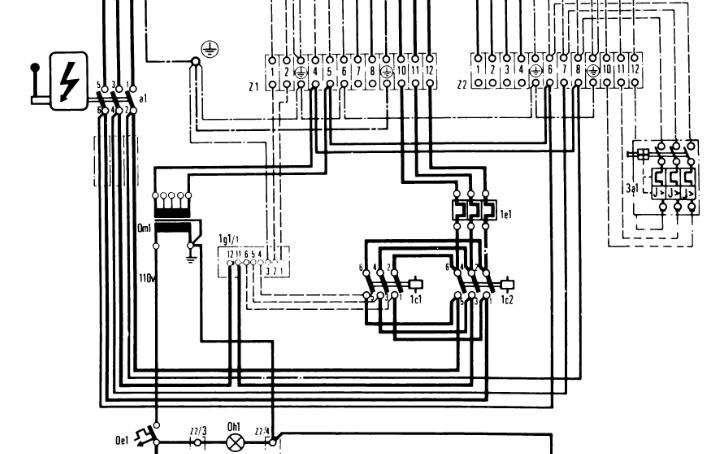

      Hi Guys,
      im running a harrison m300 on a rotary phase converter runs perfectly ok, but
      its pushing my electric bill extotionately high, so i thought about a digital converter
      to reduce the bills, would this be possible? motor is 415v 2.2kw star i would like to be able to use all std controls eg stop start and brake control also E stop.
      dont use suds pump, light is on seperate 12v supply..
      any help appreciated , thanks Garry.

                            The golden rule of VFDs is 'Do not switch the outputs!'. Doing so might generate a few thousand volts that write-off the electronics and the motor by puncturing the insulation. The existing Harrison switch probably swaps outputs, which is bad.
                            Instead, use the VFD's controls to control speed and direction; this is completely safe. The lathe's switch gear could be rewired to control the VFD, but it's generally easier to wire up the VFD to its own controls and leave the lathe alone. Much depends on how often the lathe's controls are used – not worth messing with the lathe's reverse switch if reverse is rarely used. It would be worth the effort if the lathe does a constant forward/reverse workflow.
                            Rotary converters are a good match to machines with complicated 3-phase electrics because they are bone-head insensitive! Unfortunately being dimwitted they are also inefficient. VFD's are much smarter, cheaper and efficient but also sensitive. They REALLY don't like driving more than one motor (lathes with coolant pumps etc), or having their outputs switched.
                            Older 3-phase machines were designed to plug into a permanent 3-phase supply, which doesn't care much when phases are switched, extra motors switched on and off, or the motor is a dual-speed type. Many of these machines are easy to VFD, others need more thought and work, perhaps replacing a coolant pump, cooling fans and the lighting with single-phase equivalents, rethinking the safety interlocks, going star to delta, and fixing a dual speed problem.
                            Be good to find someone who has already done a Harrison – they would know exactly how difficult the job is.
                            Whether machine is worth converting is a balance of the work involved against the energy saving plus other VFD advantages like speed control. My feeling is this is usually when something needs to be replaced, but I haven't seen Garry's electricity bill !!! I wouldn't be happy having a 2HP converter spinning all day every day.

                              I had look at this M300 manual and circuit http://vintagemachinery.org/pubs/detail.aspx?id=13849
                              It does not look too dificult to rewire. The controls (not shown on my snip below) run on 110V from transformer 0m1 and energises either contactor 1c1 (fwd) or 1c2 (rev).
                              The modification would be:
                              Cconnect single phase 240V to R and T.
                              Move primary tap on transformer 0m1 to 240V
                              Disconnect all wires from power contacts of 1c1 and 1c2, connect phases R & T from isolator 1a to VFD input and wires to motor to VFD output.
                              One power contact each from 1c1 and 1c2 in parallel to the run input of VFD, one contact from 1c2 to the reverse input of VFD. (common for these is of courses the low DC control voltage of the VFC.
                              Wired like that the lathe will operate as before. Of course to get full VFC benefits you would add a speed control and probably jog.
                              There is one issue, which is the E-Stop does not operate directly on the power input or E-stop input to the VFD. This can be fixed by connecting the VFD E-stop input to the unused 33/34 contact on control relay 0d1
                              Robert G8RPI.
