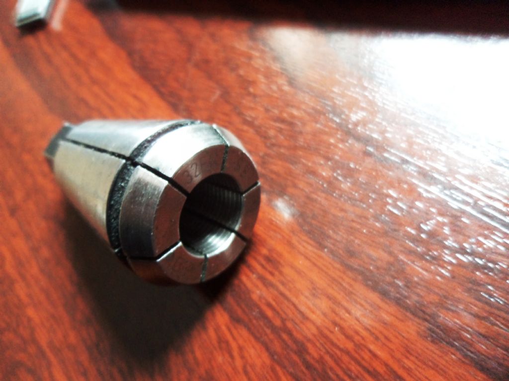

      I have been clearing out a friends workshop lately.
      I came across some unusual ER collets, and wondered if anyone knew what it might be for.
      They are ER32 series.

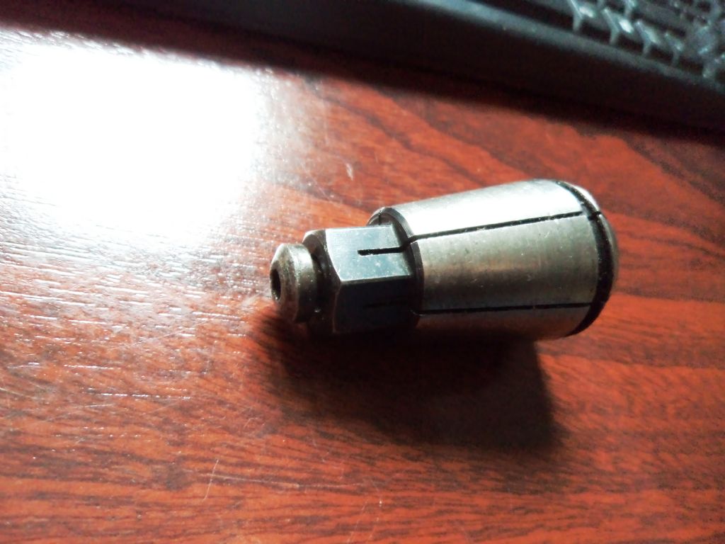

      They have only 6 "blades"
      The inside diameter is ringed all the way down
      It has a cap head bolt and longish nut on the bottom.
      Photos of the 16mm size.
      many thanks

        old mart
          @oldmart
          The rings in the bore are said to enhance the grip. The threaded end could be used to provide a depth stop, but due to the design, not 100% repeatable.

              I never would have guessed they were for holding a cutter with a threaded shank, very different from the common threaded shank cutters.

                Manofkent
                  @manofkent
                  Thanks for your replies.
                  The collet is marked "ER" and "SS", as well as the size.
                  I too had wondered if the cap head screw on the end was to set a dead length, but it has no lockout.
                    Likely belt and braces to stop any screwed end mills screwing/unscrewing further? Only two threads would be needed for that – the end mill and the screw.
                    Or perhaps the collet would not prevent plain-shank cutters from sliding in further under load and the screw may be sufficient to prevent this, even without a locknut as the collet nut will close slightly on tightening, pinching the screw?
                    As it is only good for one size of cutter, not too useful for work-holding (compared to a full/proper ER collet), I would suggest. For the cost of collets, they would likely be pensioned off if mine (but left in a drawer somewhere!).

                      Posted by Barrie Lever on 10/03/2020 15:05:09:
                      Schaubulin EFTX, the thread is to hold appropriate cutters. Not for depth stop.
                      Aside from the innocent typo, Barrie is evidently correct ^^^
                      See here: **LINK**
                      https://www.practicalmachinist.com/vb/deckel-maho-aciera-abene-mills/more-collet-tallk-time-schaublin-224230/

                            In my early days of using ER collets in my milling machine I did notice the milling cutter could slip into the collet holder sometimes, probably I hadn't got the collet properly tightened, but these collets could be a belt and braces approach.
                            As I said they fit my ER 32 holder, and I have a range of sizes so i will try them out next time i have some milling to do.
