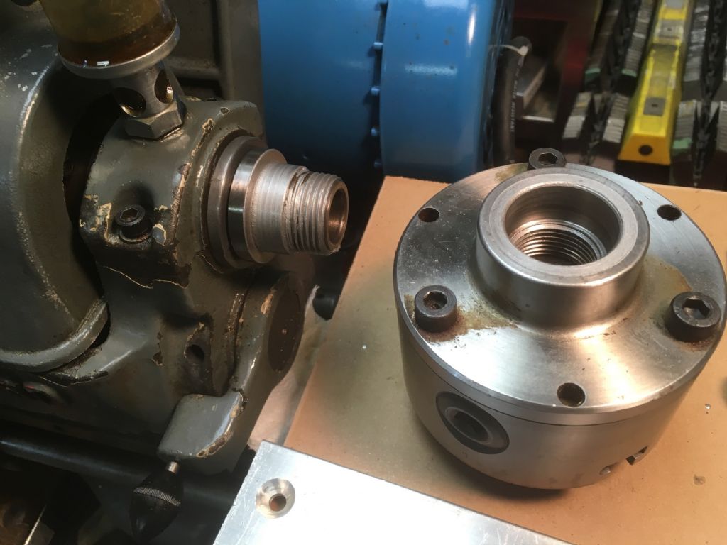

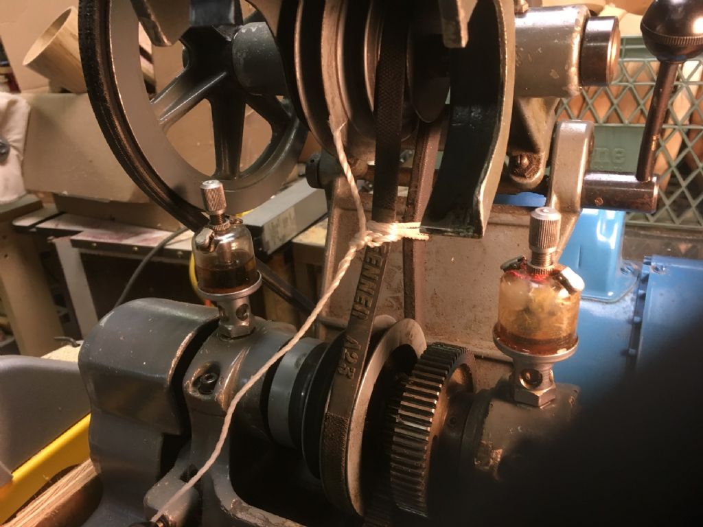

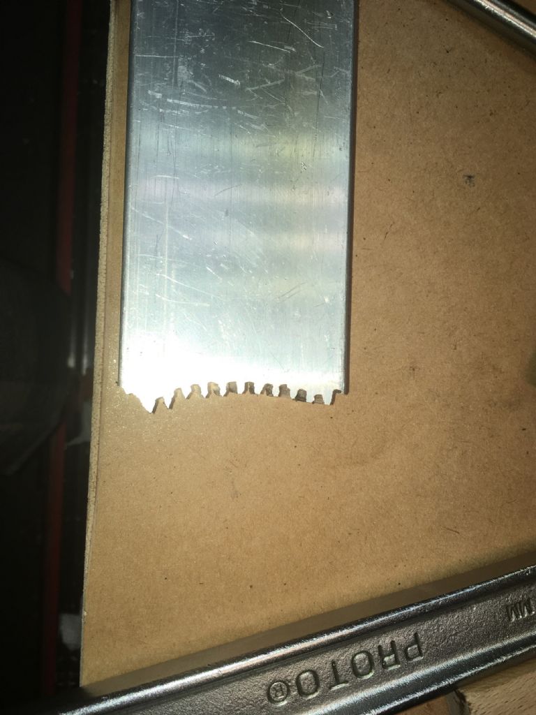

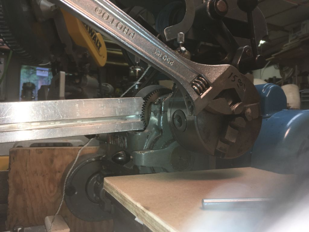

      This is the second time I have managed to get my 3 jaw chuck stuck on my ML7. The first time I was really new to this lathe and I just locked the back gears and tapped the key with a hammer and was VERY lucky I didn't break any gears. I am a little wiser now and didn't want to risk that maneuver again. I read and re-read all the information I could find on the net and tried everything I could find. I tried release oil, heat, clamps, strap clamps, an impact wrench and just about everything else I could discover. In the end I made an aluminum gear lock.
      1. I first loosened the belt tensioner most of the way and tied the belt front to back with some string. I did this just tight enough to allow me to push the tensioner back to sort of lock the shaft. I used the largest pull on the shaft to do this.img_4909.jpgNext i spent an hour with a 1/2" thick by about 3" wide piece of aluminum and cut mating teeth in it. I didn't do as good a job as a lot of you might have. I did make the mistake of first cutting a circle the diameter of the outside of my gear instead of the diameter of the inside of the teeth. This cause me to remake it.img_4913.jpgOnce I was happy with the fit, or at least mostly happy I proceeded to dress it into the large gear.img_4910.jpgWhile holding it with some force I put a crescent wrench on one of the jaws and tapped it with the palm of my hand.img_4912.jpgBecause of the good 'lock' of the shaft the chuck spun off the second time I hit it with my hand.img_4915.jpgAfter a very careful cleaning I now have a light coat of Never Seize on the threads and hopefully I will not have this issue again!
      #15965
      peter blair
        @peterblair72074
        How I did it

                  You were indeed lucky! Engaging back gear to lock the mandrel and then hitting the chuck is pretty surefire way to strip teeth off at least one gear!
                  I think that the standard advice is to tighten the belts, put a stout piece of wood across the chuck jaws (obviously fairly well open) and then to hit the end of the timber smartly with a mallet or hammer.
                  The theory is that the tight belts connect the mandrel to the inertia of the motor, and the suddenly applied load (which is supposed to be twice the value of a gradually applied load) should call for an accelertion which is so great that it breaks the bond between chuck and mandrel.
                  +1 for anti seize, but DO NOT then run in reverse. Starting up could well loosen the chuck!

                        As an long term owner of ML 7 I may advise following:
                        #1 Lock backgear, insert key into socket and tap the key using reasonable strenght, but with *bare hand*, not a mallet or hammer. This works in 90+% of cases and would not strip teeth of your gears because your hand is going to hurt badly well before you get there, unless you are training of karate or something similar – then be reasonable. If doesnt work, proceed to #2.
                        #2. There is an accessory for ML7, very useful for example for tapping, which is a handle which can be installed on journal from the back. It works by means of split pipe and a cone which expands pipe upon tightening screw. So install it on your lathe, disengage belts, etc. Mandrell must run freely. Now open jaws of youch chuck and on motor side stuff under one of these a wooden block, in such a way that jaw would hit this block and stop when mandrel is turned. Now, with an aid of your handle turn journal rapidly, so the jaw will hit wooden block. Try to gain some momentum. This nearly always helps, if not proceed to #3
                        #3 Leave wooden block like in #2 but drive jaw of chuck on it *under power, on slowest speed and on backgear (this speed is 35rpm). You must reverse direction of motor rotation. I have 3-phase motor, so it is easy, using 3 position switch, if you have 1 phase motor, which turns only one way, you may try to cross v-belt, one which drive countershaft (longer one would be needed around for this occassion). Didn't try trick with v-belt, it is just idea.
                        #3 never, ever failed.

                              I concur with Martin Dowing in a general sense.
                              Arrange for one of the wound out chuck jaws to contact a thick bar end or chuck of hardwood standing on the cross slide or rear shear if you must. You can add a pad of aluminium under it if you wish if you are using metal. Take a firm grip on the drive belt and smartly turn the spindle backwards so the jaw contacts the top end of the bar. This should release the chuck.
                              When reinstalling do make sure the threads and register are clean on the spindle and the chuck to avoid future lock ups.
                              regards Martin
