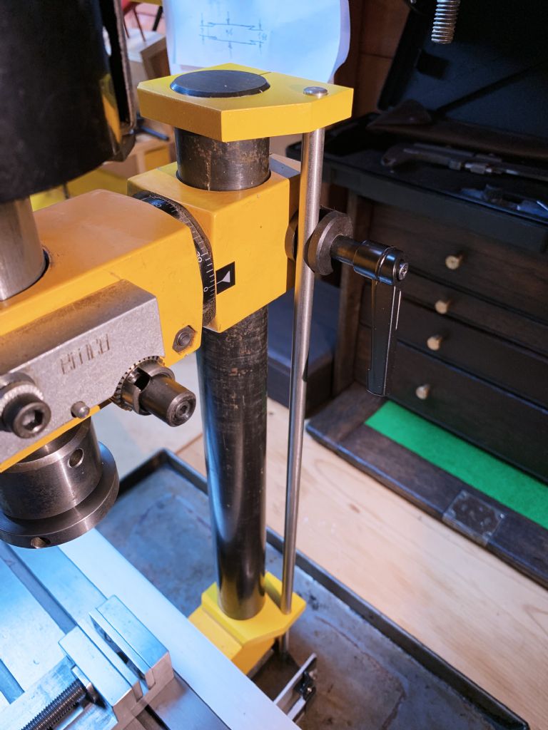

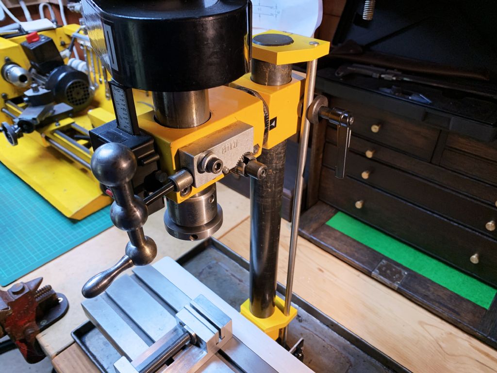

      Hello:

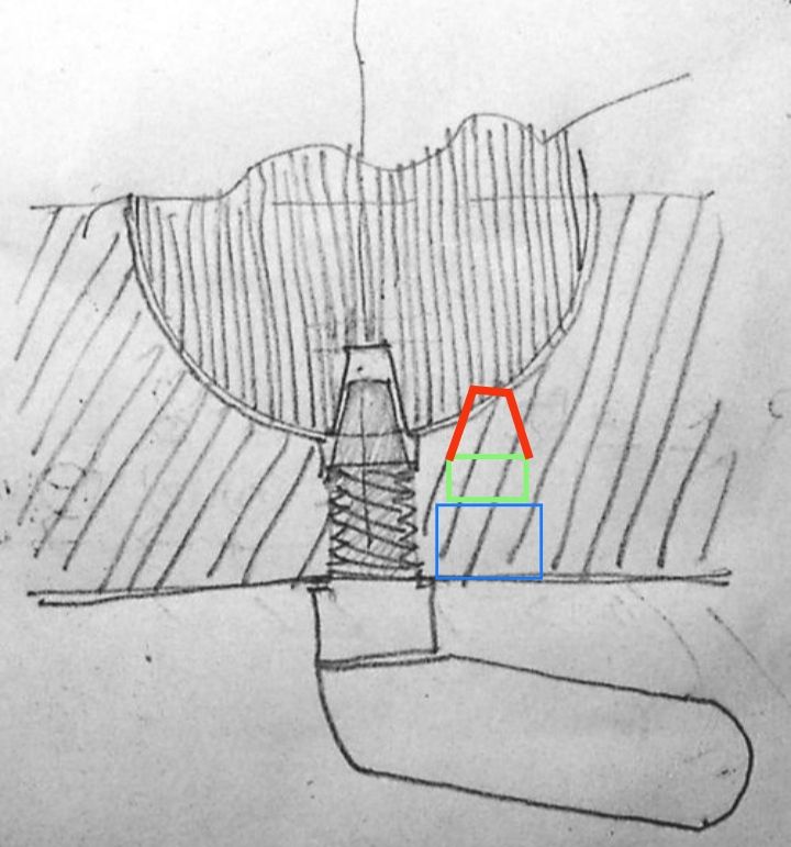

      In the process of finishing up work on my Unimat 3 milling table, I now have to address a major oversight in its original design.
      The column where the milling head runs up/down does not have a key and as a result, loosening the bolt to take the head up or down will always move the register it had, no matter how careful you are.
      I've seen a video of a chap who put the post on a mill, ground a 1/4" slot and maintained the register via a screw that threads into the head to fit in the slot, but it ended up having some play.
      It is a good idea, simple and straightforward but I think that a square bottom slot is not the right choice.

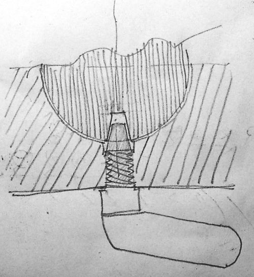

      I'm inclined to have a cone shaped slot ground into the side of the post and keep the register in place with a screw albeit with a shape to match the cone and just long enough so that it does not bottom out.
      Something like this *:
      I think that the cone shaped slot with the cone shaped bolt will do away with any possible play: the head will always be put back in the same position.
      To move the head up or down will then need two operations: first loosen the register bolt, the loosen the milling head bolt and then reversing the operation once the desired height is found.
      Not a problem and a solution to the head losing its position which is very annoying in a milling machine.
      Any suggestions?
      Thanks in advance.
      Best
      JHM
      * sorry for the sloppy sketch.

          The sloppy sketch is absolutely fine, JHM … it shows your thinking, concisely
          My only concern would be that, every time you clamp the assembly you will put a pair of grooves in the walls of the vee groove surprise
          I suggest you think about some way of incorporating a shim, to avoid such damage.

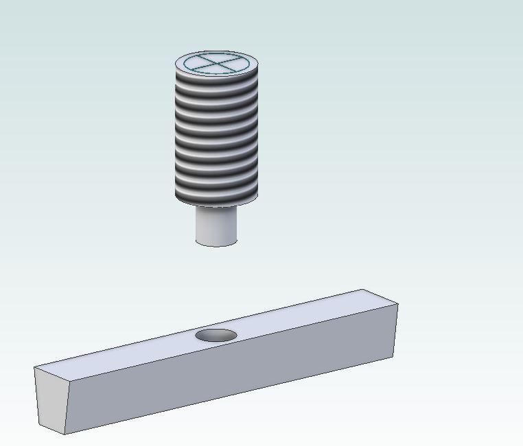

            Or a wedge shaped piece of metal about 30mm long with a hole in the wide side to take a parallel end turned onto the end of the screw
            Edited By JasonB on 13/11/2022 19:36:11

                  Using your current design, with a reverse shouldered bolt type screw, the shoulder being at the point end, and the screw being at the screwdriver end, then it fits in a reamed hole which has a larger diameter tapped part on the outside edge, does that make sense?
                  Might be a bit better than relying on the screw thread for positioning.

                    Indeed, that would most probably happen. Maybe not all the time but surely often enough.
                    I was rather relying on the physical properties of the steel used to manufacture the post vis-a-vis a brass screw (?) plus the fact that it would not really have to be tightened, just screwed in enough to touch the groove and register.
                    Like adjusting gibs on a lathe saddle.

                      Pete. touches on it above: both the ideas shown so far use a screw thread as part of the locating mechanism. That is not good engineering.
                      Any play between male and female threads with the tapered end to it will hamper repeatability. Even with the elongated piece of metal, side to side play in the threads will mean it will not repeat well.
                      There is also the issue of ensuring the tapered part or dog point is concentric with the male threads (or the male threads are concentric with the other feature – easier to achieve with a dog point than a tapered end as you can make the dog very long, grip that to cut the threads and then shorten it).

                            Posted by JasonB on 13/11/2022 19:30:58:
                            The taper angle would need to be rather steep to prevent the wedge becoming stuck in the taper slot and I don't think the unimat column could take that comfortably. Unless sound machining capabilities are available, small variations in slot width or taper will cause the wedge to bind as you wind the head up and down. Average machining will do as long as the slot is truly inline with the column, then a brass tapered tip lock-screw will do just fine – it's a small machine.

                              Pete.
                                @pete-2
                                You'll have to excuse my poor image, hopefully this helps you understand what I was trying to explain.
                                The blue part is the thread, the green part is an accurately turned diameter that would locate in a reamed hole, as long as the red taper and green location diameter are turned in the same set up it should give pretty repeatable location.
                                I'm sure there are better solutions but this is almost identical to your original Idea and a pretty simple solution.
                                Edited By Pete. on 13/11/2022 22:46:20

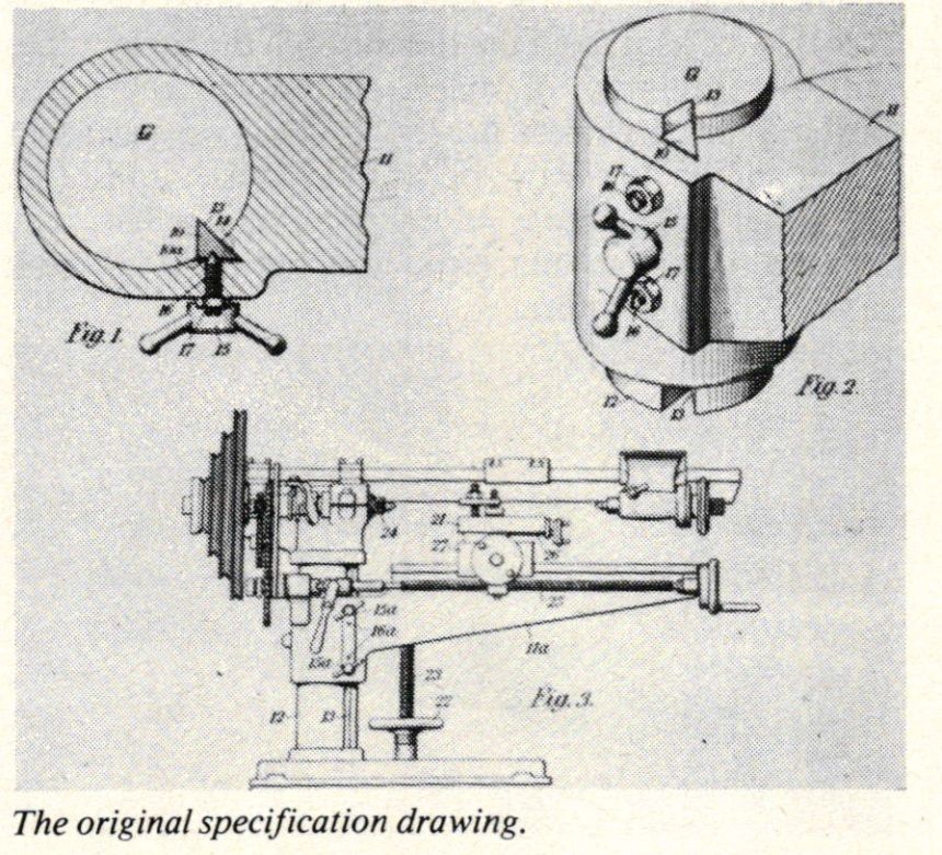

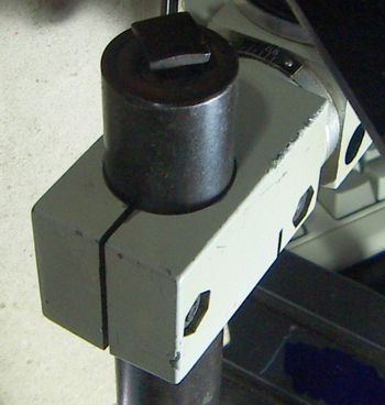

                                  One of the most elegant solutions was Mr Urwicks triangular key used on the metalmaster universal machine. Read about it Here on the lathes page.
                                  Mike
                                  Just noticed DC31k mentioned the Urwick Metalmaster key earlier. I must read more carefully.
                                  Edited By Mike Poole on 14/11/2022 08:44:59

                                        Yes, now I get what you meant.
                                        > … a pretty simple solution.
                                        Indeed it is and very doable, so to speak.

                                        The diameter of the column, the small amount of material to thread into and the simplicity of the solution has me thinking that Pete and Joseph have made a point so I think I'll go with that.
                                        The cone shaped slot to be made on the column is common to all the solutions which may boil down to how the spindle head gets its register rather than how it gets gripped, which is a function of the screw on the other side.
                                        I was thinking that I will probably need to pressure fit a short external brass tube to accomodate the threads and the reamed hole and have the aluminium casting take that part and nothing else.
                                        Eventually (if needed) the part could be modified/replaced with little effort.

                                          I've often thought about putting an Urwick style triangular gibb on my Unimat column, but since I now have a larger mill drill with a dove tail column it is not so likely to happen.
                                          #621015

                                            I also ran into this on the ME site
                                            plus the original patent
                                            Edited By Ady1 on 14/11/2022 10:09:55
