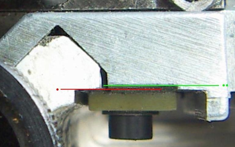

      I then checked to see what was going on with the lift strips.
      Moving / lifting the carriage enabled me to visually confirm that the problem was exactly the same as the one described by Kiwi Bloke in his post: the properly tightened lift strips were not making proper contact with the guides under the ways.
      But here's the thing: before deciding to purchase the U3 and then after taking it apart for the first time, I spent countless hours scouring the web for anything related to drawbacks, problems, fixes, workarounds, useful modifications, etc. and while I cannot possibly claim to have read everything out there, I can confidently say that I never came across any reference to the problem Kiwi Bloke posted about.
      Maybe it got lost when some user group shut down or the hosting service went down, no way to know now, but here it is.
      For that very reason I was dead set on documenting the work on the lift plates' mounting surfaces but my digital camera decided not to help by ignoring the SD card inside the slot and insisting there was nothing there.
      But I digress.
      Once I had a clear idea of the (very) slight amount of material that had to be removed, I decided to use an old and worn down 6"x5/8" flat file to remove the excess material, a tiny little bit each time.

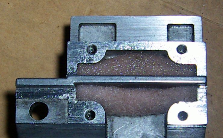

      Here is a photo showing what Kiwi Bloke wrote about:
      The red line coincides with the surface underneath the front way where the lift strip has to tightened against and the green line coincides with the surface to which the lift strip is tightened.
      Due to a bad photograph, a shaky hand/mouse using mouse/MSPaint and a number of optical effects I cannot recall how to explain, the difference observed between the lines is really much less that what it appears to be.
      But it boils down to this:
      If both lines are at the same level, the lift strip will not touch the surface underneath the way and the carriage will move upwards, so the green line has to be above the red line.
      The same thing obviously applies to both lift strips.
      After a countless number of iterations ie: filing the surfaces, mounting the carriage, tightening the lift strips, checking the carriage movement and then unmounting it again to file off some more material, the stars finally started to line up.
      And the problem seems to have been fixed. Although promising, the jury is still deliberating.

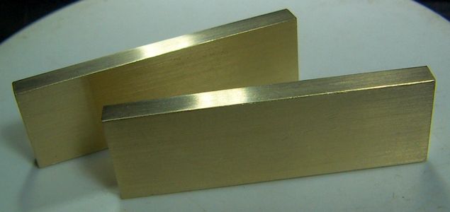

      As I will be replacing the ca. 1980 OEM lift strips with a new set made from 5/8"x5/32" brass, there will be photos to show what was done along with a description on how it was done to be kept here at ME for other U3 owners looking for a solution.

        #648778
          Julius
          Whilst fully accepting the difficulty of photographing this arrangement … I find your image rather worrying: It appears that there is a gap on the right-hand [as viewed] slope of the prismatic bearing surface !
          Grateful if you could confirm that this is a mere illusion.
          … if it was real, you would have a lot of work to do !

            I wondered about that too. But assumed it was a trick of the light. If not, then yes, something definitely to be addressed.

                Hello:
                Posted by Michael Gilligan on 17/06/2023 08:01:28:
                … appears that there is a gap …
                Posted by Hopper on 17/06/2023 09:20:35:
                … assumed it was a trick of the light.
                Quite so …
                There does appear to be a gap and just as worried as you, rushed to look at the carrier again to check.
                But no, it is indeed a trick of sorts.
                First, there was (not any more) a very slight burr casting a shadow, in turn made to look worse by having magnified the original image to try to get more detail of the problem at hand.
                And then there is what seems to be a very slight deformation of the aluminium casting, most probably produced while machining the underside of the carrier.
                So, fortunately there is no gap, at least not one that I can detect or measure at the moment.
                Thanks for mentioning it.

                  Thanks for checking … I am relieved, but probably not as much as you are !!

                    I've already made the new set, just need drilling and finishing but I will keep both your advise and the OEM strips. Worst case scenario, I'll can always go back to the plastic ones.
                    As the brass stock I purchased is 5/8" (15.9mm), I have kept the new strips at that width so as to avoid having to machine them down to 13mm and also a bit longer, 49mm instead of 47mm.
                    This new size comes in handy as the slightly larger surface will cover a good part of those cost-cutting voids between the strips and the carrier body (swarf does find its way in there!) and help with an experiment I want to run by placing small pads of SAE10 oil soaked felt in them, hopefully helping with the strips' lubrication and denying the swarf a place to reside in.

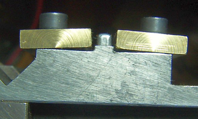

                                Posted by Julius Henry Marx on 17/06/2023 13:54:37:
                                … already made the new set, just need drilling and finishing …

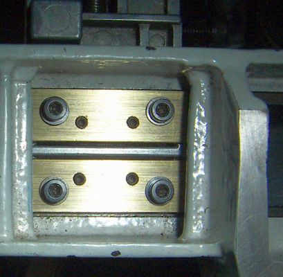

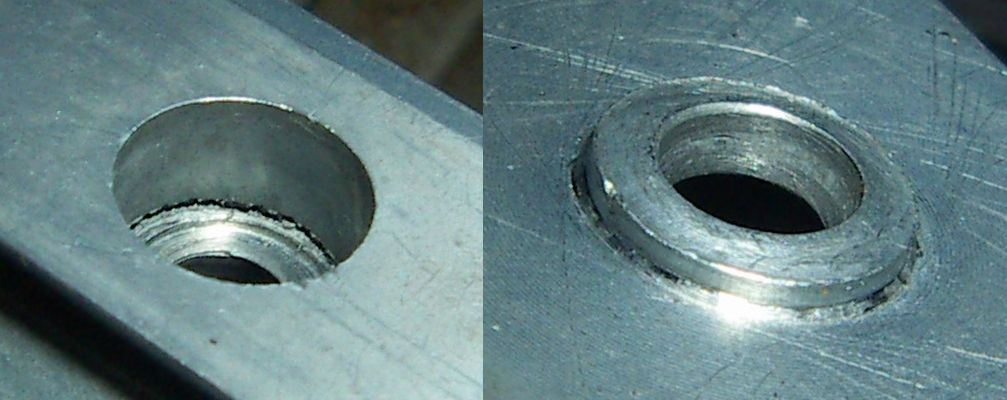

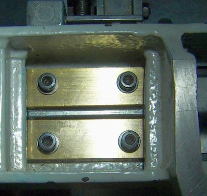

                                Decided to start with the finishing, made more sense and expect it will make marking/drilling with precision a bit easier.
                                The surfaces shown in the photograph are the only ones with a finish. With my milling table not being operational yet, the narrow side and the ends of the strips were squared off on the U3 and the wide side finished by hand with sandpaper on a glass plate.
                                Since I do not intend to make them double sided or interchangeable, the other two surfaces will stay as they came from the purveyor.

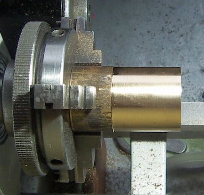

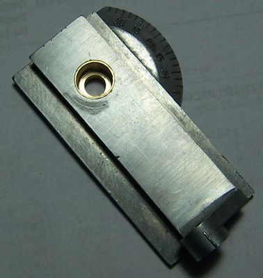

                                          @Dave, @Michael, @Hopper:
                                          As an architect by trade and amateur photographer for quite a few years, one of my favourite phrases/quotes has always been "a picture is worth a thousand words", said to be attributed to an advertising executive in the first decades of the 20th. century.
                                          To wit: the photos I am posting below belong to the "taper turning" or "top slide" accessory (part #150 190) that came with my Unimat 3, a part that a firm by the name of Blue Ridge Machinery and Tools at some point had on their Unimat 3 parts catalogue for a cool US$49.00 and these days can command silly money prices. (~ £80/100).
                                          The attachment's base was probably manufactured with the same material as the cross slide and the result of that can be clearly seen in the photograph below:

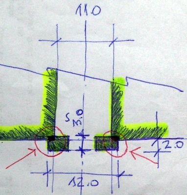

                                          If that were not enough, while taking measurements prior to attempting to repair the damage, I discovered that the cylindrical protusion than moves/pivots inside the recess in the cross slide has very little material in common with the base itself and was most probably a tad short.
                                          Here is the sketch I made at the time:
                                          As you can see, there is very little material at work to take the stress, something closely resembling a 11.0 x 12.0  x 1.0 mm washer made from Zamak.
                                          How do you say "salt to the wound" in German? 8^°
                                          Fortunately, I eventually managed to figure out a way to repair it with a piece of brass rod, the end result being this:
                                          I have not had a chance to use it as yet, but I expect that once I make a new set of gibs for it, it will work as intended.
                                          I expect these photographs serve as a definite/suitable example of Mazak/Zamak used to manufacture the wrong part, in the wrong place for the wrong reasons.
                                          My thanks you all of you for your input.

                                                Significant progess has been made albeit not without some annoyances, the net result being what seems to be a suitable outcome, at least for now. Time will tell.
                                                I will most probably have to make some adjustments on the surfaces where the lift strips are mounted once they settle in with use for (as expected) the ways in this ca. 1980 U3 have some wear and the carriage gets stiffer as it moves near the headstock and tailsock but not too much.
                                                As mentioned previously, an oil soaked felt pad was placed under each strip:
                                                It is an experiment to see if, apart from keeping swarf out, will also aid in keeping the carriage running smoothly. An old but proven idea, looks like it will work as expected.
                                                Here is what the final product looks like:
                                                The length of the strips cover the whole length of the mounting surface which is 49 mm and their width is roughly the same as that of the brass stock my purveyor had on special offer at the time, 5/8".
                                                Once I had everything in place, I took to cleaning up a short piece of ⌀ 25mm SAE64 bronze which I will use to make a bushing, with this result:
                                                Granted, it is only 25mm worth of clean-up but I was very happy to see that my micrometer informed me that it is perfectly cylindrical, something I was absolutely unable to achieve a week ago.
                                                It surprised me to see how much material had to be removed to get the strips to touch the ways as needed. I intended to measure it but was too concentrated in what I was doing and totally forgot.
                                                If I had to guess, I'd think something like 0.02/0.03mm, at least.
                                                As a side note, I would mention that while I was looking for a solution to the problem I was having with the U3 carriage, I recalled that that the Sieg C0/Grizzly G0745 were close clones/copies of the Unimat 3 and decided to look to what was available in terms of spare parts and if their lift strips would work on the U3.
                                                The (steel?) replacement gibs these Sieg manufactured lathes use are held in place in the same manner as the Unimat (a pair of 6mm M4x0.7 screws) but each gib has an additional pair of threaded holes to hold set screws used to regulate the distance of the lift strips to the ways and keep them from being overtightened.
                                                An interesting solution to this problem but probably not applicable to the Unimat 3 carriage: I think (?) the carriage used in the Sieg C0 is 1. made from steel and 2. does not have any voids so the set screws have a spot to lift land on.

                                                  Here it is:
                                                  Each strip has acquired two 12mm M4x0.70 set screws, but unlike the Sieg C0 strips, the screws are not aligned with the screws holding the strips in place but offset so as to do this when adjusted:
                                                  The screws holding the strips are not tightened and the set screws cause the strips rock towards the ways.
                                                  It goes without saying that the amount of tilt shown in the photograph has been greatly exaggerated in order to show what happens when the strips are being adjusted. The strips do not load on the ways, they hover just above them on a film of oil so I expect that they will last a long time.
                                                  I finished the job a while ago and can say that it works really well: the slide (tested without lead screw fitted) goes from end to end very smoothly, with no jamming whatsoever and no discernible upwards movement at any point in its travel.
                                                  Of course, it has to be tested and used for a good while to see the actual results but (for now) it is looking good.
                                                  Once again, thank you so much for the explanation on how the strips work. Learned something today.

                                                      Interesting approach. No doubt your approach will work fine. Whether it will continue to do so as it wears remains to be seen. Realistically, it isn't going to wear much is it?
                                                      However, a few things to consider:
                                                      1. Tilting the strips will tend to cause line contact, which will be associated with greater wear. Don't forget that a softer material can wear a harder one if it gets embedded with abrasive – as in a lap. These strips need to be 'sacrificial'.
                                                      2. You could use Belville washers (or other spring washers) under the retaining screw heads to achieve preload. (IIRC, Emco use wavy spring washers).
                                                      3. The strips will certainly not float on a film of oil (hydrodynamic bearing), unless you make the gap large enough (and the saddle whizzes along) – and we don't want a gap, for obvious reasons. At the low speed a saddle will travel, and the loading necessary to pull the saddle down, even boundary lubrication is optimistic. There will be metal-to-metal contact.
                                                      4. Don't lose sleep over it. "She'll be right", as they say here in NZ.
