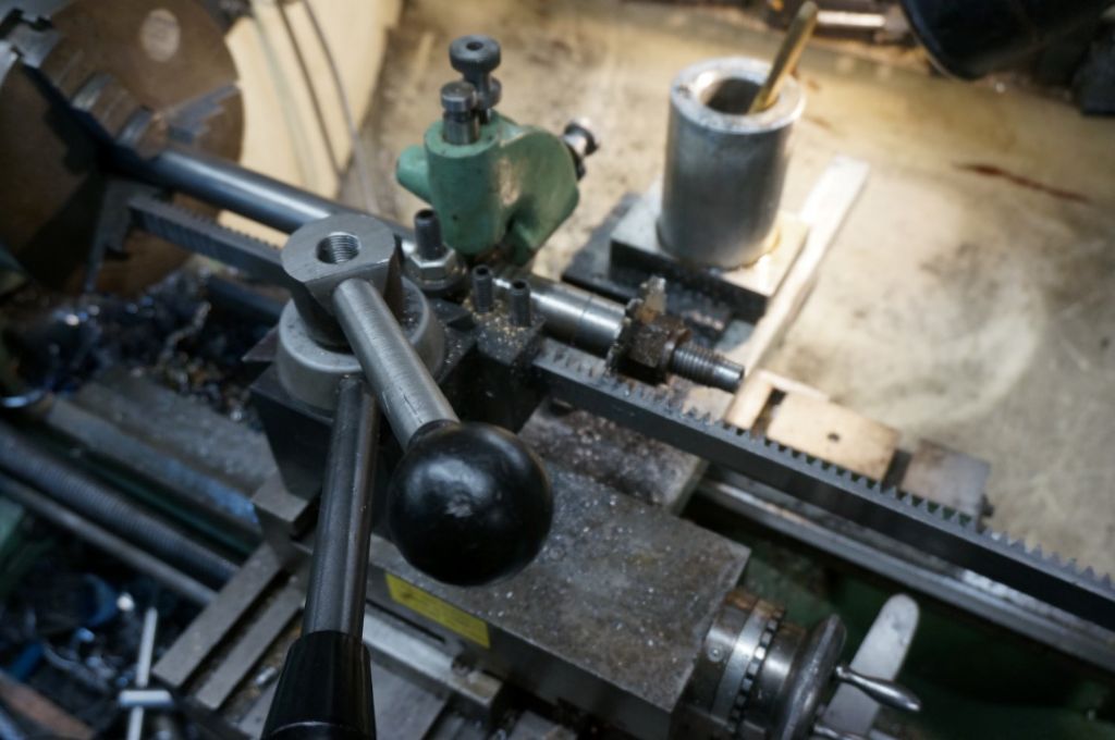

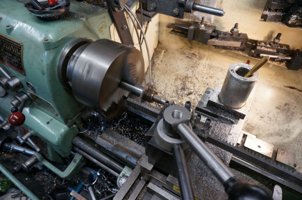

Made an arbour out of 1" ms and mounted that in the lathe mounted my precut blank in the toolpost and gingerley fed into the cut….perfect 2 different heights on the toolpost and job done in 2 hours doing 5 teeth at a time before moving the blank in the toolpost
Cutter was spinning at 210 revs…
2nd Q is that about right for a gear cutter 3" diameter hss cutting MS?
This was as I progressed so I had the moving steady supporting the arbour
turned the blank around and changed set up for the ends

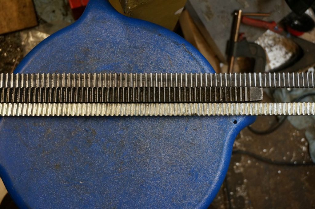

this the finished rack and the original which is only 10 "long and a sealey one I bought which worked fine but didnt look too good

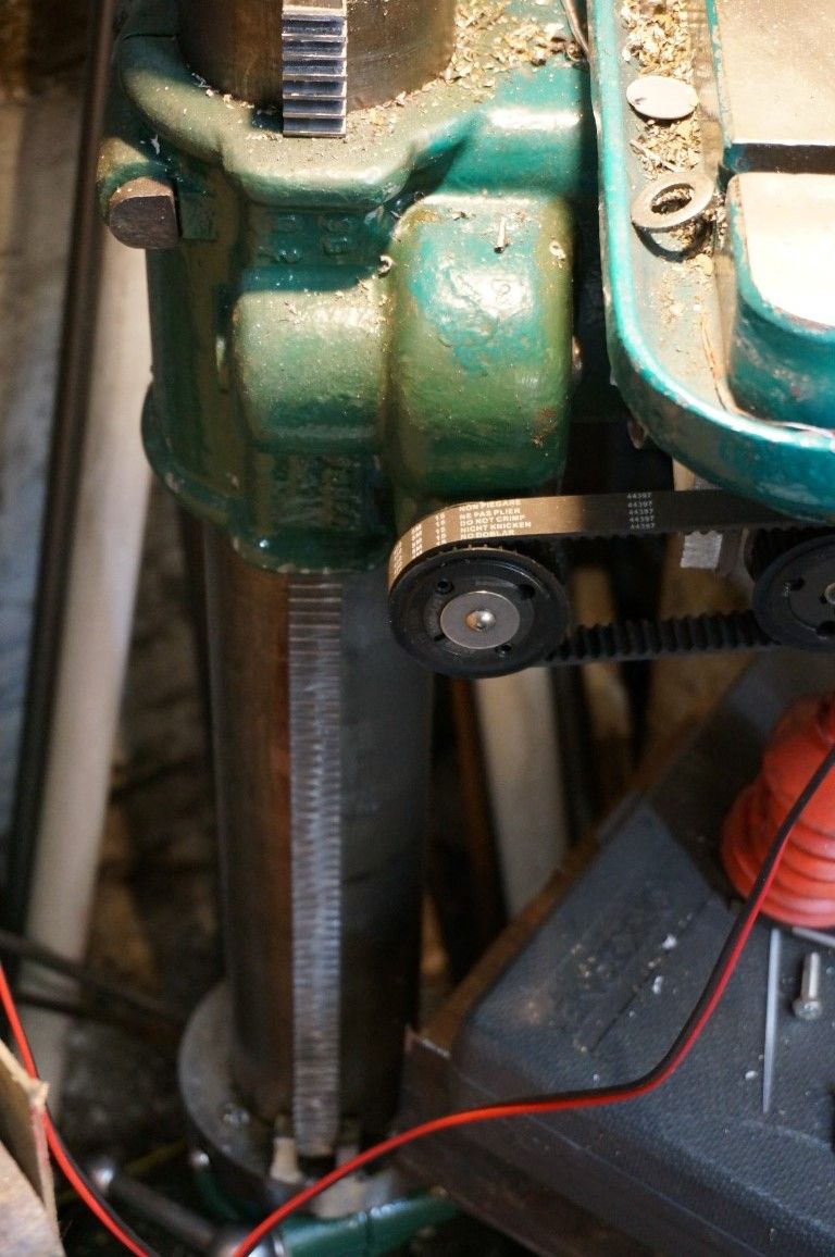

And this is it installed in the machine
I've motorised the bed…absolute luxury
switch gear mounted in a moveable box if it gets in the way it can move
