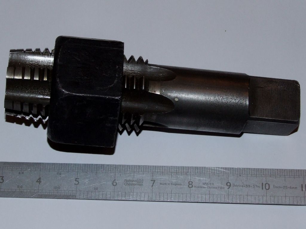

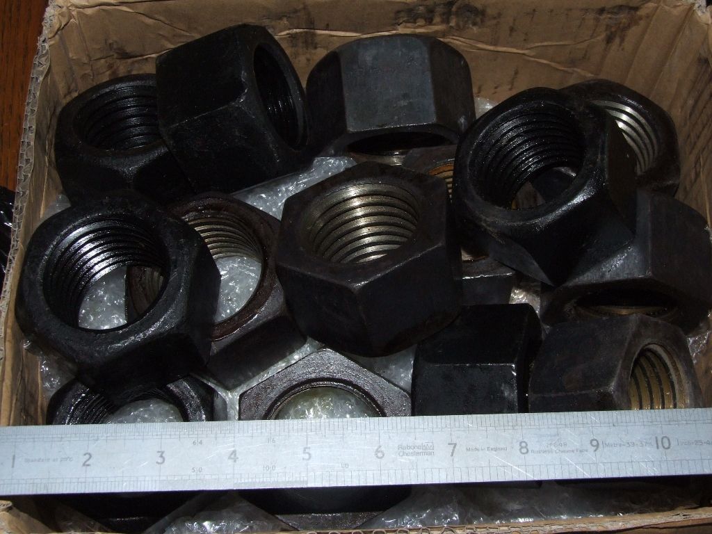

                                          Woohoo, the nuts arrived today. I was hopeful about size as the delivery driver wasn't exactly skipping up the drive. At first glance they look like the right size. I'm collecting the £22 secondhand tap bought on Ebay at the weekend, so that will give the definitive answer to the are they the right size question. The nuts are a bit rough, but what do you expect for £4 each, and they're going to be machined. welded and hacked about anyway:

                                              I picked up a 2" UNC tap, bought secondhand on Ebay, over the weekend. Even better the nuts fit. thumbs up
                                              Just need a suitable tap wrench now, although I'm not sure there'd be room in the workshop to swing it.

                                                That should be handy to correct any distortion you may get after welding, as for a wrench a couple of 6ft lengths of 40mm bar should do the job, just make sure your vice and bench are fixed down wellblush

                                                  Perhaps hold the square end of tap in the vice with packing and spanner the nut.

                                                    Posted by Andrew Johnston on 07/08/2016 20:46:01:
                                                    Just need a suitable tap wrench now …
                                                    What size A/F is the square, Andrew ?

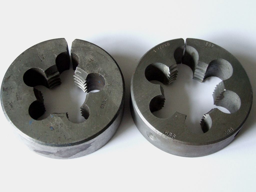

                                                      Hi Andrew, do you have a stock for your 3" diameter die's?
                                                      **LINK**
                                                      If you do, you could cut a square hole in a steel blank and maybe use that.
