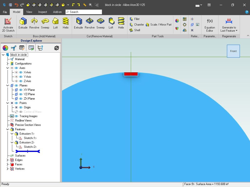

                              Ady1
                                @ady1
                                Aha!
                                #659163

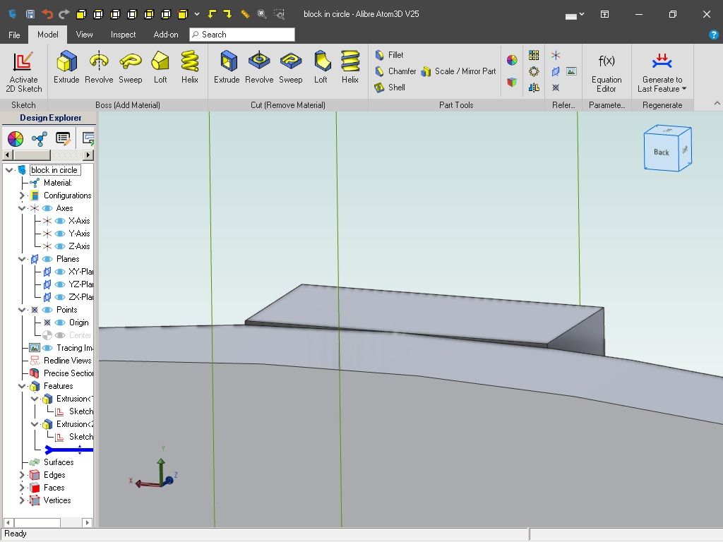

                                Ady1
                                  @ady1
                                  The amount needing removed is pretty minute
                                  One square is 0.05" (1.27mm)
                                  Edited By Ady1 on 05/09/2023 09:59:24

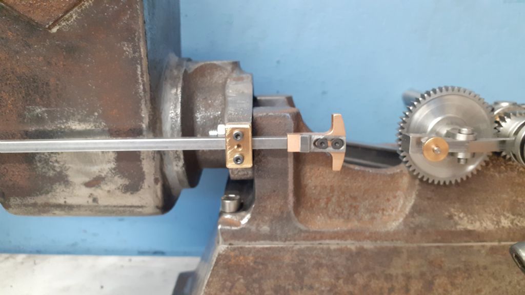

                                      One I made earlier
                                      As I said earler clamp/screw your bit of metal to a longer piece that has a pivot hole, provide a pivot which will be approx 500mm from the cutting tool then sanding disc held in the lathe chuck. Simples.

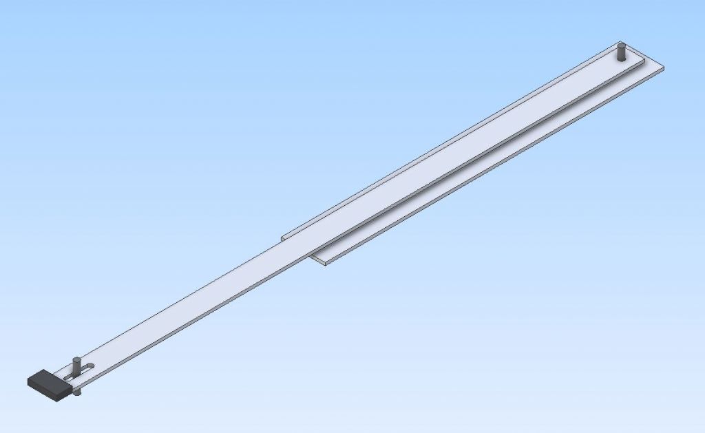

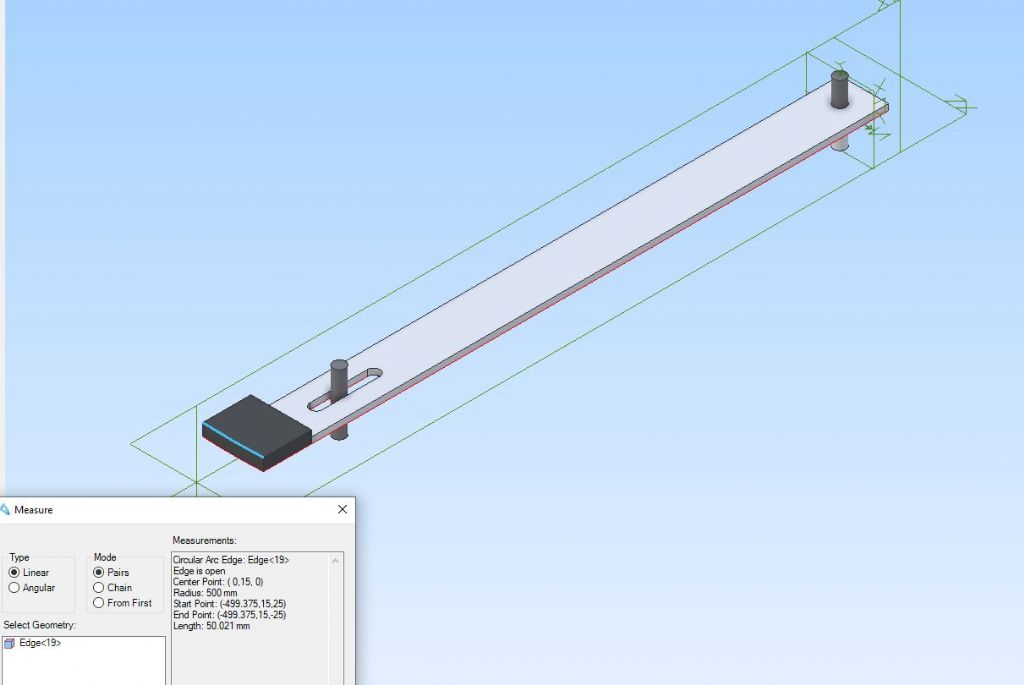

                                          Here you go.
                                          Pivot at far end will need to be something clamped to the bed.
                                          If you put a slot towards the other end to take a pin fitted to a cross slide tee nut then winding the cross slide in and out will move the workpiece on the end of the bar in an arc.
                                          Could also be arranged vertically with the pin that goes into the slot mounted on a vertical slide and the pivot 500mm out to the front of the Myford anyone who has read the Minnie book will know the method as it is the same for the expansion link machining.
                                          PS Younger guys will give an answer before 7.00am
                                          Edited By JasonB on 05/09/2023 10:15:29

                                                      39" makes no real difference to the method I showed, might just need to extend the pivot point out beyond the R?H end of the lathe but that is simple enough.
                                                      All the curves on this bench I made were done in a similar sort of way and radiate out from a single point, from memory the top of the rear rail is 6.5m radius
