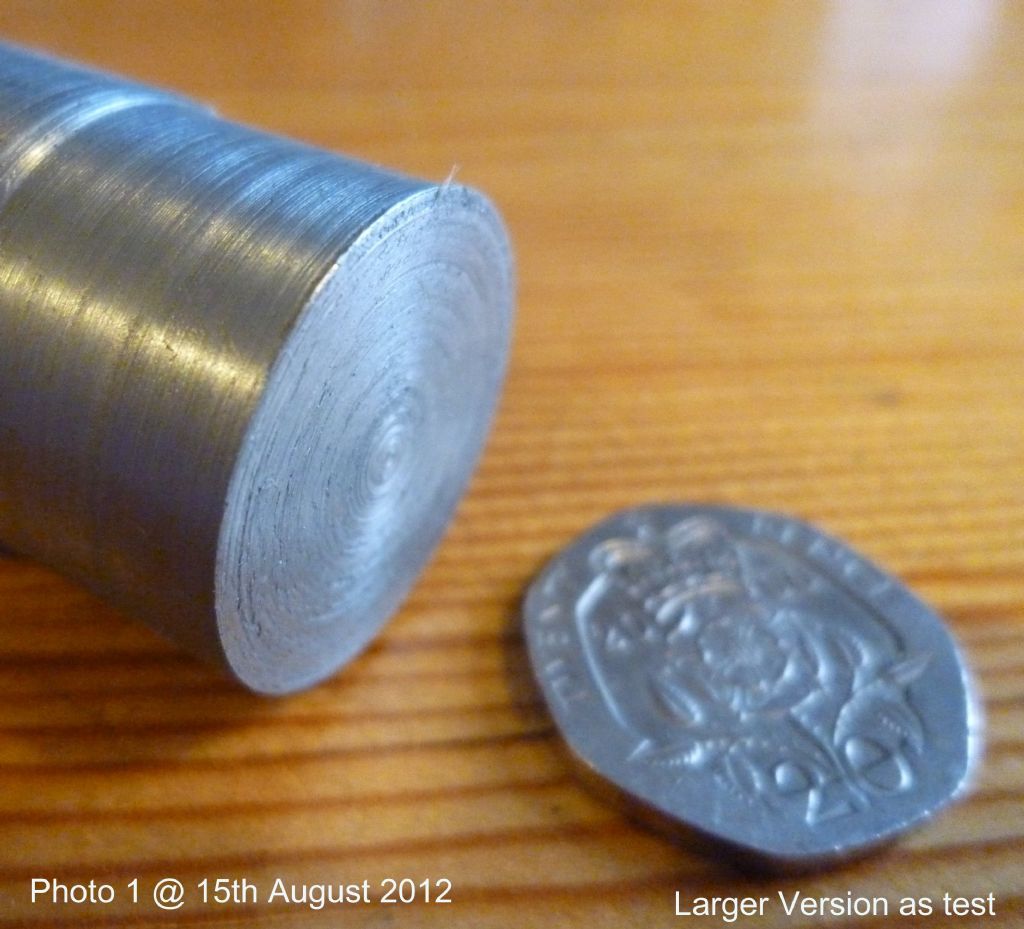

      I have a Harrison lathe which has defintely got a bus pass and probably a free TV licence too
      No matter how carefully I turn things it looks like rats have been gnawing at it. As far as I can see there are 3 possible explanations
      1. I don't know what I am doing
      2. The tools are blunt
      3. The lathe is knackered
      Or all three
      Any suggestions as to the best way forward?

          The age shouldn't be a problem I started with a lathe about 100 years old. If it's knackered you can fix it/get round it.
          Your numbered points:
          1. Fixed by asking here.
          2. Try rubbing the cutting edge across the back of your fingernail. If it won't produce fine shavings sharpen it.
          3. Make sure there isn't any play in the headstock bearings they should be tight enough so that without the drive connected if you spin the chuck by hand it won't do more than one or two revolutions before stopping. Make sure the gibs are tight enough. Is there any possibility of the tool movine in the toolpost or vibrating? Keep the tool tip as close to the toolpost as you can. Does the lathe vibrate much when in drive?
          Hope that gives you something to look at as a start.
          Russell.

            Posted by Russell Eberhardt on 15/08/2012 16:31:22:
            OK
            Pased that test
            Feels OK on that test too
            Er … waht are gibs?
            No but I think the tool was too low – have added a shim and now a bit better
            Noted
            No, it is fine
            Not familiar with this site so hope this post looks OK. Thanks for your help Russell
            I have photographed a pic (Photo 1) of my best efforts done a few minutes ago. How does that look?
            Bob

                    It sounds to me like you are cutting below centre and light cuts.
                    Yes, I did mention that I added a shim and now is dead centre. Yes, re light cuts, I assumed that a light cut would give a better finish?! Presumably the answer to that is "no"
                    Nathan, this is my best so far … is this what lead you to conclude I was cutting low and light?

                          Hi Bob, Yes that photo is the one but I also wonder if your speed is too low. It,s also possible that you have a bit nasty metal in the chuck ! As Neil said you won,t get fine tuning info from the handbook but you will get speeds/ feeds/tool geometry and exploded drawings showing how things go together .
                          What are you cutting with and are you sure its sharp enough? The finish looks as though material is being torn out not cut . Resharpen and try again, we,ve all had to do that and it helps to gain experience .

                              Two things that haven't been mentioned are the type of tool you are using and the depth of cut. For example, if you use a carbide tipped tool and try to take a very fine cut you maye get a poor result as there is a tendency for the tool tip to rub. I find I can get down to about half a thou before this starts happening, but if the tool is just slightly above centre height this will happen sooner – and this isn't as easy to spot by the centre pip method. See what happens with cuts at various depths; if it gets worse for deeper cuts then it is more likely to be a bearing issue.
                              You will also find a great resource for advice on Harrison lathes on the Yahoo Harrison lathe group: http://groups.yahoo.com/group/harrisonlathe/
                                I think you have hit the nail on the head there. I was hoping for an excuse to buy a new lathe but I think this is a case of pilot error rather than machine error …
                                I will extend my range of tools, sharpen them and get them at the right height and report back in due course

                                  I think I would look at the chuck as well. I don't think that has been mentioned, and if it has a bus pass, or not been looked after, the jaws may not be holding correctly.
                                  Give the lathe a tune up (it probably deserves it), sharpen all and ensure you support the work properly too, with minimum overhang. But before despairing, mount a job in another chuck/collet/faceplate/4 jaw, and see. Culprit could easily be a dodgy 3 jaw.

                                      One thing that hasn't been explicitly mentioned is the material type. Some steels (EN1A) turn like a dream, others (EN3B) can be a pig if the feeds and speeds are wrong. It can also depend upon where the steel was sourced; all suppliers are not equal.

                                                  Anyway, the problem is the 3-Jaw chuck. It looks like it has been excessively tightened and the outer jaws are bent out sort of if you follow me
                                                  So, does anybody know where in the Manchester area I could get this sorted?
