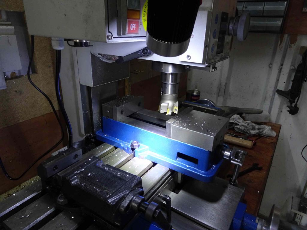

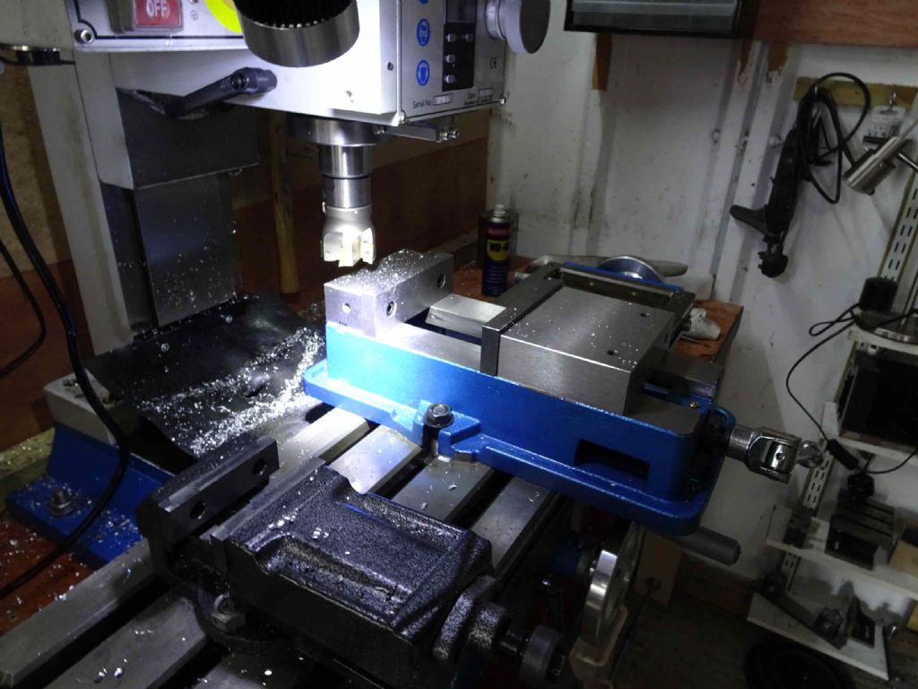

      I've put the keys in and they fit most precisely into the T slot and the base of the vice, however the face of the vice is out by around 0.1mm across the width.
      Henry has skimmed the base of his and I gather Jason has been waving his magic engineers wand at his as well, so there are clearly things that can be done.
      The responses (and a good night's sleep) have suggested that I should clock the various other faces to make sure that I'm addressing the right problem in the right place.
      Looking forward to answers and opinions.

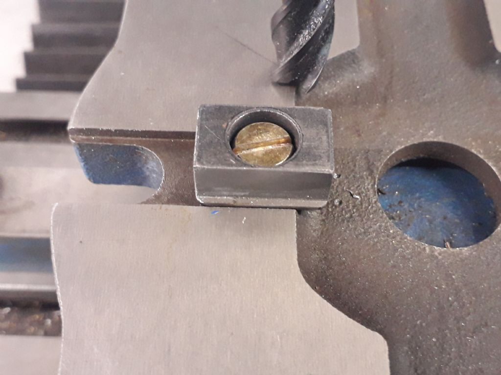

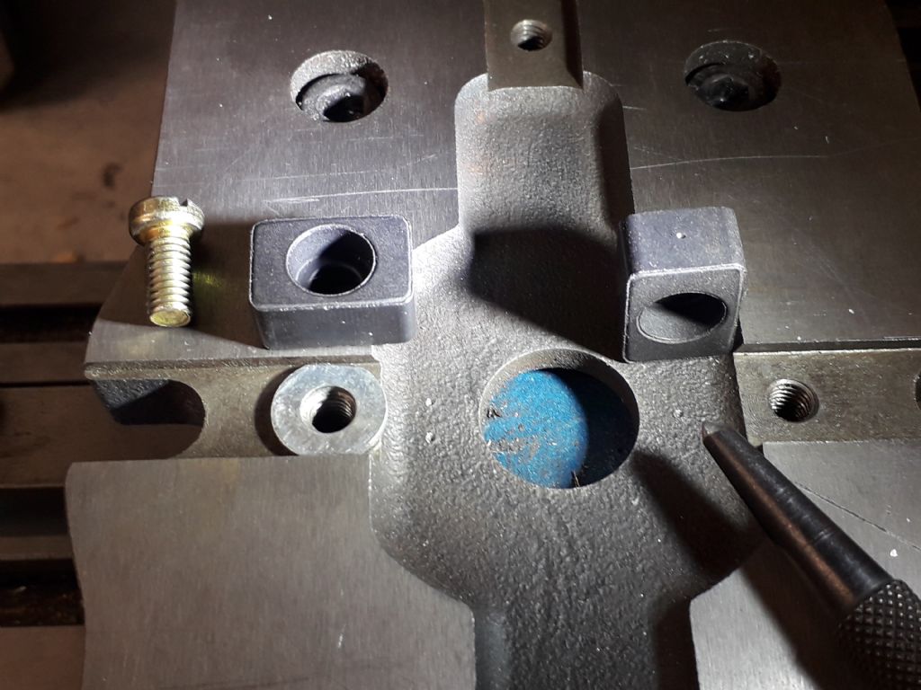

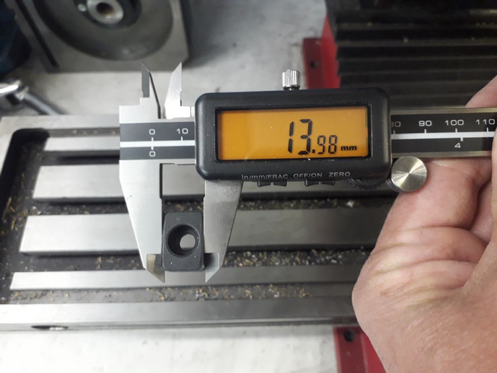

                          Well I was going to save this for MEW when I did a "pimp my SX2.7" article but you can have it for free.
                          Firstly The reason for doing this work was that the slot in the 80mm vice is a nominal 14mm along with the supplied blocks but the SX2.7 has 12mm nominal tee slots
                          Secondly I generally prefer to clock my fixed jaw rather than use the keys but it made it simple of when staging photos for the beginners series to have the keys fitted.
                          Firstly a check of the supplied blocks shows them to measure just under 14mm and they are a firm fit into the premachined slots in the bottom of the vice not falling out when you turn it over.
                          Slot in the table a nat's over 12mm measured in several places.

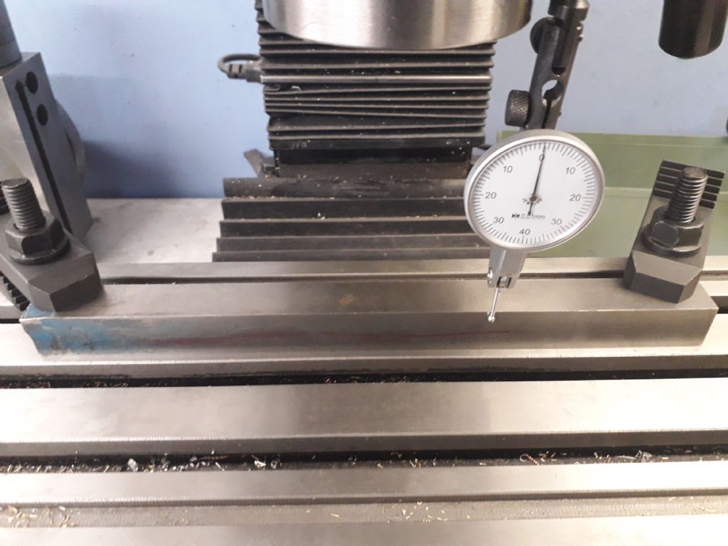

                          Also clocked the edge of the tee slot and good for 0.01mm over 250mm which is far wider than the spacing of the blocks.
                          First thing I did was clamp a piece of bar to the table,in this case some 3/4" square and clock that as true as possible over it's length The vice is then held upside down and clamped onto this bar.

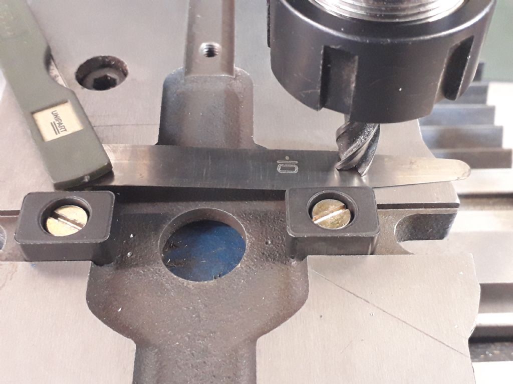

                          Mark the two keys so that they can always go back in the same way as you may want to remove them to angle the vice or use it length ways, etc. I went for simple 2 and 1 punch marks.

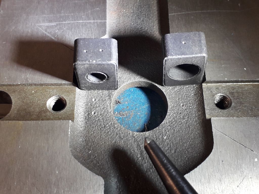

                          Pack under the blocks so they sit a bit higher up than their final position, I used a couple of thin washers then screw them into place.
                          Set your chosen milling cutter height so it is just clear of the bottom of the vice
                          Then machine the blocks to size taking a bit off each side, I went for 0.05mm under slot avarage so that I could also use on the other mills and the bit of wiggle room would allow for any fine clocking should I need it for high accuracy jobs.
                          Ian, you would only need to skim one side which I suggest if the fixed jaw side
                          Job done. I have actually been using this vice on all three mills particularly the CNC and locating it simply by pushing it back against the rear edge of the middle slot as I tighten up the fixings and not had any issues (no other work done to the vice either)
                          0.01mm over the length of the jaws, good enough for most work and clockable when you feel the need for anything better.
                          Edited By JasonB on 02/05/2020 10:47:30

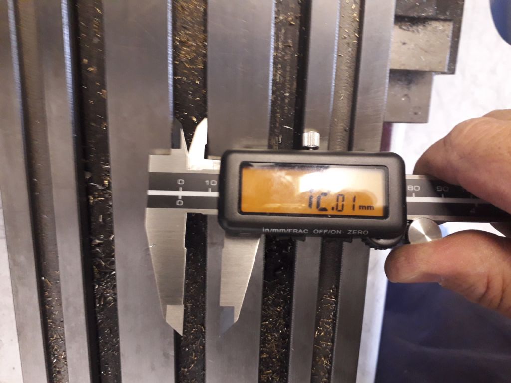

                              The keys with my 80mm versatile vice were way too big for the SX2P as it only has 8mm T slots so I had to take 3mm off each side of the 14mm keys. I also took a few thou extra off them which has left me a little room for adjustment.
                              This gives me a close position if I push the vice back towards the column which is fine as I always clock the vice and dont rely on the key position when I fit it back to the table.

                                              You can mill across the whole span of the vice from full in
                                              To fully out
                                              So I'm happy that I've not gone mad from that perspective. True with the jaws in their alternative positions you can get to the rearmost, but are way short of the frontmost. Still it looks like I could hold an 8 inch wide piece and cover the entire surface.
