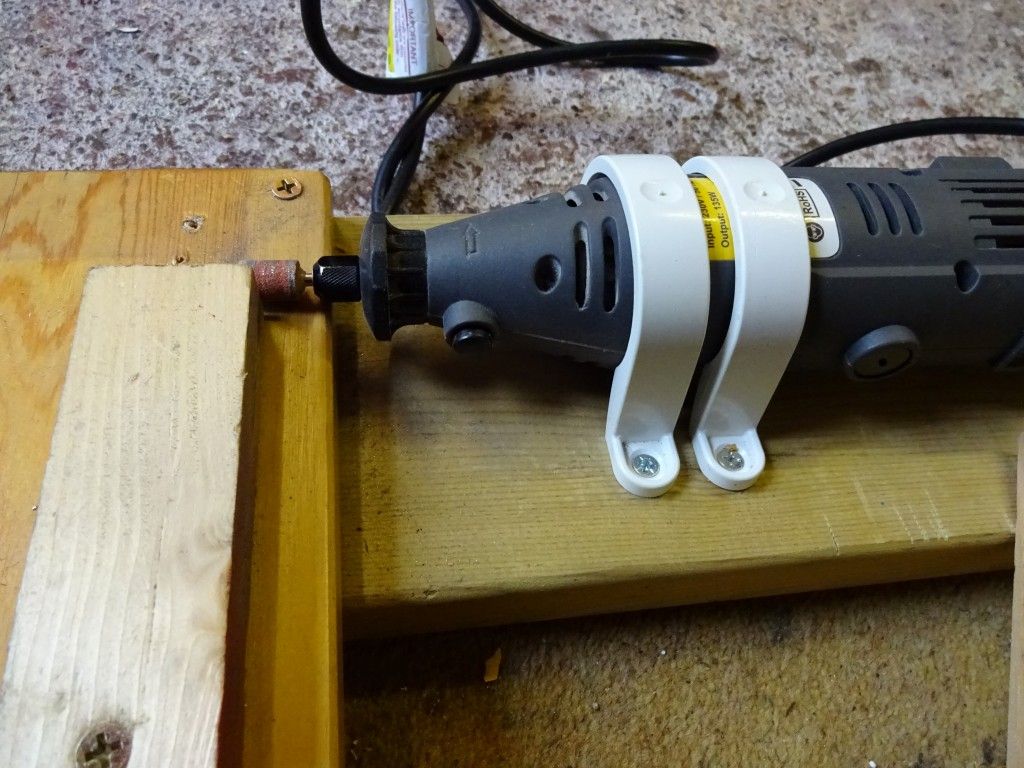

      Need to notch joint multiple lengths of thin wall stainless steel tube prior to silver soldering to form a fuselage.
      Have 6.35mm OD tube with a wall thickness of 0.2mm which is to be joined to 7mm tube. So how best can this be done?
      wondering if I could use a 7mm 4 flute milling cutter in a pillar drill with the 6.35mm OD tube supported in a larger diameter tube to hold it. Would this work?
      Tried making a simple grinder as pictured but this did not work at all. Perhaps a different stone type would be better

          Your Dremel rig with a 7mm carbide burr instead of the grinding stone?
          #398623
            My only worry about using anything with coarse "teeth" would be that it could catch the leading edge of the very thin walled tube and draw it into the cut. Could be solved by slipping a thicker walled tube inside the main one to add some support.

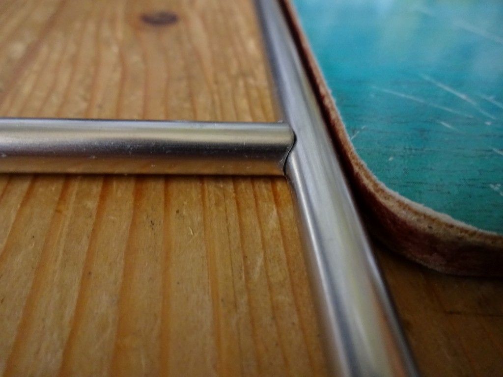

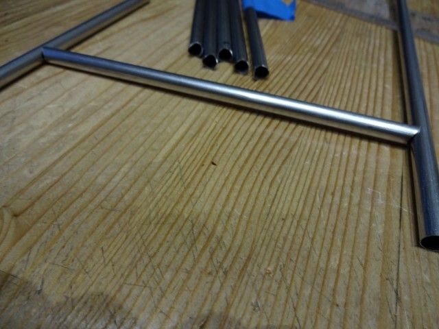

                      Those tools are no use as they will produce right angle cuts. What is required is a lap joint as pictured.

                        Tried another technique this evening which was very simple and quick. Using a standard 6 inch bench grinder, I ground an simple arrow shape on the end of the tube with an tip angle of about 90 deg going back no more than a 1/4 of the diameter, then cleaned up the shape with a round file of similar diameter to the pipe.
                        Result was not perfect but it was very quick with little burring of the tube.

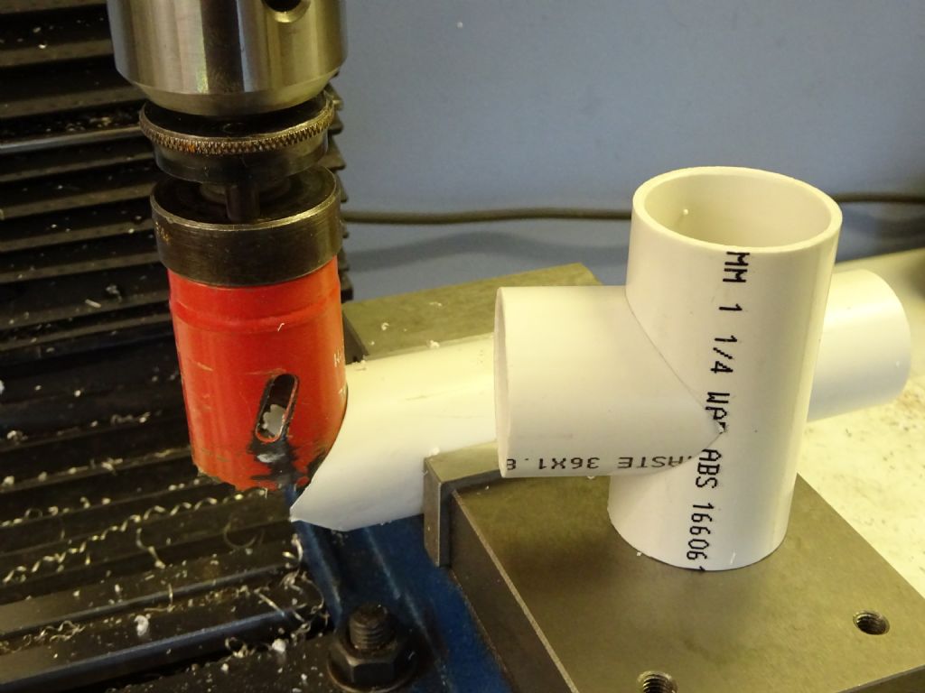

                                      You could probably do similar with diamond coated tile drills which are dead cheap if you can wait a week or two.
                                      Just hold tube in a vice and see if you can plunge down as you would with a holesaw

                                              Put a used 6mm diamond coated "holesaw" as per my earlier link into a drill chuck and tried it on the nearest stainless tube that I had which was 1/4" dia and about 0.5mm wall.
                                              Fed down with the quill, they need running fairly slow say 500rpm and need cutting oil but not too bad once the burrs where tidied up.

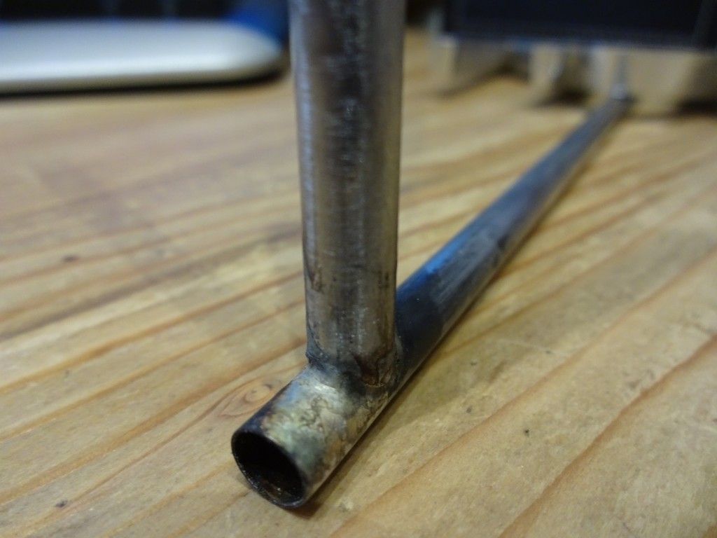

                                                  Andy Joyce 1
                                                    @andyjoyce1
                                                    Well a diamond drill did semi work but found with such a thin wall the drill just deforms the tube. So I find the best approach is to grind a V then clean up the shape with the drill.
                                                    First batch of tubes cut so at least some progress is being made.
