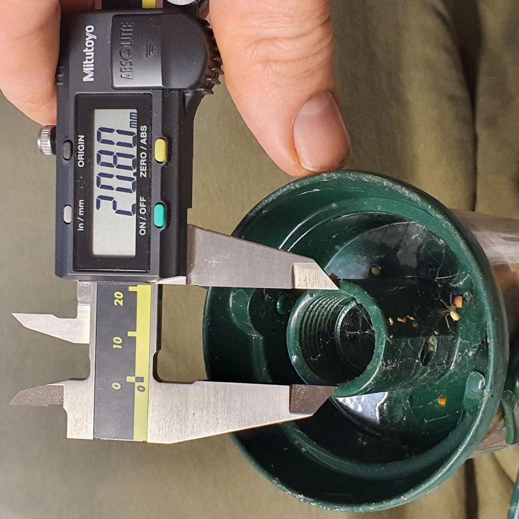

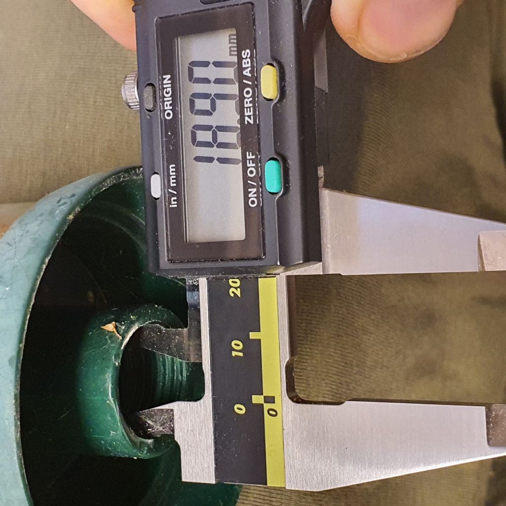

      Hello guys,
      I would like to make a pole top (ferrule) for a bird-feeder but the female thread in the feeder appears to be a strange size.
      Holding digital calipers against the thread across the two crests of what I imagine to be the male thread that would fit into the feeder, I get about 20.8mm.
      Using a thread gauge the nearest I can see is that it's 1.75mm (the largest I have) or possibly 1.8mm pitch.
      Using an online calculator this all works out to be 13/16" by 1/16" pitch.
      Is this a standard thread or maybe a pipe thread of some description?
      The inner most crests of the female thread are turned quite flat.
      Thanks,
      Ed.

          1.8mm pitch is close to 14tpi, 1/2" BSP is 20.995 OD so could be that

            Try 1/2 BSP

              Jason just beat me to it – BSP 1/2". common in tube or pipe work. Noel. I got the bronze medal

                  It looks like an American feeder that we have, so likely to be made to Imperial dimensions, rather than Metric dimension..
                  1/2 BSP is 0.825 (20.955 mm ) OD with a core of 0.734" (18.644 ) and is 14 tpi.
                  American pipe threads usually differ from BSP by 1 pitch, but in this case both are 14 tpi. but will be 60 degree rather than 55 degree Whit form.
                  So a wild guess suggests 1/2 NPS as close to your measurements (1/2 NPS is 0.840" (21.36 mm) OD, with a core diameter of 0.747 – 0.759" (18.97 – 19.23 mm  )

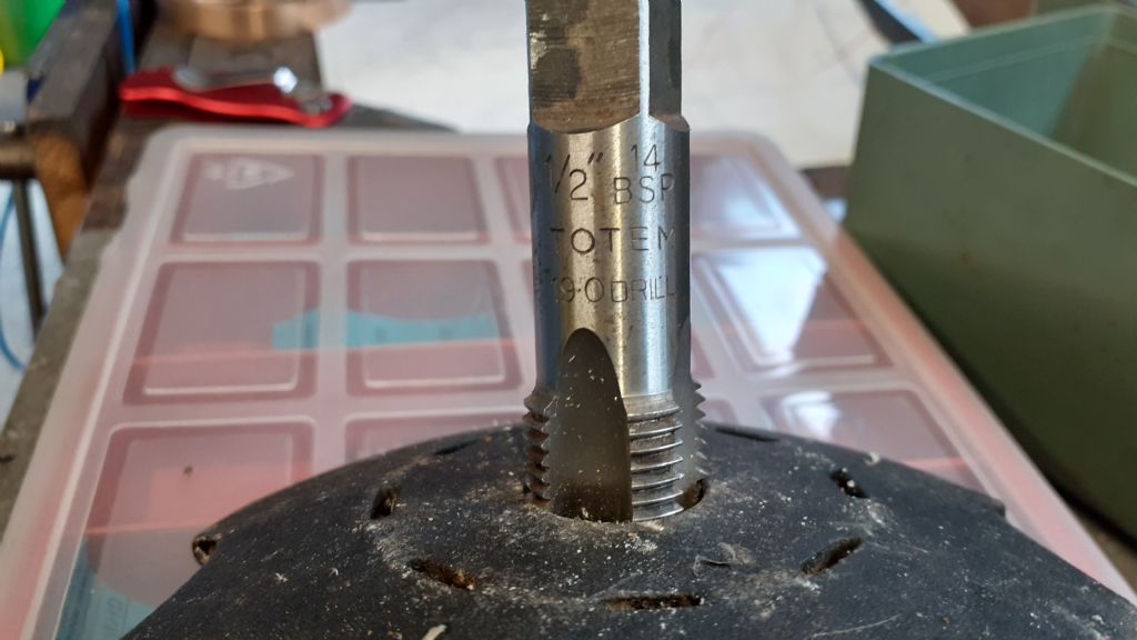

                    This is the cast alloy bottom of an old feeder I threw into the scrap metal bin a few weeks ago. Tap would well in just by hand

                          I found and tried a 1/2" BSP tap and it starts to screw in a bit but it's too long for the blind hole. A bottoming tap would be better and I might have one in work. I can check tomorrow.
                          The feeder was purchased here in the UK.
