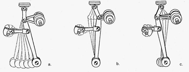

                                                      @ady1
                                                      It sounds like the sort of project where Constantinescues torque convertor could be useful
                                                      You get lots of torque for less power
                                                      The general principle seems to be… the faster you try and shove a weight back and forwards the more it resists the motion and the more energy you get transmitted to the secondary output shaft
                                                      a. is slow speed
                                                      b. is fast speed
                                                      c. is medium speed
