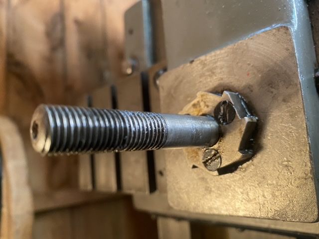

      5ad0afcb-1ae7-41b7-a04d-048f46d2e5ba.jpegHi,
      if I was to buy a quick change toolpost that I’m interested in, would this bottom washer with the 3 screws have to be removed as well.
      I ask this because the screw nearest the camera will not budge, there is hardly any slot for a screwdriver, I’ve tried a few times.
      if it has to be removed, any ideas how I’d shift it.
      thanks

          Yes! Can you file a wider slot? Or drill the head of the screw off. The "washer" is a ratchet cam for the previous toolpost.

            Try using an Impact driver.

              It might help to press out the main stud.

                Or next best thing to an impact driver – put a well-fitting screwdriver in the slot and give it a sharp tap with a hammer. Sometimes that's enough to jar screws free.

                  If you have the tool holder that matches the ratchet, then I recommend that you retain the original set up. QCTP s are fine, but they are not all good news! I have a QCTP system which I use, but it isn't as rigid as the original set up. I revert back to the old system when I want to rough out a piece of work and when I want a good finish with honed HSS.

                    If you haven't already, you could try using one of the interchangeable screwdriver bits. They have parallel tips as apposed to a regular screwdriver tip that's tapered that might induce "cam out". However, do bear in mind, the ISB's tend to be a bit brittle.
                    Also, another vote for the impact driver. Good luck.

                      +1 : Slotted screws are a pain in the rear end because it's important to use the right-sized screwdriver, Anything less than a blade that fits accurately into the slot, width, length and depth, risks chewing the screw-head so badly it has to be drilled out. A few things to try, maybe in combination:
                      • Build a dam around the head with modelling clay or bathroom sealant and flood the top of the screw with penetrating oil. Leave it for at least 24 hours and try the well-fitting screw-driver. Don't force it: there's a high-risk of mangling the slot or shearing the screw. If it doesn't move with moderate force, re-soak it, and repeat.
                      • Heat is good at breaking corroded and gummed up threads. Heat and cool the area several times with a blowlamp. Don't overdo the heat! If still tight after a few cycles, try penetrating oil again
                      • If still seriously stuck move to an impact driver or screw-extractor. Impact drivers force the blade into the slot whilst applying a powerful undo shock turn. Be careful not the break the casting! Screw-extractors have a left-hand thread that screws into a pilot hole drilled into the axis of the stuck screw: the harder it's turned, the tighter it grips except there is a risk it will strip the screw.
                      If the screw doesn't come out without fuss, I really don't recommend doing this just to fit a QCTP. At this stage I'd bet the farm a QCTP isn't needed!!! Later maybe, but it's not smart this early to get embroiled in a tricky screw-removal. Be aware the cross-slide is a brittle casting, not immensely strong, and the more brutal stuck-screw methods risk breaking it. They're hard to replace or repair, and without one the lathe is almost useless…

                                        If it's a Myford, the three screws only hold the ratchet

                                              Would it be possible to bore a recess in the underside of the QCTP so that it sits over the ratchet and down onto the base. Or, perhaps you could make a “washer” with a central hole to fit over the ratchet which is the same thickness as the ratchet forming a slightly higher base ?

                                                just get a very shallow angle centre punch and put in the slot and tap with Birmingham screwdriver
