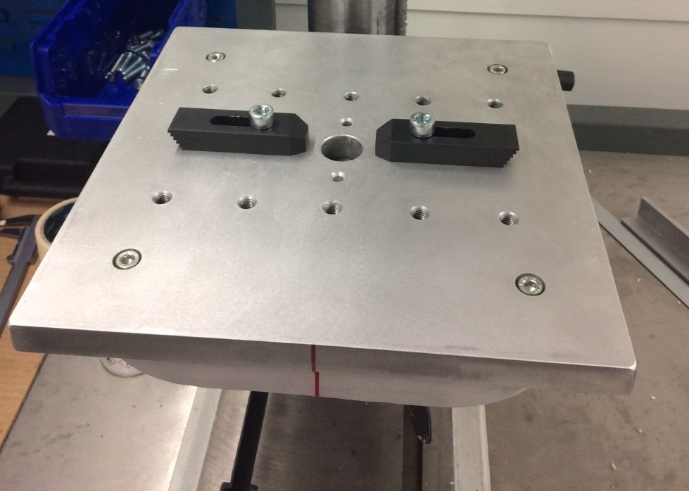

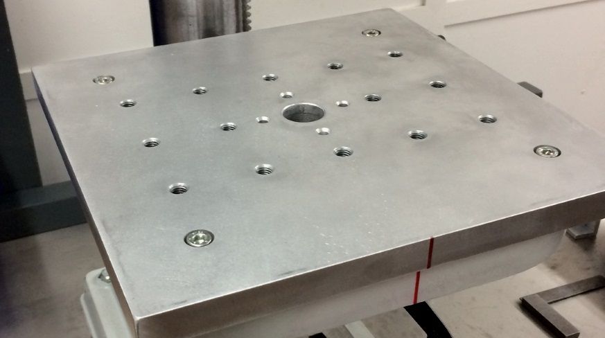

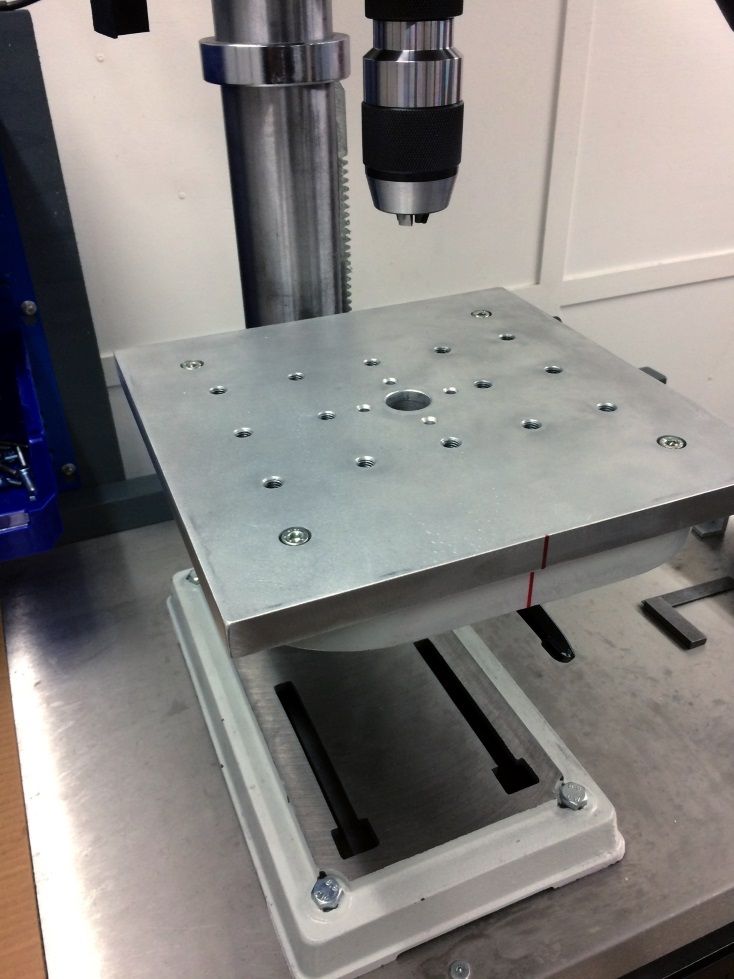

        Hi.
        Made a tool/clamping plate for my drill press. 300x300x20mm tooling plate.
        Main holes are M10 and a 26.3mm centre hole same size as the table underneath. 4 extra plain 7mm holes around the centre.
        All the holes are dead straight am very pleased with it .
        Dave.
