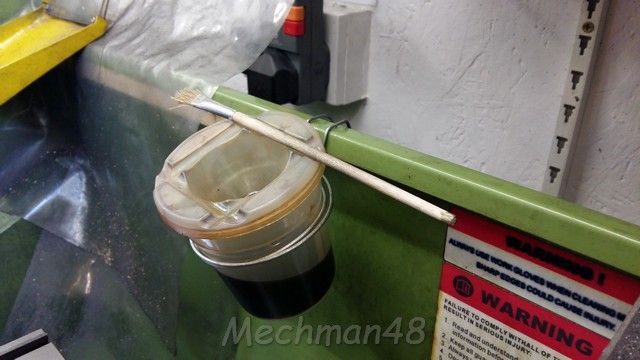

                                mechman48
                                  @mechman48
                                  +1 for all the above. for my uses …
                                  Brass & Cast Iron – dry
                                  Steels – with HSS Light cutting oil, SAE32 or similar. if using carbide inserts – mostly dry
                                  Aluminium – WD 40 or parafin ( Kerosene ).
                                  Threading – RTD or similar, I have used a heavier grade oil ( gearbox oil ) , on Aluminium I use WD40
                                  Application – I use a kiddies non spill paint pot with 1/2 " brush ….
                                  George.
