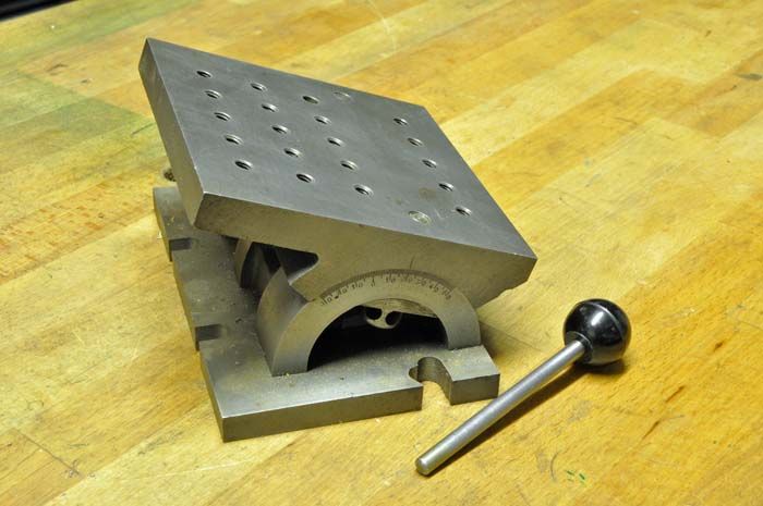

                    This one came as a kit from Model Engineering Services – the same people who sold the Quorn castings. MES are sadly now defunct, I don't know if anybody has taken over the patterns, it's a very solid piece of kit..
                    And, yes, items do sometimes slip when machining – as evidenced by that slot crook
                    HTH (but not much)
                    Rod

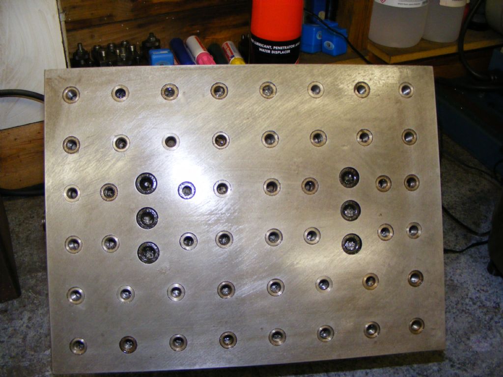

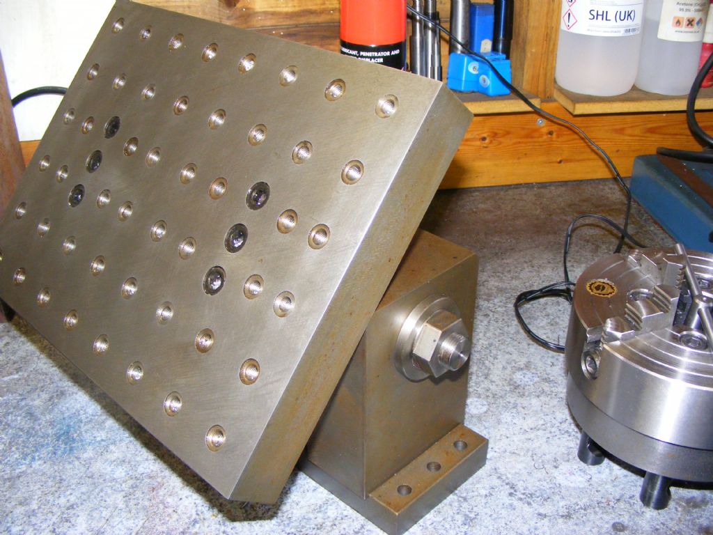

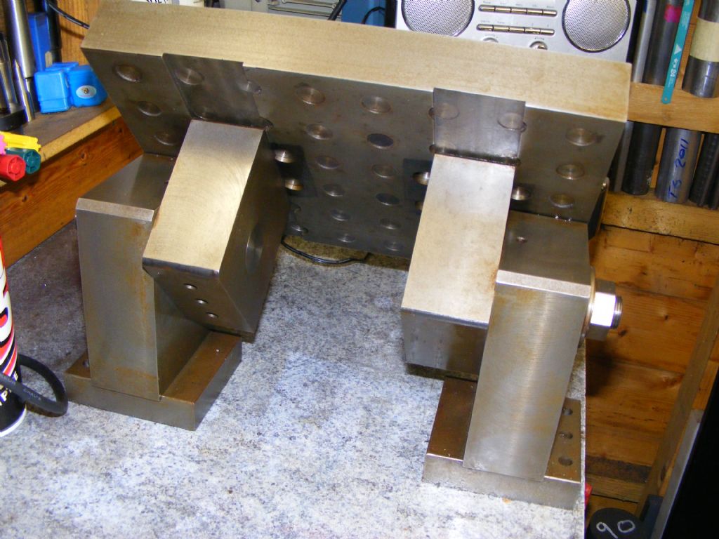

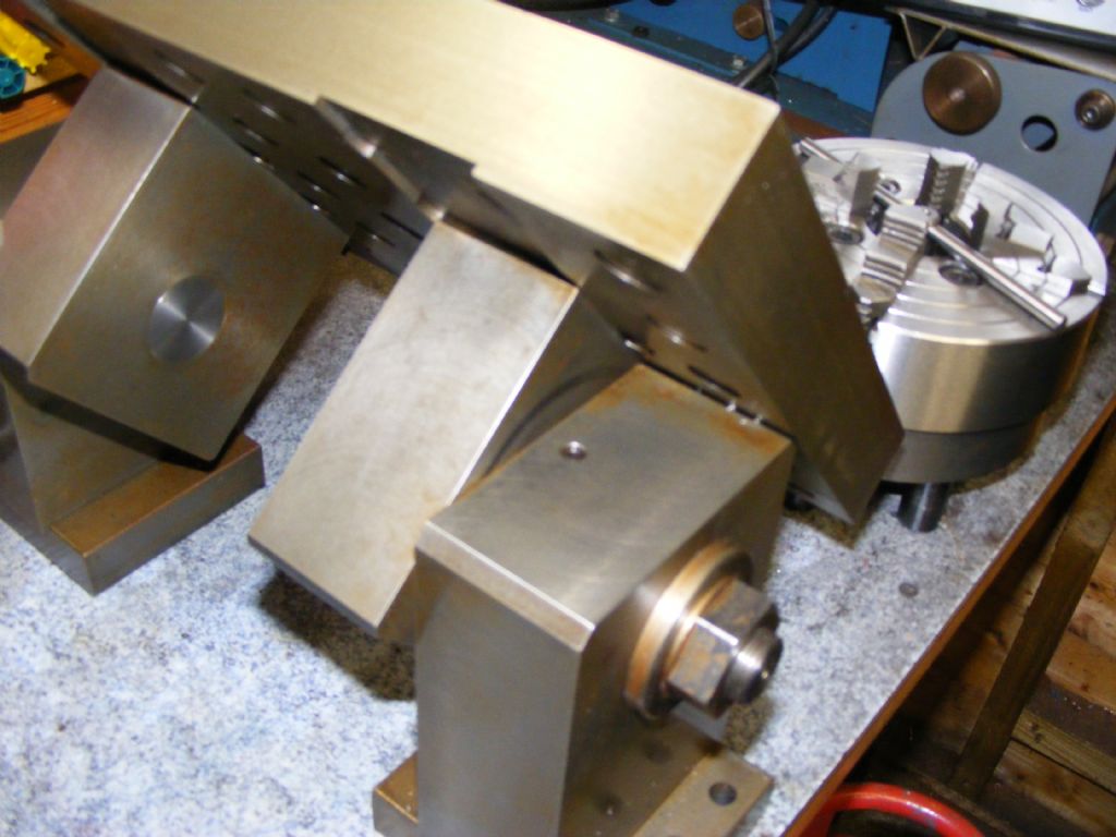

                                        Hope this has some relevance, This is a tilting table I made a few years back. Although its from scratch and not a kit. It is all Meehanite, except the threaded pivots and their nuts [EN24t] and the threaded inserts [EN24T @ M8] I decided to have a go at hand scraping the plate surface after it was milled, although it took 2 days I feel it was worth it as it is flat to within 0.005mm anywhere. The scraping was actually quite enjoyable but not something I would want to do full time !! It tilts 95deg either side of horizontal and as you would expect from something that weighs in at a shade over 68kg's VERY rigid. The pivots pins are 24mm Ø threaded 1.25mm pitch [ EN 24T] and are 1 left hand thread and 1 right hand thread. The inserts are 25mm ctc and are also EN24T they have a flange on the rear and when they were all pulled home tight sit approx 0.25mm below the surface. It doesn't ever move from where it is set regardless of how heavy a cut is taken. Were I to make another one, I would design in a tilting mechanism as you must ensure you have a good hold of it when you loosen the pivot nuts!! If not, then you will have around about 35kg's of Meehanite plate either tilting away from you or toward you [and you don't want any digits between the table and the milling machine bed ] if you don't have control over it, or else its a trip to the KRANKENHAUS !! This genuine Meehanite is a sheer joy to machine and work with, although very dirty. Hope this has been of interest.
                                        Cheers.

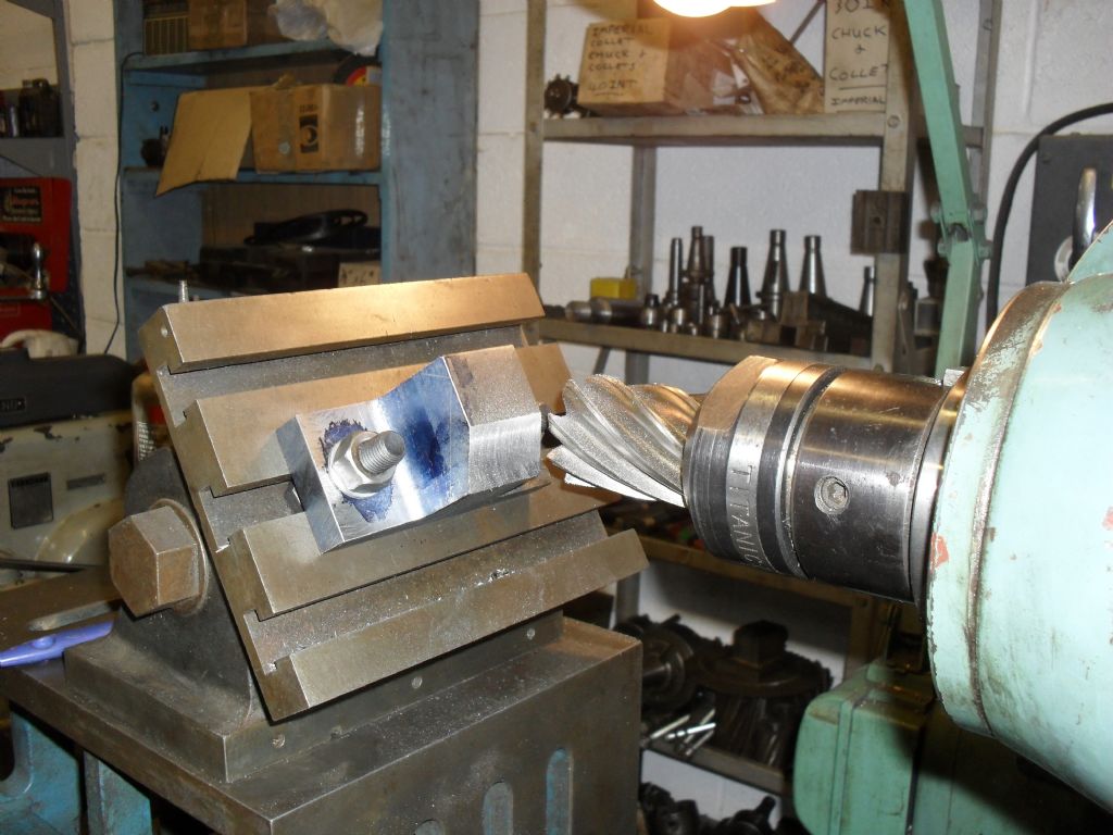

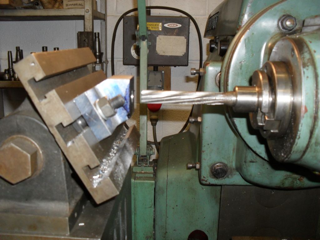

                                            Here is the tilting table that I use on an elliott U2 mill, it is 6"x 8" and has 3 T slots, I like the T slots better than plain slots, it is quite old but is in nice condition.
                                            Richard.
