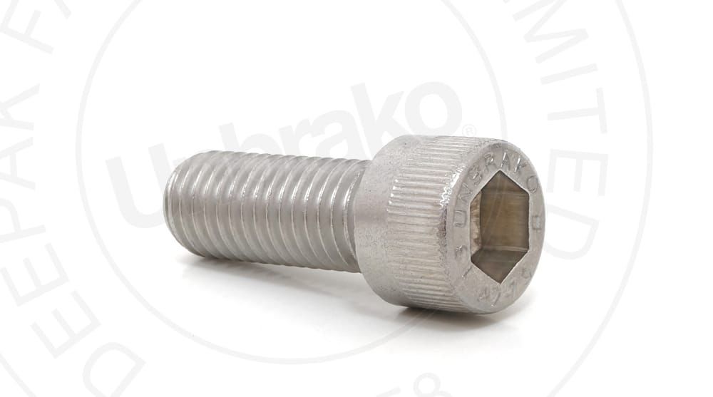

                        Posted by Vic on 21/09/2023 23:10:21:
                        I use mainly stainless ones though and I’ve never seen one that was knurled.
                        It must depend partly on the manufacturer. I have a large number of recently purchased M4, M5, and M6 stainless cap screws that have knurled caps, among others of the same diameter that are not knurled. Some of the knurled ones have a manufacturer’s mark: “THE”.
                        I think I’m right in saying that grade 8.8 cap screws tend not to be knurled, whereas the 12.9 ones do. I’m not sure about grade 10.9 ones, as I don’t have any I’m aware of.

                          Both milled and non-milled types are available in stainless steel, frequently from the same manufacturer although not many suppliers seem to offer both types.
                          The use tends to depend on the preference of the purchaser. Non-milled are frequently specified where the heads will be on display, e.g. on the face plate of electronic equipment, and are often polished. Milled seem to be more often used in machinery – cars, motorbikes, outboard motors etc. Perhaps this is so you can get hold of them with a pair of multigrips when you don't have the correct size hex key available devil . Sorry Sir it wasn't me indecision.

                                        Posted by Bill Phinn on 22/09/2023 00:20:00:
                                        I must have nearly a thousand cap head socket screws in M2.5, M3,M4, M5, M6 and M8 in stainless steel, some of them marked THE and none of them are knurled. I’ve actually never seen one before. I use mainly Kay’s, Boltbase and GWR. I should add that I generally only use Metric fasteners so perhaps that’s why?
                                        #661042
                                        Bill Phinn
                                          @billphinn90025
                                          Posted by Vic on 22/09/2023 11:34:40
                                          All my stainless cap screws, whether knurled or smooth, are metric.

                                            I should add that I’ve not been overly impressed with the quality of the knurling on most of the High Tensile (Black) socket screws I’ve bought in the past. Poorly formed and not very deep. The exception to this were those manufactured by Unbrako and the straight knurling on them was a piece of art in comparison.
                                            #661069
                                            Bill Phinn
                                              @billphinn90025
                                              Here’s an Unbrako knurled A2 skt head cap screw:
