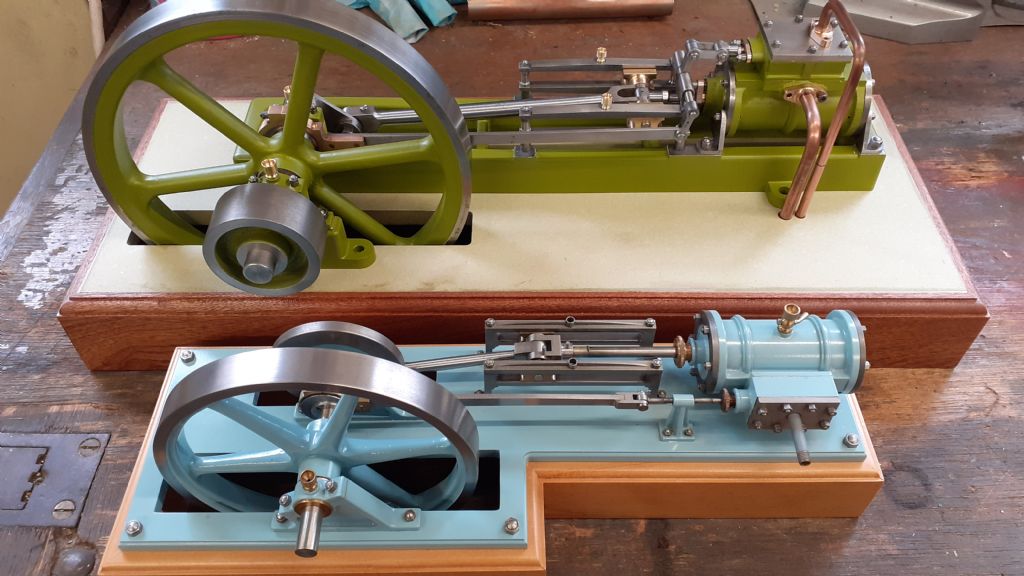

          Here are a few more photos of my finished engine which should give an idea of what's to follow.

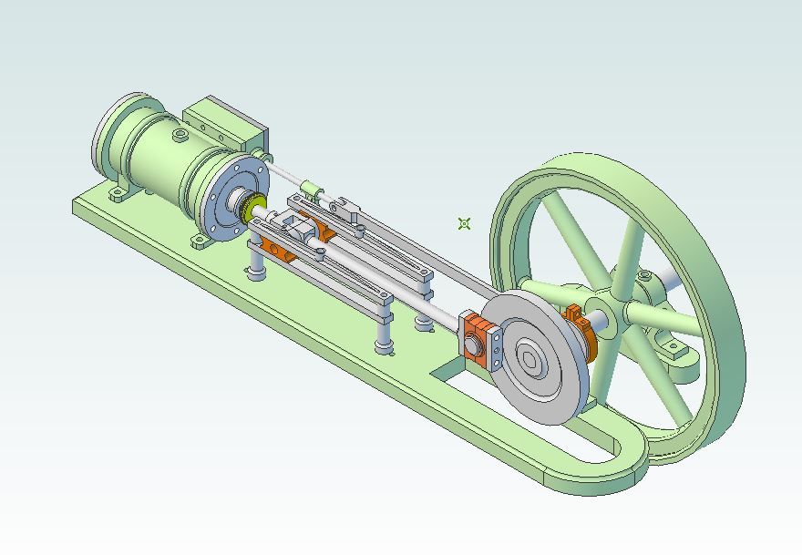

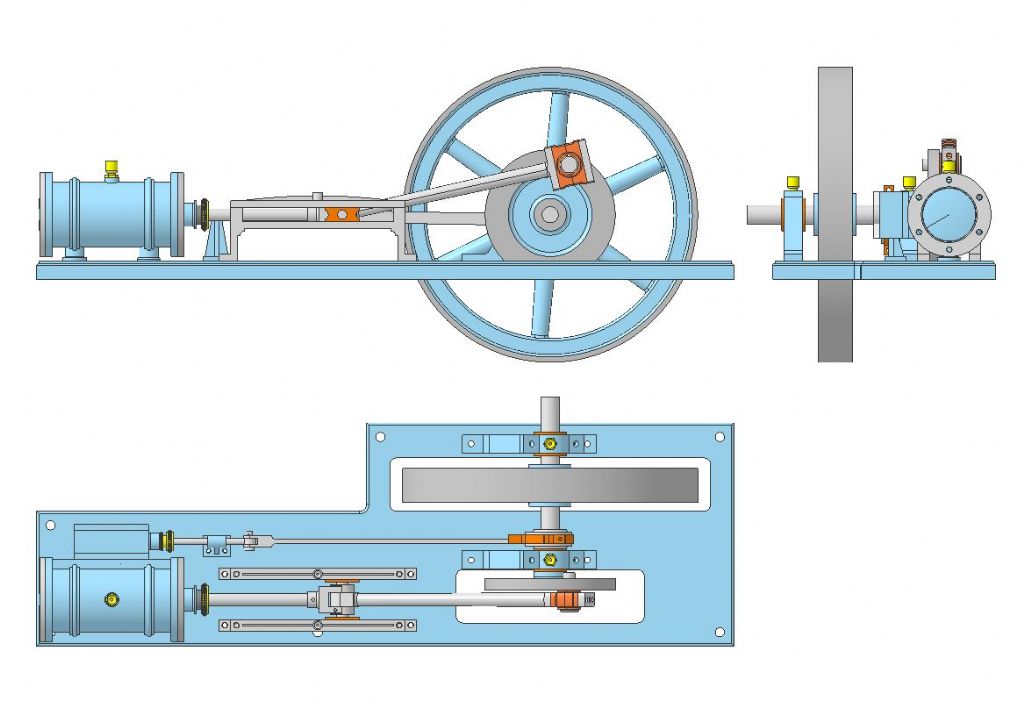

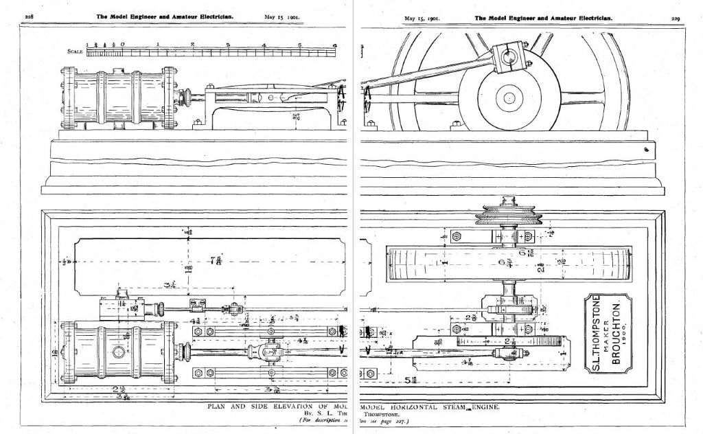

            This is the drawing that was originally on ME issue No 49
            #538472
              General Arrangements in B&W and colour.

                    Thanks for the comments, Luker I will wait for my paper copy to have a read of your 3D printed pattern article.
                    It is quite a nicely proportioned engine, having just done a Stuart Victoria which has almost the same bore and stroke the Stuart seems quite agricultural in some areas as well as being considerably larger.
                    I went through the bill of materials last night and priced it up allowing for 300mm lengths of the smaller sections and the bigger bits in the nearest 25mm increments and allowing £25 for a flywheel casting the materials came in at £101.00. Allowing a further £25-30 for fixings etc as they tend to come in packs of 50 that still makes it about 1/3rd the cost of a set of Victoria castings with the added bonus that fabricating and cutting from solid will give you more workshop time for the lower outlay so another win win situation.
                    If going for the JB Weld option over silver solder then you could actually use cast iron for all the cylinder parts and that would be a bit of a saving over bronze/brass.

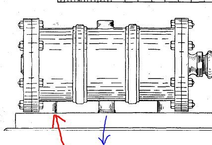

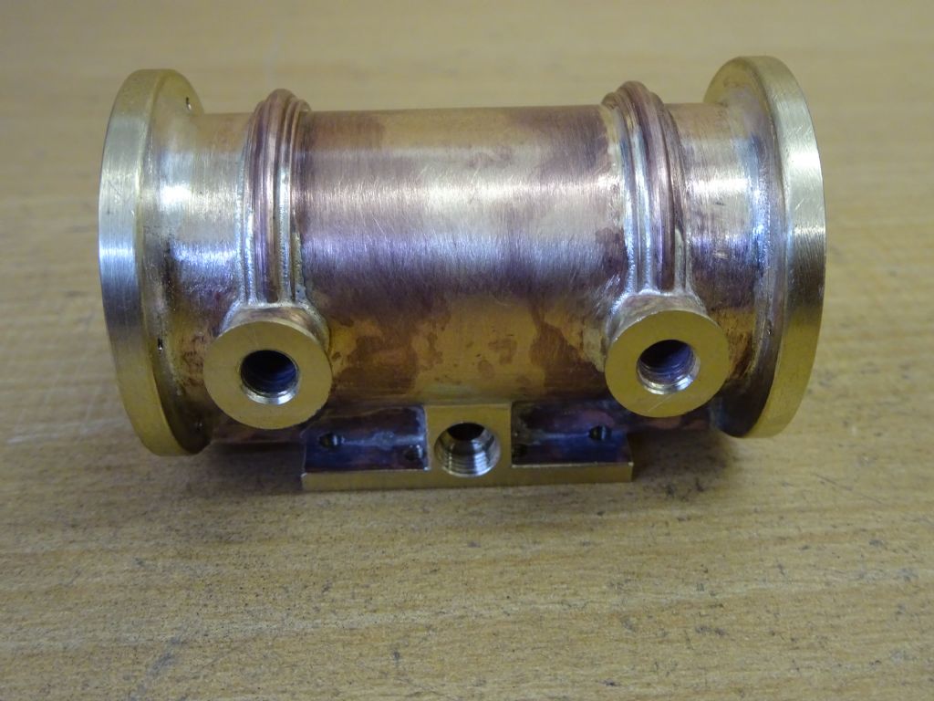

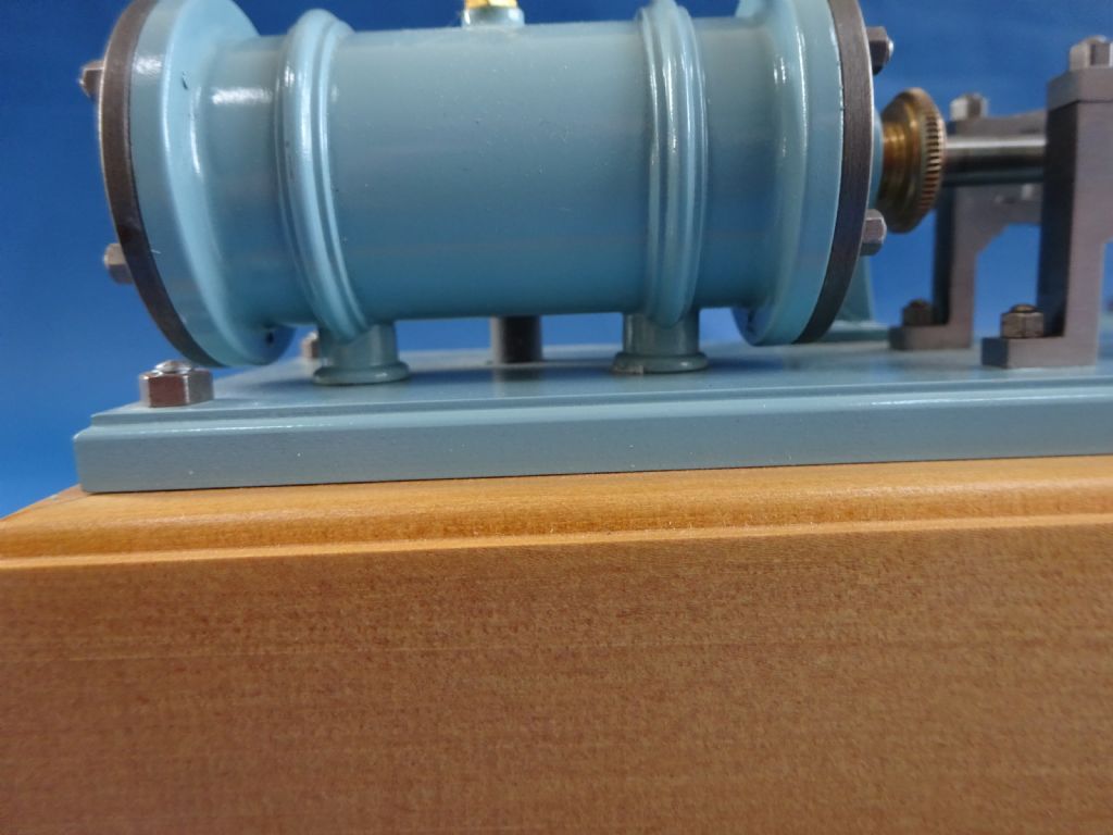

                      I have a few questions about this model design by Thompstone, and the full size engine which it might have been based on. Do you have an idea of the scale that Thompstone intended? It looks like quite a small engine, maybe a bore of 1 foot, or smaller than that, having a screwed gland?
                      I can't make out where the exhaust connection is. I would be interested in your opinion of some of the features which Thompstone has included.
                      • Would the full size engine cylinder have been mounted on the two feet (difficult to access) or on saddles or flanges as in the Stuart engine?
                      • Would the full size cylinder have had those decorative rings cast in?
                      • Is the cylinder oil cup a practical proposition in full size?
                      • Is there a reason why the full size engine would have had the bearing caps mounted at an angle?
                      Please understand that these comments are not meant as criticisms, I am just curious about the full size design features which I know little about.
                      Paul
                      #539744
                        Hi Paul, No problem discussing aspects of the design.
                        Thompstone does not say that the engine is based on any specific prototype, in fact he just presents it as a "Model Horizontal Engine. Since I first saw it I have always pictured it as a small workshop engine rather than anything large so bore would be in the region of 3 to 4 inches which gives a scale of around 1/3rd to 1/4.
                        1. It's a bit difficult to make out what he is describing in the text (I'll post that later) and the drawing does not help too much. The part I have arrowed in red seems to be shaded as if to represent a curved or rounded surface but there is not outer edge, I would have expected a line down from the end of the cylinder possibly? The way the bottom nuts are visible suggests that whatever support is to the valve chest side of ctr line ? He says that the exhaust has back nuts which make the cylinder fixing rigid so that may be acting as a third leg? I have assumed that the part arrowed blue in the middle is the exhaust going down into the base.
                        So with those details not being clear I took a bit of artistic licence and used the two round feet which seemed right centred on the bands and just dropped the exhaust down into the base. I'm not keen on the angle brackets that the basic Stuart Victoria uses but it would not be out of keeping to add wider feet in the style of "Princess Royal" or similar which could easily be substituted for my round feet. The Victoria was based on another workshop engine of 5" bore so again quite a small prototype.
                        2. The decorative cast rings seem quite common when looking at other workshop and generally small engines and there may be even more with them but hidden from view under cladding. If you have a look at these three pages of horizontal engines on Preston's website you can see several examples of one or two bands around the cylinders.
                        3. Again there are several of the engines on Preston's that have a similar oil or fat pot centrally mounted on the cylinder so reasonable to assume it's not out of place on an engine like this.
                        4. I'm not sure if there is a specific reason that the split line of the main bearings is angled like this. On an IC engine they tend to be angled the other way which I have always assumed is to better resist the forces during the ignition stroke but as our steam engine is double acting that can't be why. Another thought is that by angling the split line of the bearing it puts the joint above and below the main angles of thrust as the piston moves back and forth which means an uninterrupted oil fil on the surface of the bearing where the load is greater. But I'd welcome any other comments on this one.
                        It's something you see on most sizes of engine, from the small workshop ones at Preston's, Tangyes used it quite a bit on their various engines not just the popular one that gets modelled but also ones like their "colonial" and right upto some of the larger Corliss engines by various makers.
                        Edited By JasonB on 14/04/2021 18:43:28

                              Hi Jason, don't want to butt in other to say the cylinder looks every bit a casting, you certainly have it down to an art producing would be castings from bar stock. I wondered could the rings on the larger full size engines be there for stiffness/rigidity maintaining size and shape on a part like a cylinder which heats and cools, maybe not just a thought.
                              Ron
                              #539885
                                Hi Ron, don't feel you are butting in, the more the merrier.
                                Yes that is the only practical reason that I can thing of the bands being used to ass strength which may allow the rest of the cylinder side wall to be cast a bit thinner.

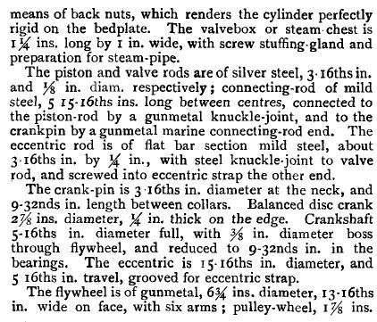

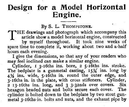

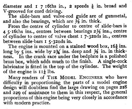

                                Here is the text that went with the GA drawings I posted last week

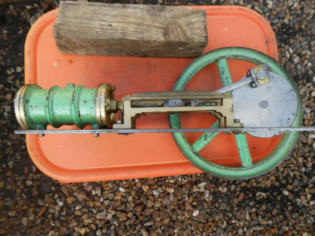

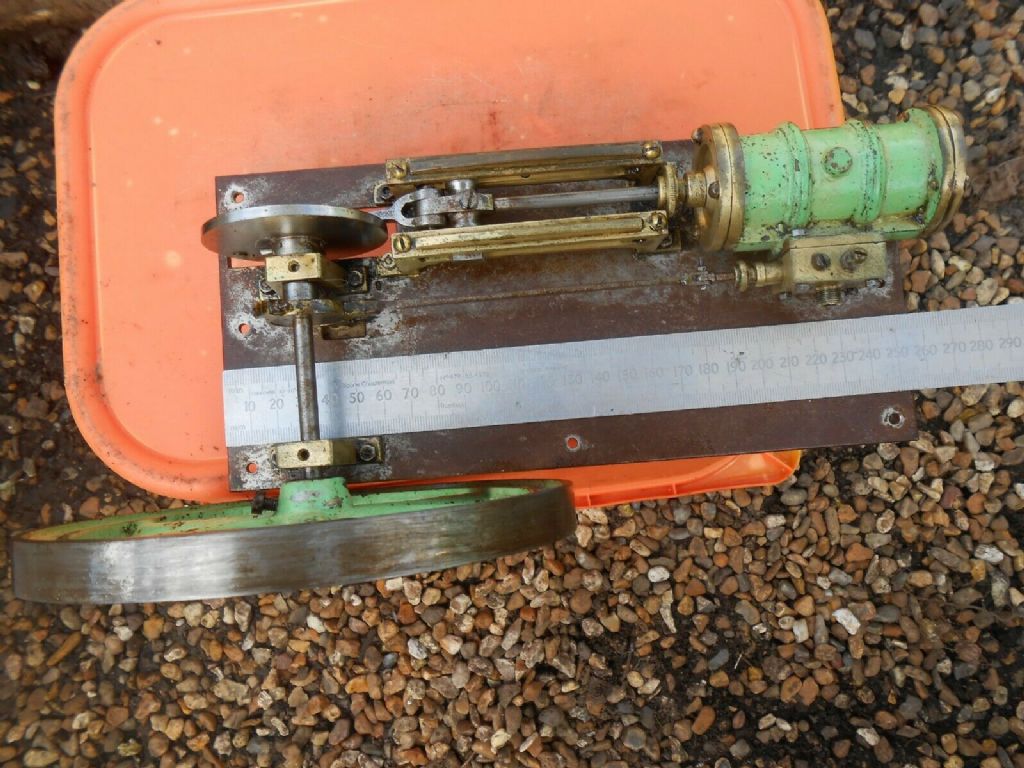

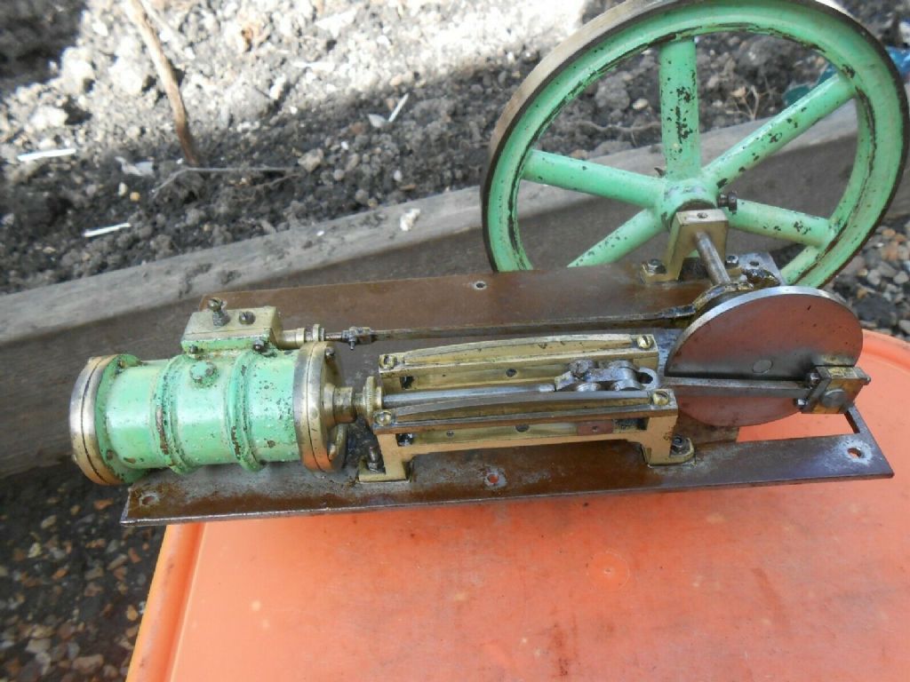

                                  I think I should buy a lottery ticket this week as what are the chances of this turning up on e-bay just as I've started this series. Looks to be based on the same original design, cylinder and the crosshead guides are right just the simpler upright bearing housings let it down.
                                  4gAAOSwWf1gQkcG”>Ebay listing
                                  While I'm on does anyone have a copy of an early ME, Vol 6 No 69 as there is a mention of castings for this engine in it.
                                  #539924
                                  Weary
                                    @weary
                                    Jason, and others, of course,
                                    Re: period castings for Thompstone Engine;:
                                    Model Engineer, Vol VI, No.69, March 15 1902, page 144, under heading 'Amateurs Supplies', text reads:
                                    Model Horizontal Engine Castings
                                    Readers of The Model Engineer will hardly need an introduction to the work of Mr S. L. Thompstone, some of it already having been published in these pages. A neat list, which he is issuing post free, on application, illustrates a model horizontal engine which is made in two sizes. Those who require castings of this type of engine should make application to Mr Thompstone, Nelson Street, Broughton, Manchester.
                                    End of text.
                                    Regards, Phil.
                                    #539925
                                      Thanks for that Phil, interesting to see it was being made available in two sizes

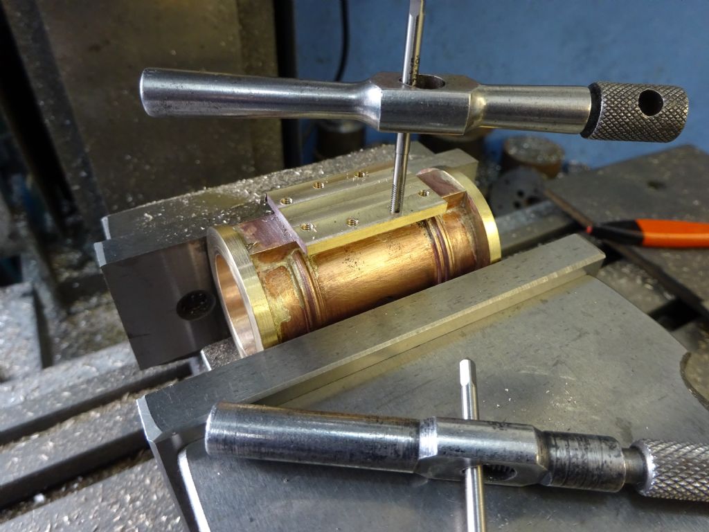

                                              Photo 10AThe port face having been milled flat and down to finished size and the stud holes tapped

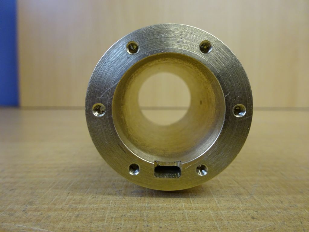

                                              Photo 14A. View of underside of the cylinder showing tapped exhaust outlet and feet
                                              Photo 14B. End view of cylinder showing milled notch through to steam passage

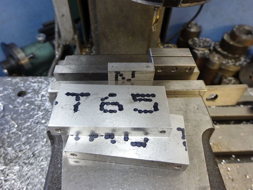

                                                #542463

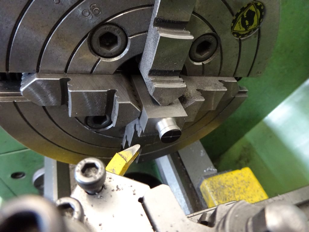

                                                  A few more additional images to go with Part 3 which is just out.
                                                  22A The material for the pedestals having been machine dto overall size can now have the holes drilled and tapped

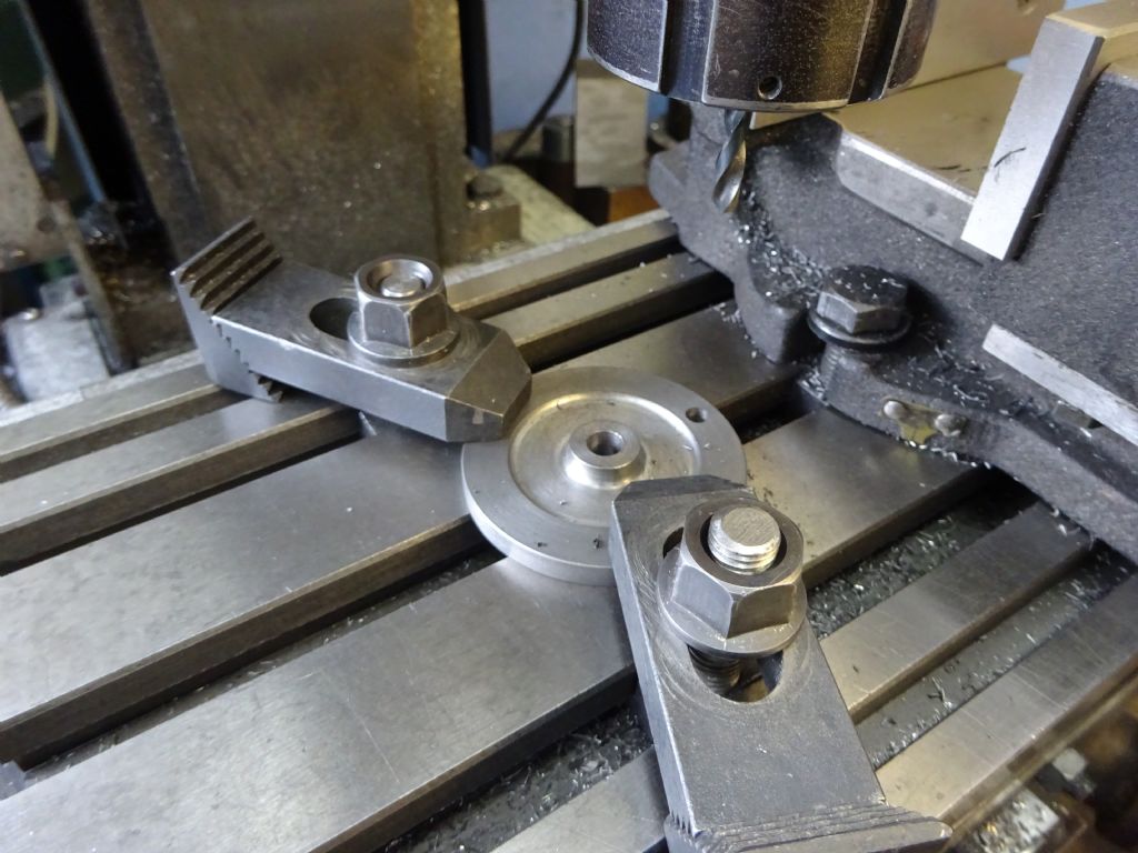

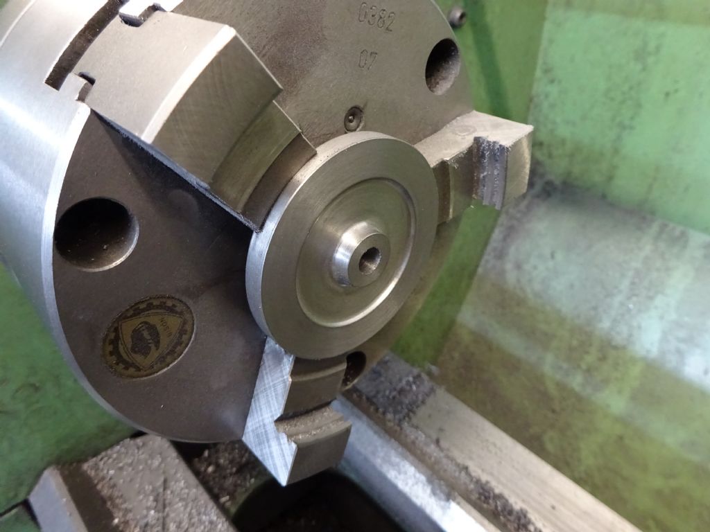

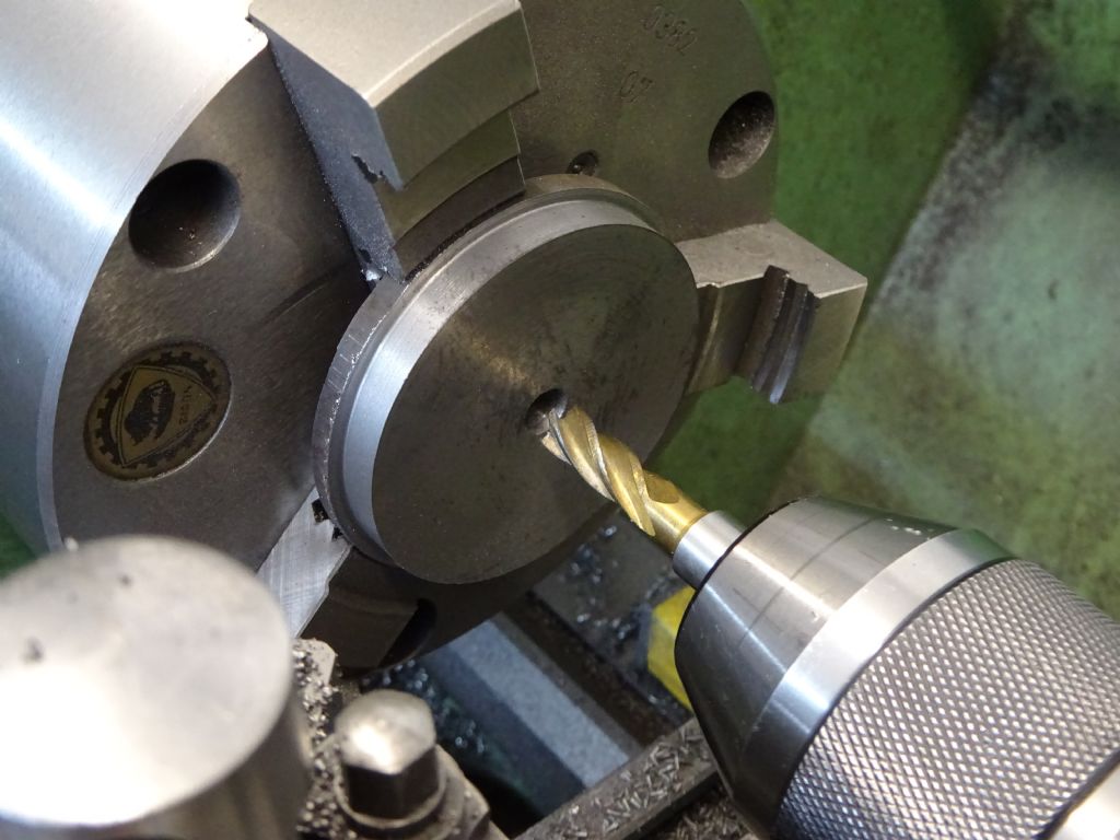

                                                  27A Using a 7mm milling cutter to bore the crankdisc, though a drill or boring would do as spigot on the rod can be sized to the eventual hole diameter.
                                                  28A The other side of the crank disc after recessing the face.
                                                  28B Crank disc clamped to mill table, ctr located then mill used to position crankpin hole for drilling

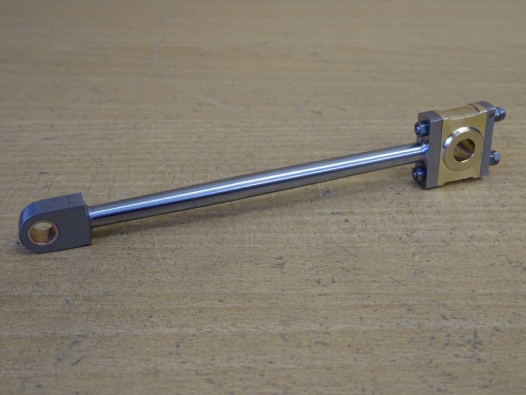

                                                  35A Completed Conrod.

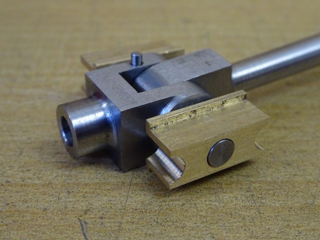

                                                  #545648

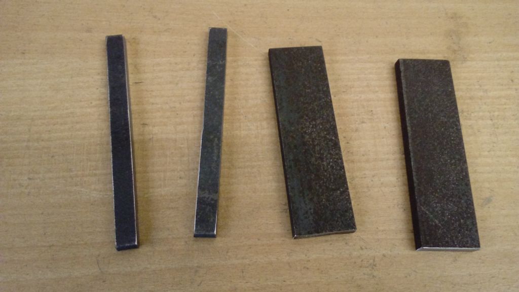

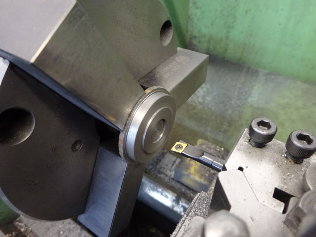

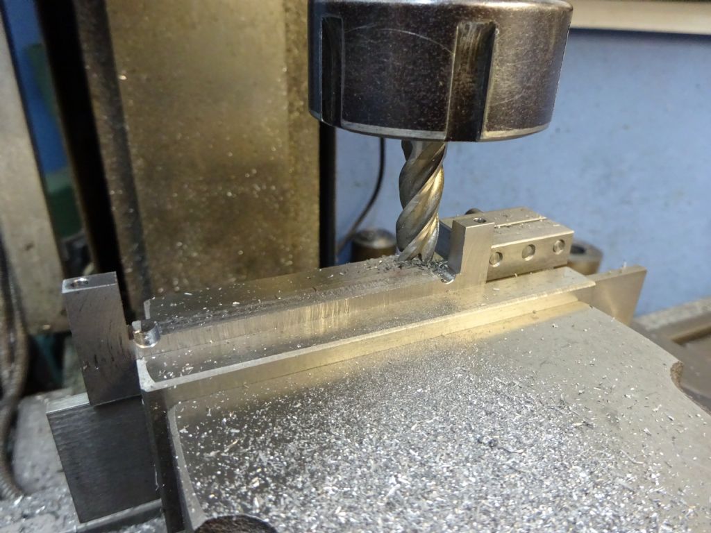

                                                    39A the assembled crosshead and pin with slippers in place

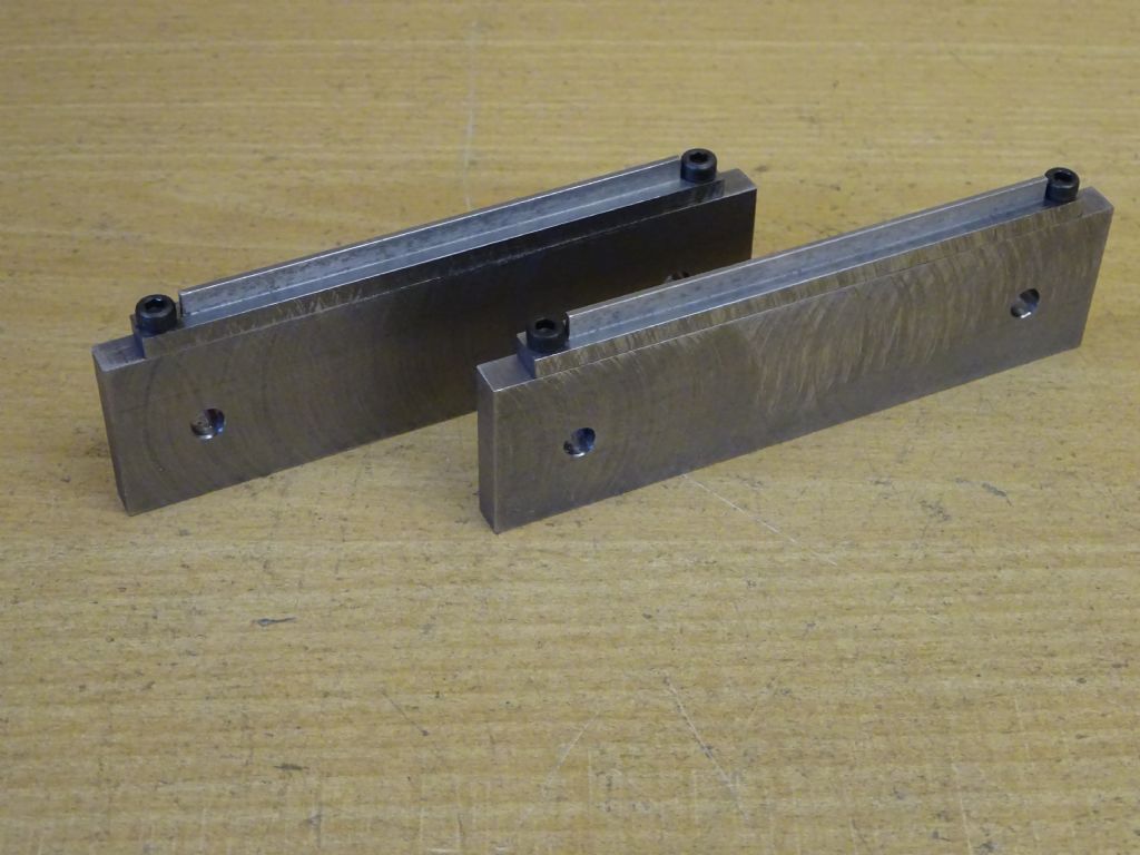

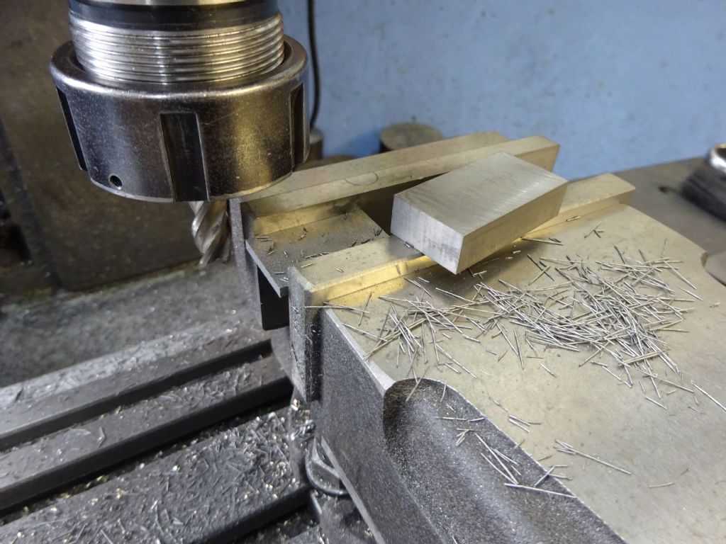

                                                    40A Rough cut hot rolled steel for the crosshead guides

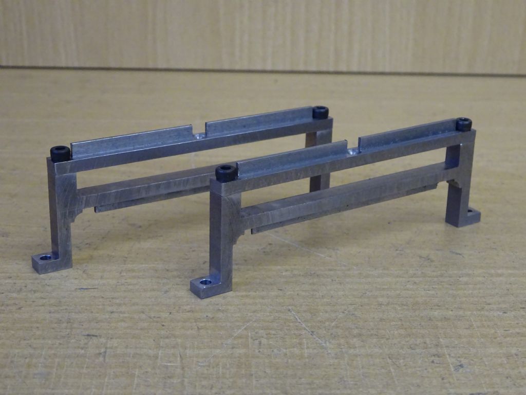

                                                    40B top guides almost complete, bottoms drilled for the internal corner

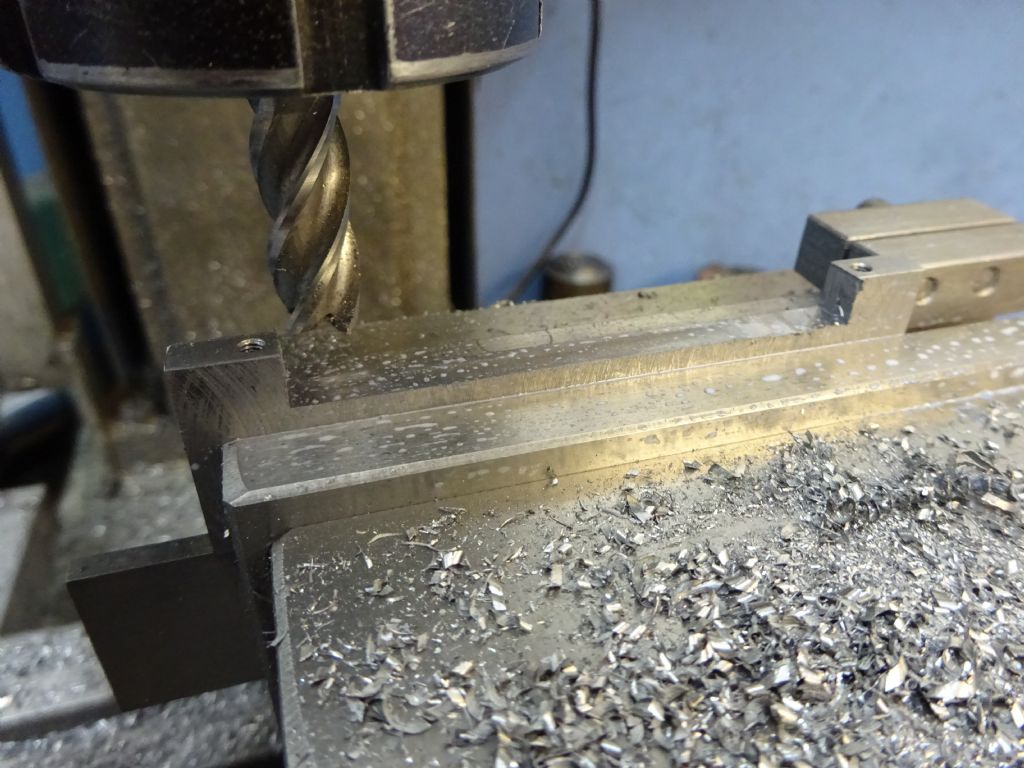

                                                    41A Milling away material from underside of lower guides
                                                    43A milling upper cutout of the lower guide
                                                    44A almost complete, just the upper and lower webs to be shaped
