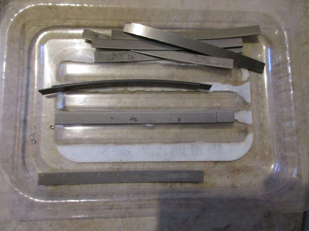

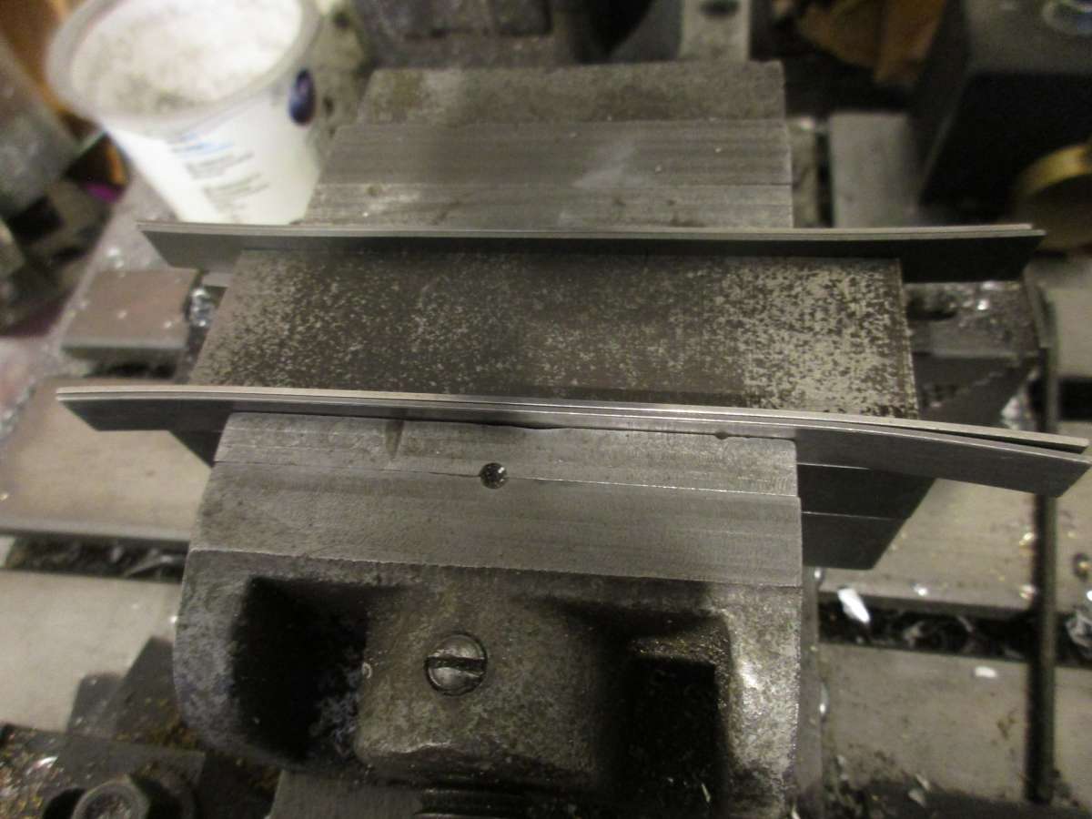

                              Hi, quite a few good tips in Joe’s vid Bill, I like the spring he made from a piece of pallet strapping, If you find that your parallels are too thick, and you may run into them while drilling close to the edges of your work, you can always put some packing stripes between the jaw/jaws and the work, to make sure the parallels are clear, as shown below.
                              springs#1
                              I’ve a number of these flat springs that have never been used, from my old job, which are just under 0.9mm thick, which I’ve used in the above example. I’ve used a couple of springs taken out of hand washing liquid soap dispensers, to keep the parallels pressed against the vice jaws.
                              springs#2
                              Regards Nick.
