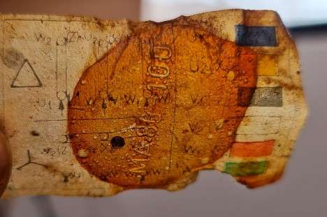

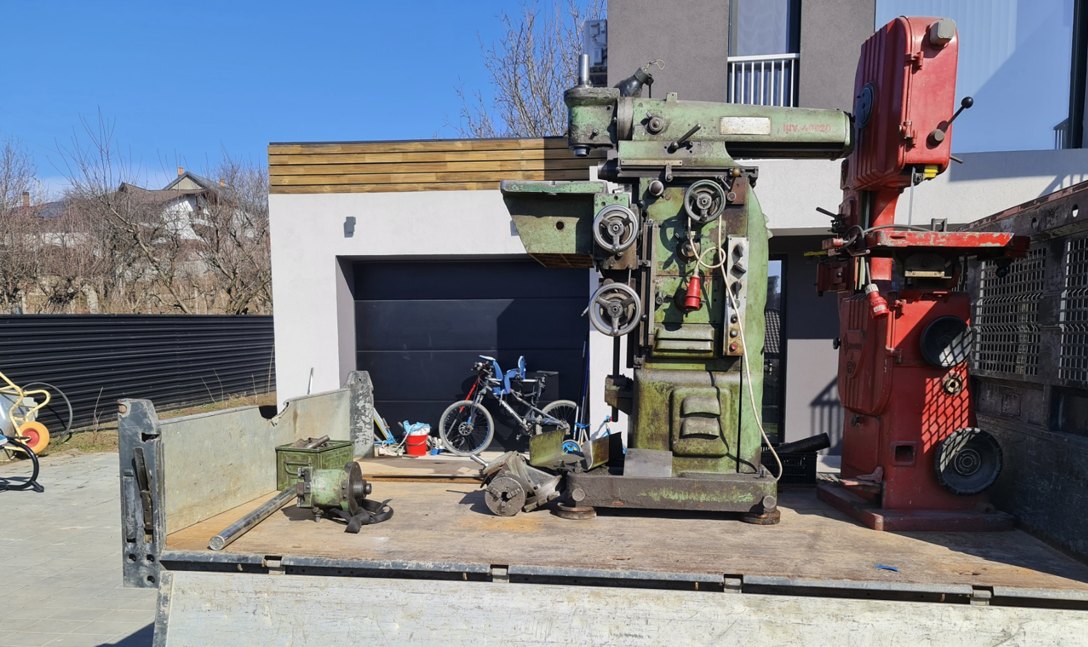

      Last year I bough an FUS250 milling machine. That is a Romanian made machine. It looks like a Thiel 158. Here is the whole story. Until recently I didn’t have time to try to fix it. But now I decided to start to restore it.

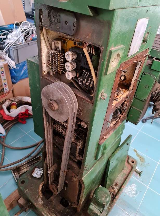

      The electric part looks quite old and for now I have no desire to check or fix it. For the start I would be happy only to run the spindle and to be able to manually move the table. I didn’t found its manual. I think I’ll order the Thiel manual. I plan to make a Y connection between the motor and the lathes VFD. Inside the motor box I made a useful archeological finding
      Screenshot 2024-02-24 160538
      So I’ll bypass all this ancient electric mess.
      Screenshot 2024-02-24 154548
      I can easily spin the motor by hand. The clone doesn’t have the original’s cone break. It should be no danger to use the VFD. There is no oil left inside. But I think this is not a problem for a few minutes.

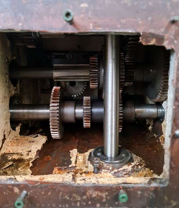

      Screenshot 2024-02-24 155327
      So far nothing runs smooth. The machine was not used in decades and the grease from the dovetails solidified. I think I have to make some kind of crane to disassemble some parts. Or for the beginning I could try to spay some acetone on the ways to dissolve the residues? Or WD40?

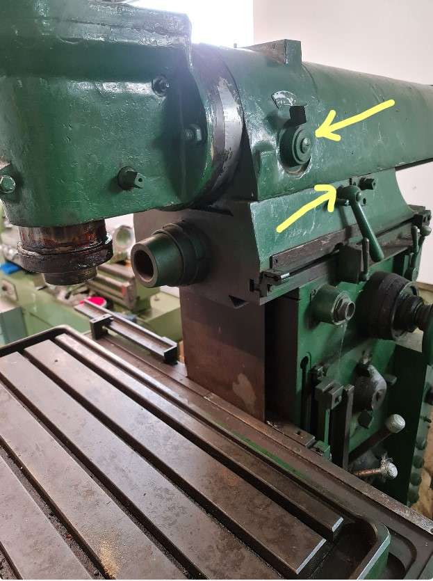

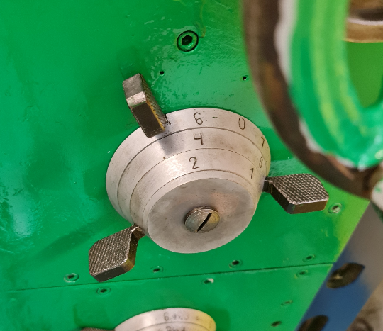

      Anybody has a clue about what this two levers are for? There are two sliding parts on top of the machine. So I suppose there has to be a way so select which one is moving when turning the wheel?
      Screenshot 2024-02-24 160125

            I think it’s possible that the uppermost slide / overarm is set manually and locked by that lower lever in your picture.
            The lower/middle slide is probably the one that moves by the handwheel.?
            Does the selector (yellow arrow) on the overarm / upper slide  engage / disengage drive to the vertical head?

              The label above the upper lever looks as if someone has painted over it. Clean that off to reveal whatever it says, and its purpose may be more obvious.

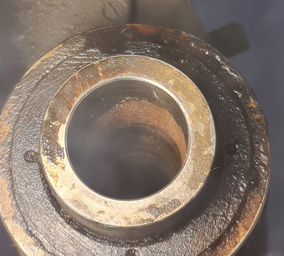

                I purchased the Thiel 158 manual and it is very helpful. The lever market by the top yellow arrow is disconnecting the vertical spindle. The horizontal one is always on. The lever indicated by the second arrow is locking the upper saddle. There is a similar one on the other side. Indeed the hand wheel moves both upper and middle saddle. I bought also a bottle of white spirit. It doesn’t evaporate as quickly as acetone.
                I cleaned the inside part of the vertical spindle. The bottom was full of dried grease. Unfortunately the part that was not covered is rusty…
                I measured the runout of the spindle on the inner surface. The part that is not rusted. The concentricity error is 3μm. I measured also an Aliexpress MT5 ER32 collet holder. Like in this picture:
                The runout was 9μm. Either the cheap collet holder is imprecise or the rusted area inside the spindle is ruining the accuracy. In the end I placed also an 8mm mill and I measured close to the collet. The error increased to 19μm. These are normal values?
                I also bought one more identical mill. Just in case. It looks like it was used a lot. But it is working.

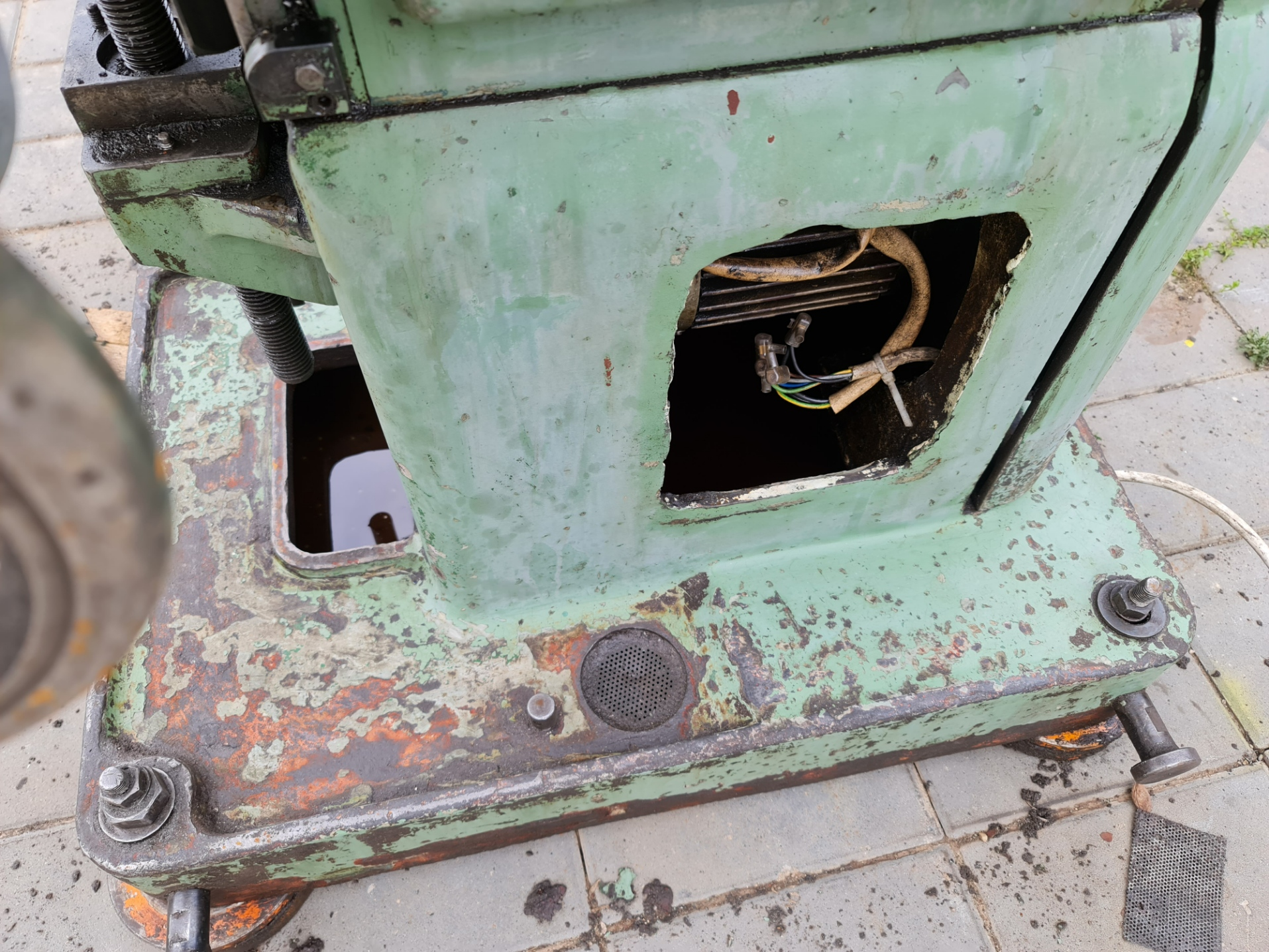

                  Any ideas how to remove the liquid from the base of the mill? It doesn’t have any evacuation system. There it is a mix of oil, grease, sodium hydroxide and who knows what. It looks like the basement of Chernobyl reactor 4.

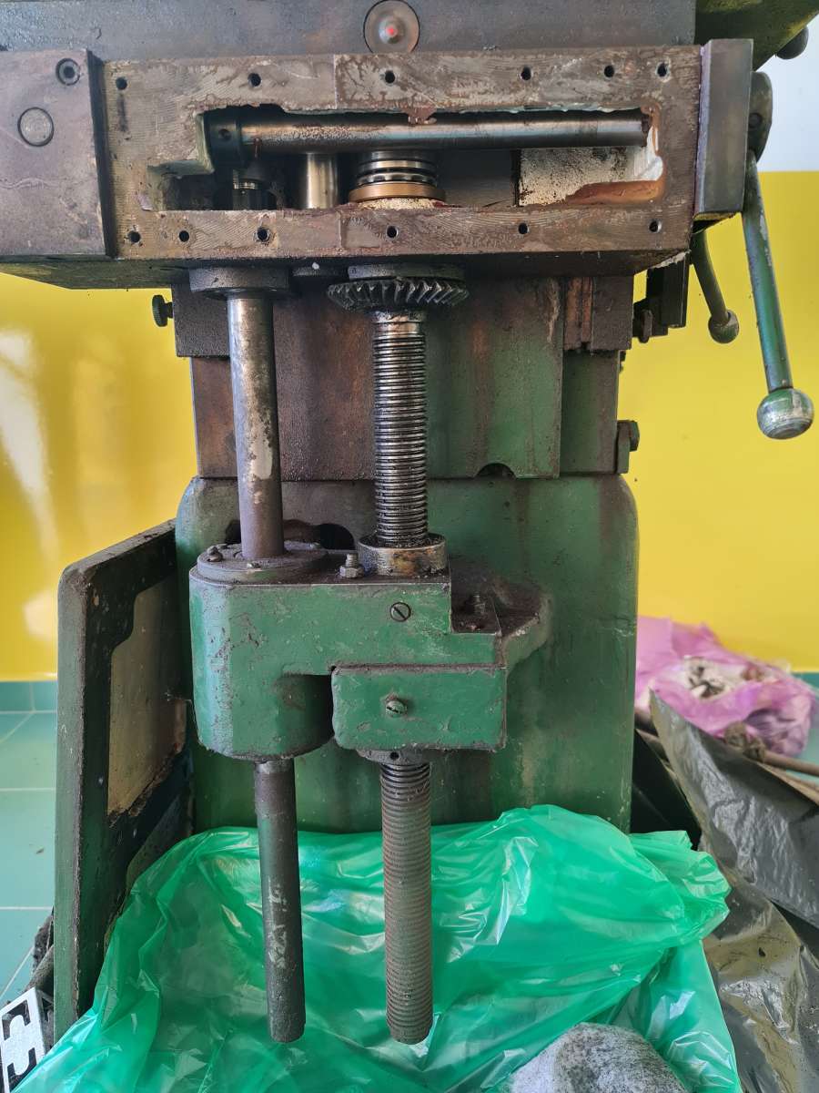

                    In the last days I made some progress with the mill. First I fixed the bent arbor for Z axis handwheel.

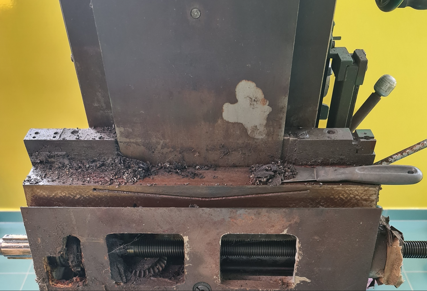

                    Next I cleaned the Y axis dovetail. The top of the machine was sliding only a few cm. It wasn’t used in decades and the oil or grease solidified. Now you can spin the handwheel with two fingers:

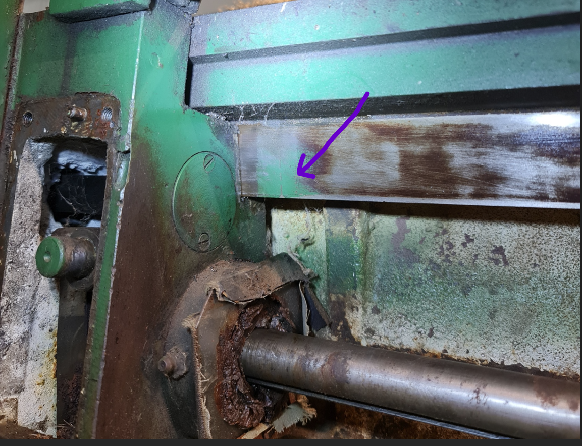

                    Next I wanted to clean the X axis that is also frozen. But this time it is not so easy. I think I have to remove the table and then the horizontal moving part to have a better access to the slides. Also I have access only to a small portion of the lead screw. It is also covered in a solidified lubricant. Somebody even painted them by mistake:
                    I have a workshop crane but I’m not sure how easy it would be to assemble it back. Those are very heavy parts that have to be aligned precisely.

                      Have a look at my FN22 restoration which is quite a long thread as it was spread over a couple of years but it does contain a lot of detail. Our machines are very similar so even though it won’t be identical work it will be along the same lines.
                      https://www.mig-welding.co.uk/forum/threads/tos-fn22-milling-machine-deckel-clone.117518/
                      If your table is not moving then you should loosen the tapered gib. Check if it has one adjuster screw on the fat end or one either end and don’t try to force it. The gib will be on the bottom way of that console table.

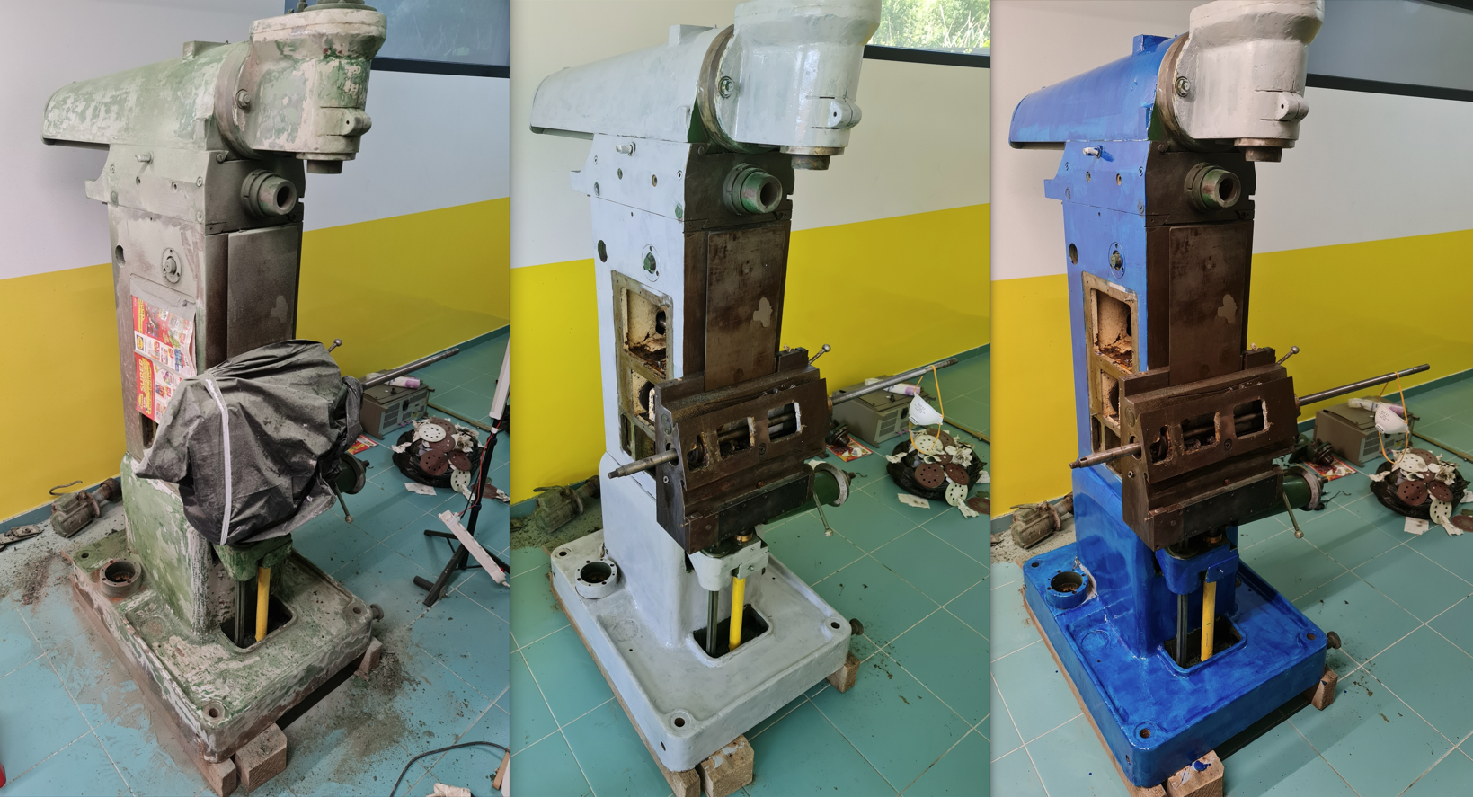

                                I removed the first layer of dark green paint with sanding discs. It wasn’t a stable substrate for additional painting. Now the whole workshop is covered with a thin layer of dust. I washed the mill with D509 solvent and then I painted it with a primer and a blue paint. Both are alkyd types. They dry very slow and have a strong smell but are much more durable. Another layer of blue paint is needed. Some parts I’ll paint them with yellow. I like the combination.

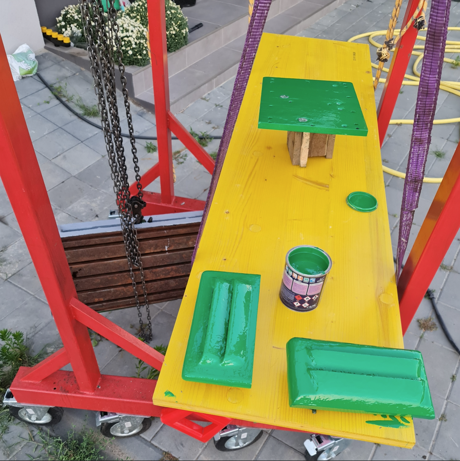

                                  Cleaning and painting all parts takes more time that I imagined. Almost daily I work on this and still I can’t see the progress. And I didn’t even start to work on the electrical part. Or to fill with oil the 2 main oil baths. Also I realized that the whole garage is full of dozens of small parts and I’m not sure I know how to assemble them back in the same order. I never disassembled something so complex and it didn’t crossed my mind to keep some records.
                                  My workshop crane turned out to be a multipurpose tool. Now I have a table on wheels to do dirty work outside. And I can easily move it back when it starts to rain. I found a better paint. The blue one I used for the mill body required 3 coats. With this green one only one layer is enough. It is made by the same company that makes Hammerite. But is half the price. And is quite hard after a few days.
                                  I bought some super cleaning solution. It contains Sodium hydroxide, phosphoric acid, paint stripper and a many more serious chemicals. With a ton of warnings of course. I let some parts in for 2 days but I was not impressed by the results.
                                  I still had to clean the dried grease and paint

                                    Good progress though despite the battles with the gunge!
                                    Sodium Hydroxide and Phosphoric Acid… Alkali and acid. Interesting blend – I wonder how they don’t neutralise each other?

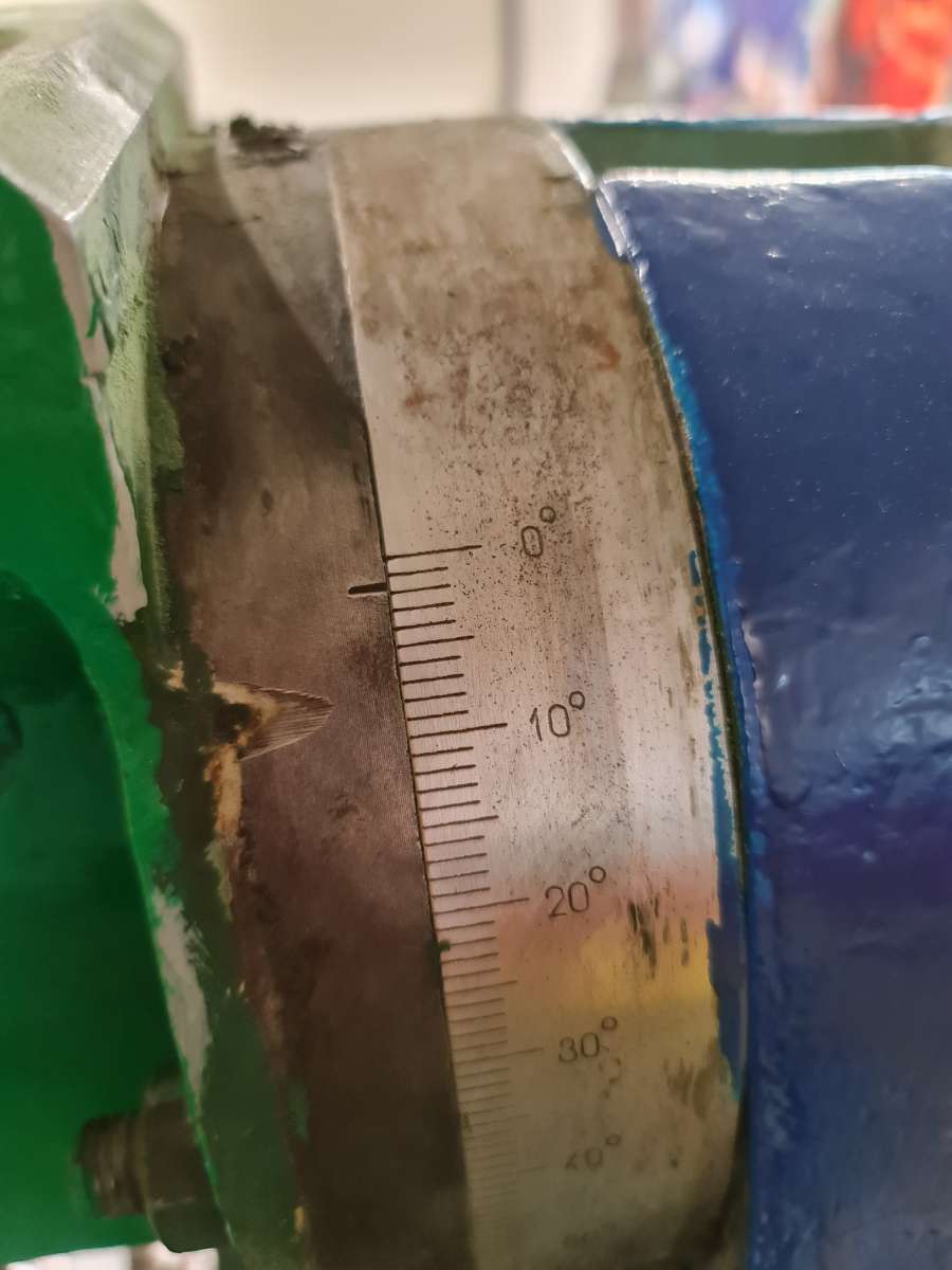

                                            Does the head need aligning – looks a bit like the spindle is at ’25 minutes to 1′ even in the photo.?

                                              Yes, you are right about the head alignment! I didn’t notice this. I just cleaned the spidle ring with acetone and under the dried grease I found an alignment mark.
