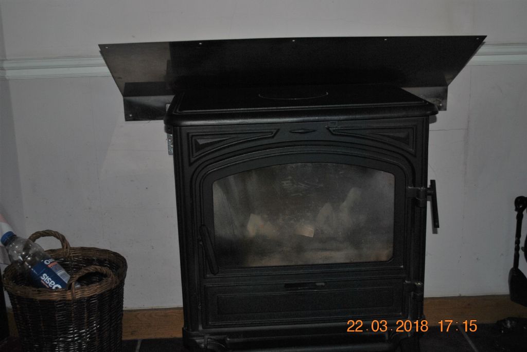

                                    If your wood burner projects from the fireplace a bit then the problem could simply be the heat from hot air rising up the face of the wall. Plasterboard with a skim coat of plaster is no good as the skim coat will just crack. Plaster on brickwork will do the same even if it is bonded to stainless steel lathing.
                                    There are a couple of options.
                                    One is to remove a 4ft wide section above the fire ( assuming that is the width of cracking) & place Fermacell board on some fire resisting expanding foam. Support it in position until the foam goes off then plug & screw the board to the wall. the board, being 2400 * 1200 * 9mm th will be storey height & should not expand & contract too much. Feather the vertical edges & tape & joint this to the surrounding plaster . You could cover the joint with a bead like a vertical dado but this would look a bit "pants". Emulsion over the board after sealing it with an approved sealer first.
                                    The other option is probably the best & was my solution as I found that the heat from my wood burner actually started to blister the paint on the dado & severely crack the skim coat on the plasterboard above.
                                    I found a stainless steel mirror & bent it & fixed it to the wall as a deflector, I promised the wife 12 years ago that I fully intended to finish the job & form a "P" shape to form a stainless steel mantlepiece. Somehow I do not seem to get round to it . It is removable for the summer & every winter when she fits it back( Notice the "she fits" I get an ear wigging !!!!
                                    see picture
                                    Now I am sure that your other half would not let you get away with that & if she did you would not want the grief i get but you could try a nice mantlepiece that projected a good 9 inches with bracketed ends. This could have a stainless reflector under it for the winter if you fabricated a couple of clips. You can get stainless steel mirrors online which are nice & polished. It just needs something to reflect the rising heat away from the wall. The dado & wall above is quite cold & the heat does not pass through the reflector at all. The wallto the right hand side (can be seen in the picture) has recently started to crack & will be sorted when the house is decorated this April. No cracks whatsoever above
                                    fireplace
                                    If you are not sure then it is worth just filling the cracks for now & installing a plate deflector like i have & see if it works. It is a cheap option before you start blowing cash on major repairs that may not be needed.
                                    But do not leave it 12 years like I have !!!!!
                                    Edited By Sam Longley 1 on 22/03/2018 19:31:03

                                          Yes good point Sam your woodburner looks to be set rather close to the wall and maybe that is a factor with Dave's installation also – I would normally look to keep them a minimum of 400mm from the wall or back within the old fireplace. Anything within 600mm will be prone to heat damage which is why traditionally fire surrounds are of material unaffected by heat (brick or stone)
                                          I can well imagine that this winter many homes will have roared their woodburners up much harder than normal, but some people do this from time to time to burn the soot out of the flue. My friend who has been involved with woodburners for 40 years has always advised us to have solid flue for the first 1.8 m as flexible liners do not like such intense heat. This might be erring a bit on the safe side and allowing for unreasonable use (I would think 1.5m sufficient) but it is based upon his real life experience and gives a clue about flue temperatures!
                                          I have a very small woodburner in my workshop and keep an oil filled radiator 400mm to one side of it as a heat baffle and another 300mm between that and my nearest machine tool (Cutter Grinder). Even with this the grinder gets quite warm despite the fact that the woodburner only gets used lightly – mainly to use up wood offcuts from the workshop which I save up for harsh weather.
