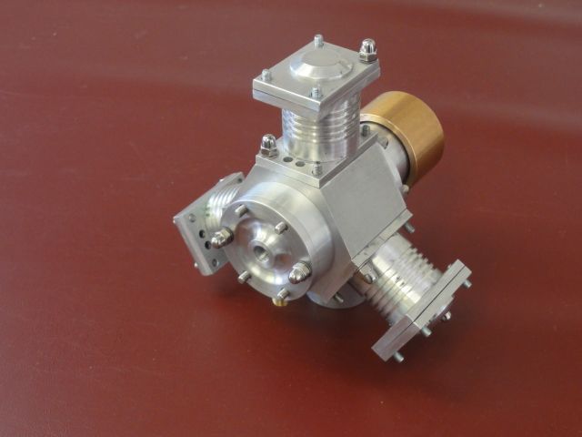

      Jim Nic
        @jimnic

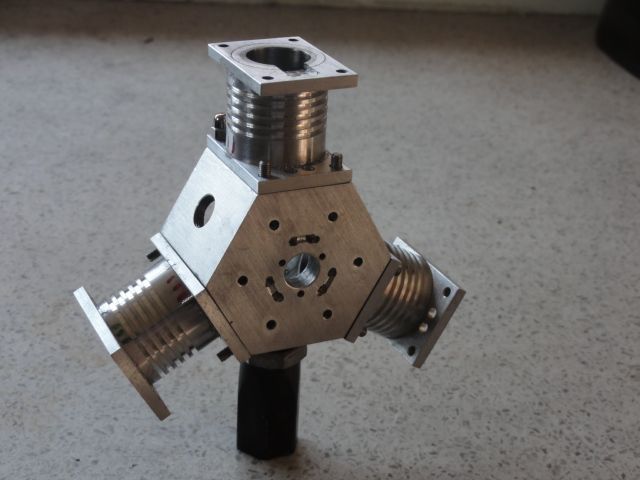

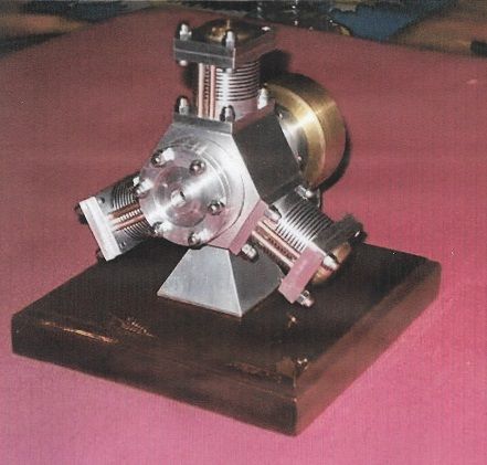

        Afternoon all
        I’ve been diverted from modelling, and posting, for the last year or so by other things but I’m hopefully free of all that for the time being.

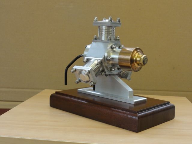

        My current project is Stew Hart’s 3 cylinder radial, here’s a picture of Stew’s finished original:

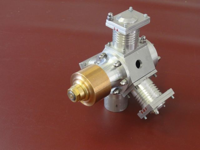

        My last posting on the subject included this picture of my crankcase and cylinders:
        I am now at the stage illustrated by the following:

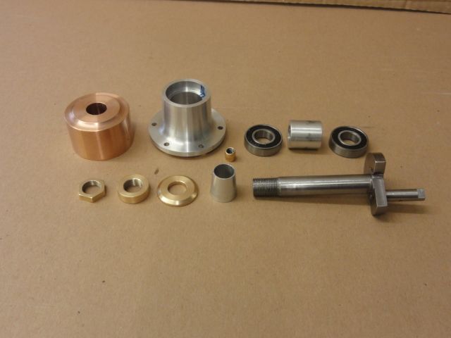

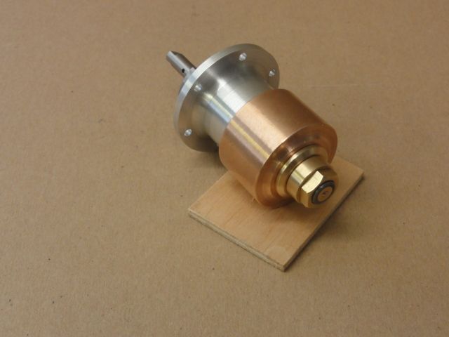

        The crankshaft bearing housing and flywheel parts:

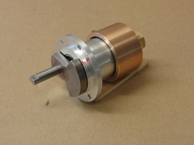

        and assembled

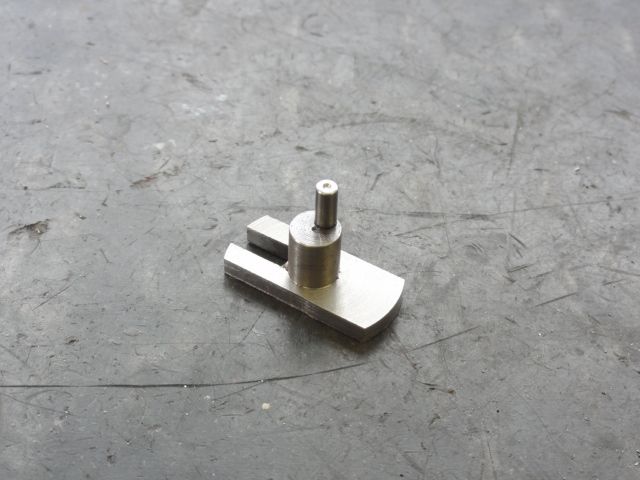

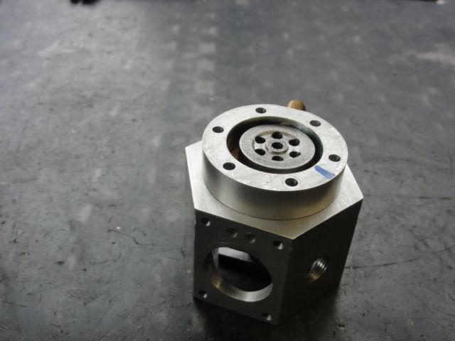

        The return crank which is driven by the crank shaft, protrudes into the valve chest and turns the valve:

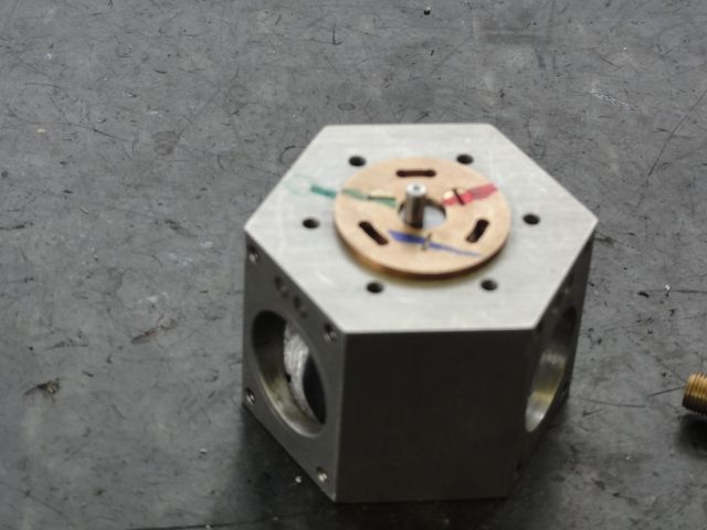

        The port face mounted in the crankcase and showing the return crank
        The rotary valve
        The valve in the valve chest

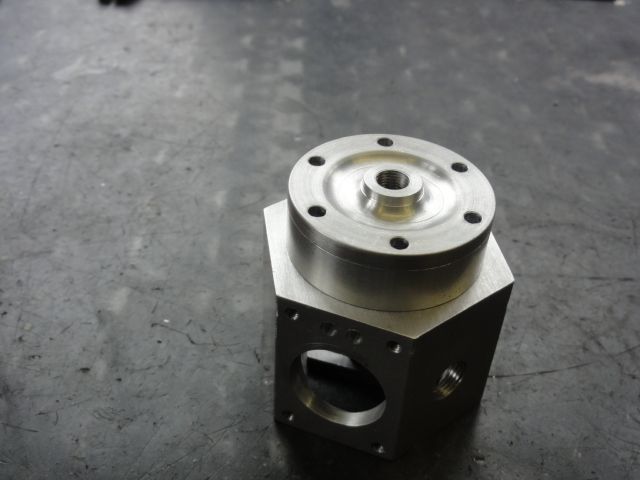

        Valve chest cover on
        And finally a cpouple of family shots of where I am today
        The engine is, in my humble opinion, looking OK but there are few"innards" in it so next are some pistons and con rods, then the air feed pipe and transfer pipes, crankcase breather, and a stand.

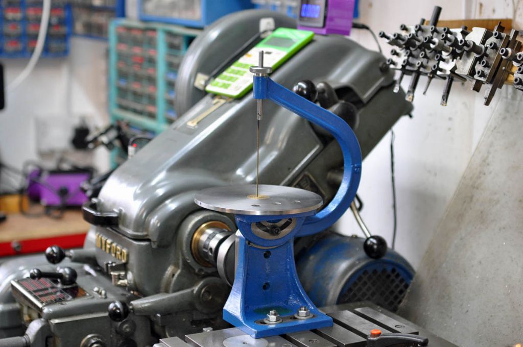

          Rooossone
            @rooossone
            Posted by Roderick Jenkins on 05/03/2023 20:33:02:
            I've spent the last couple of weeks making the ETW/Hemingway Die filer
            I was actually more interested in the jig sawing capabilities
            I think it is about time that I considered actually using my carefully hoarded Abrafiles and make an adapter for the filer bow.
            Rod
            I am adding this high up on my project list. Thank you for that Rod.

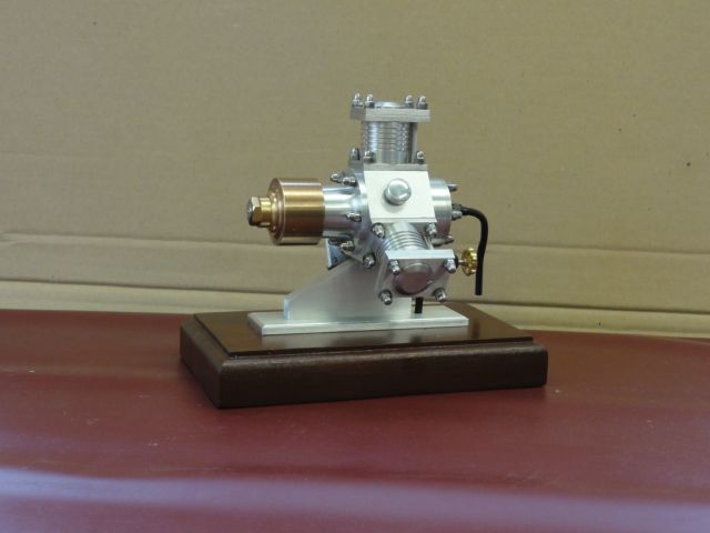

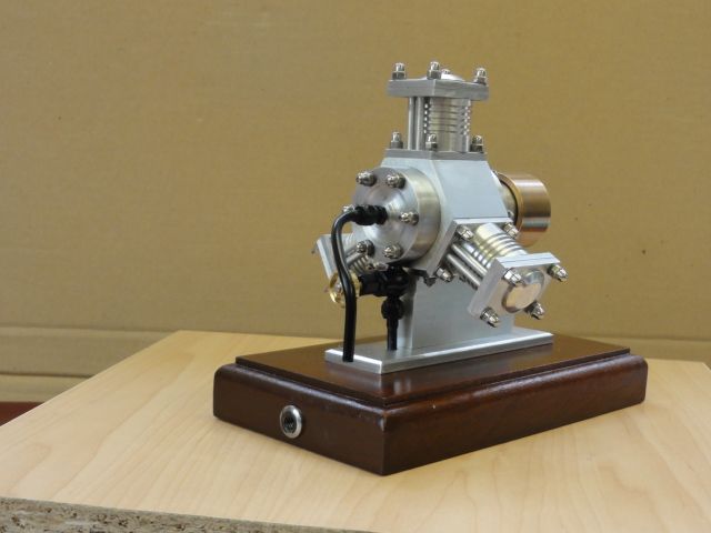

            #655257
            Jim Nic
              @jimnic
              Afternoon all.
              Contrary to my hopes, life got in the way of my modelling efforts again and it is only today that I have completed my Stew Hart Radial engine.
              It runs smoothly and quietly but I haven't bothered making a video because, unlike most of my other models, there isn't really anything to see different from the stationary engine.
              The interest was in the building, which I found challenging, and the satisfaction of now having single, twin and now 3 cylinder engines in my collection.
              Jim

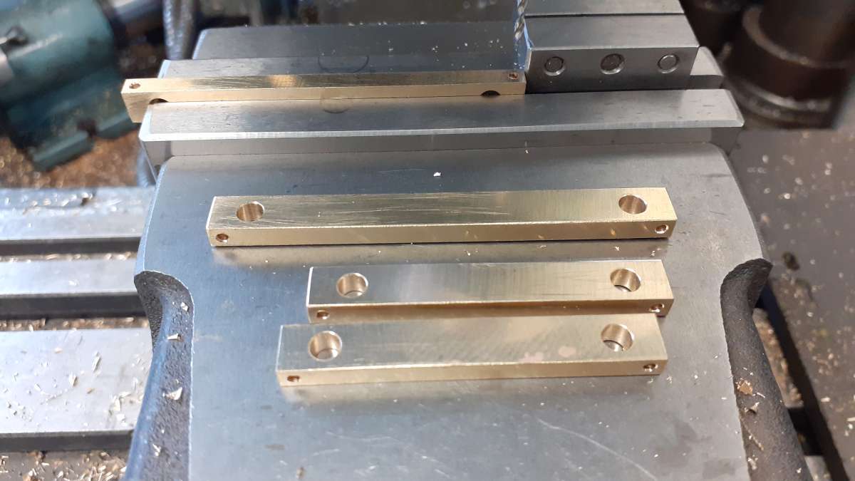

                  #684066
                    Someone posted about getting this thread upto the top of the list, all it takes is for members to post what they have been upto.
                    I know it was the old excuse that it’s too hot in the workshop but surely somebody has done something since 6th August, get it in quick before it becomes too cold. More posts will keep it at the top of the useless list.
                    Did this pivot bracket for my Denny Improved hot air engine today, just needs a bit of softening up around the edges.
                    20231028_170059

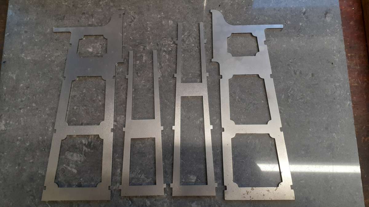

                        Works continues with the Denny, these laser cut parts arrived in the week from Lasermaster – 2.5mm CR4 steel.
                        20231125_081611

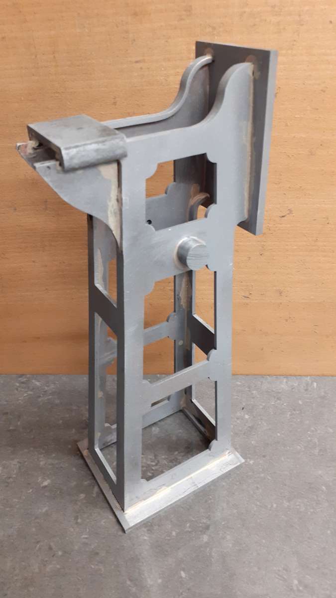

                        A few more bits of steel were machined up and then it was time to stick them all together. The curved braces to the upper left were Sif brazed on first then the whole thing wired together and done in a single heat with silver solder. I started with the flat vertical flange then worked my way down each leg, feeding the stick of solder into the internal corners and watching as the molten blob followed the heat down the leg, finally did the bottom flange. Then pickled for 40mins
                        20231203_104724
                        Very pleased with how it came out, almost zero excess solder to clean off the had to get to inside and just a bit of filing to clean up the corner joints followed by blasting.

                        Diogenes
                          @diogenes
                          What burner / torch set up did you use for that? (how tall is it ?about 150 -180? mm?)
                          Pretty sure it would have looked a bit ‘saggier’ if I’d done it..
                          #697135
                            Sievert with the standard 28mm burner which is about 7Kw
                            It is just enough to do the Sif but copes easily enough with the silver solder. It is usually brass and bronze that you have to be careful of a sthey can distort particularly if you are using clamps etc to hold things together while soldering.
                            220mm tall.

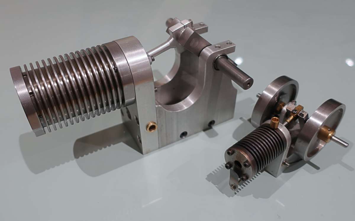

                                @diogenes
                                I have finally finished lapping the cylinder and piston for my Big Poppin’ engine – that was a learning curve too – I thought I was a dab-hand at smaller ones but a good shape and finish on a 33mm x 75mm cylinder doesn’t come quite so easily; still, that’s the worst part of the build out of the way, the rest will be a doddle, I’m sure…
                                Imagine a picture here..

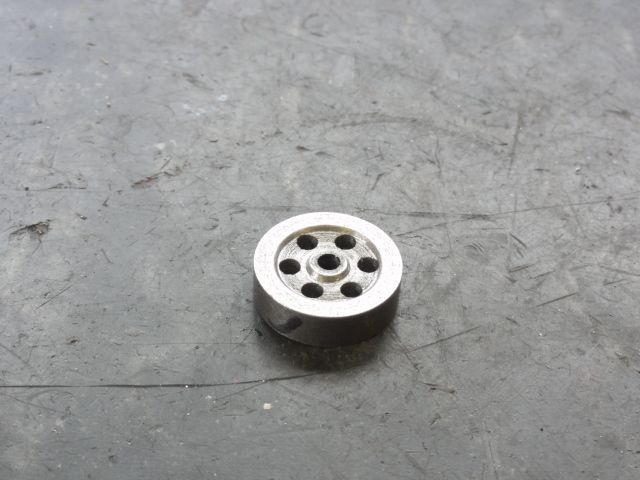

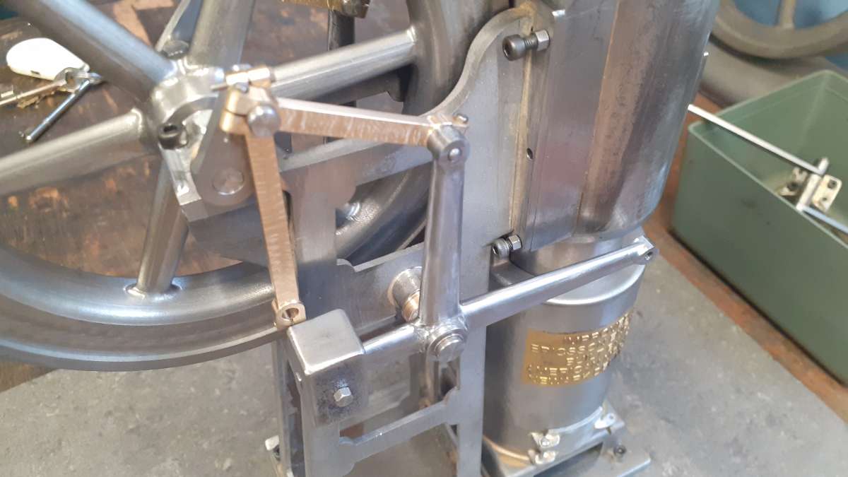

                                                  And now it’s my turn to show what I’ve been upto over the last week or so.
                                                  Started with some bits cut from 180 x 8 S275 structural steel flat, which were silver soldered together before shaping
                                                  20231223_083610
                                                  Chopped up some old basin tap parts and drilled & reamed a few holes before further shaping.
                                                  20231229_143130
                                                  Threw in some pivots turned from 6 & 8mm leaded steel and how my Denny has a few arms and links even if they are  abit out of focus
                                                  20231231_135714
