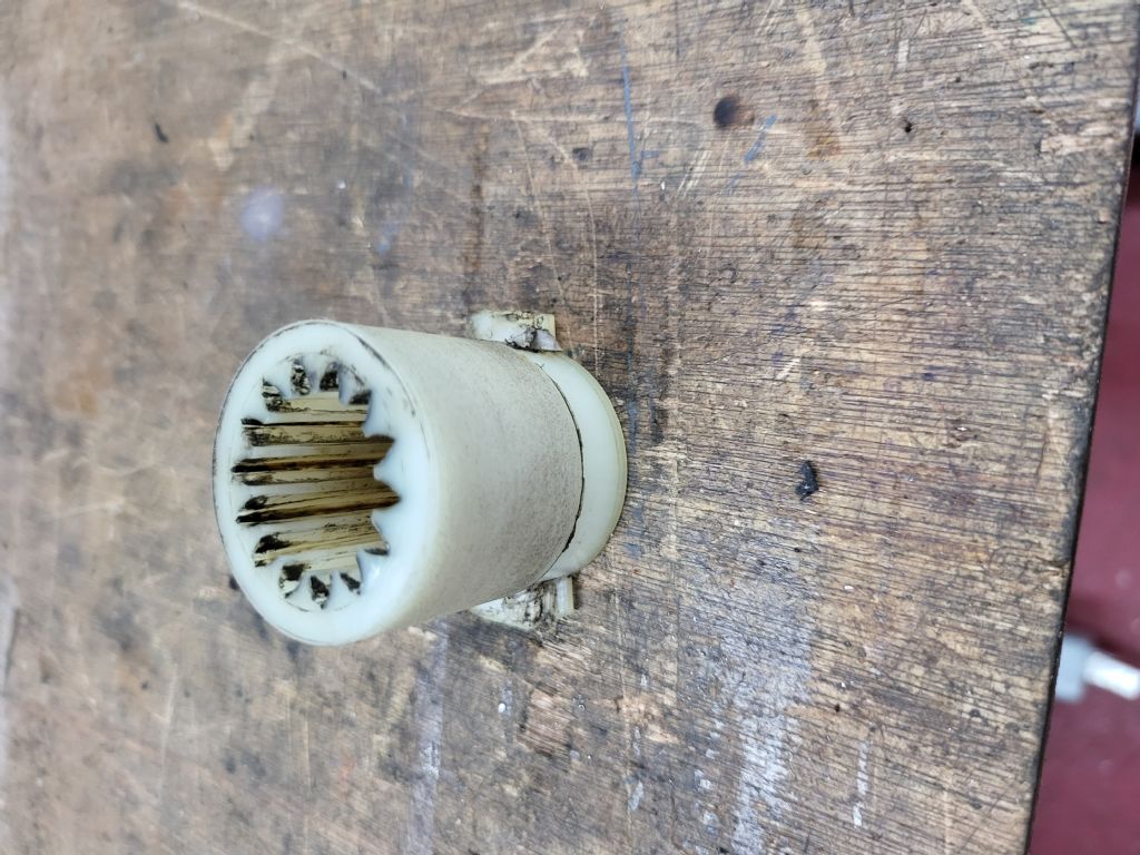

            So I lost the spindle drive on my Omnimill. Stripped the pulley section off to find a worn out drive dog that doesnt exist on the parts list I have.

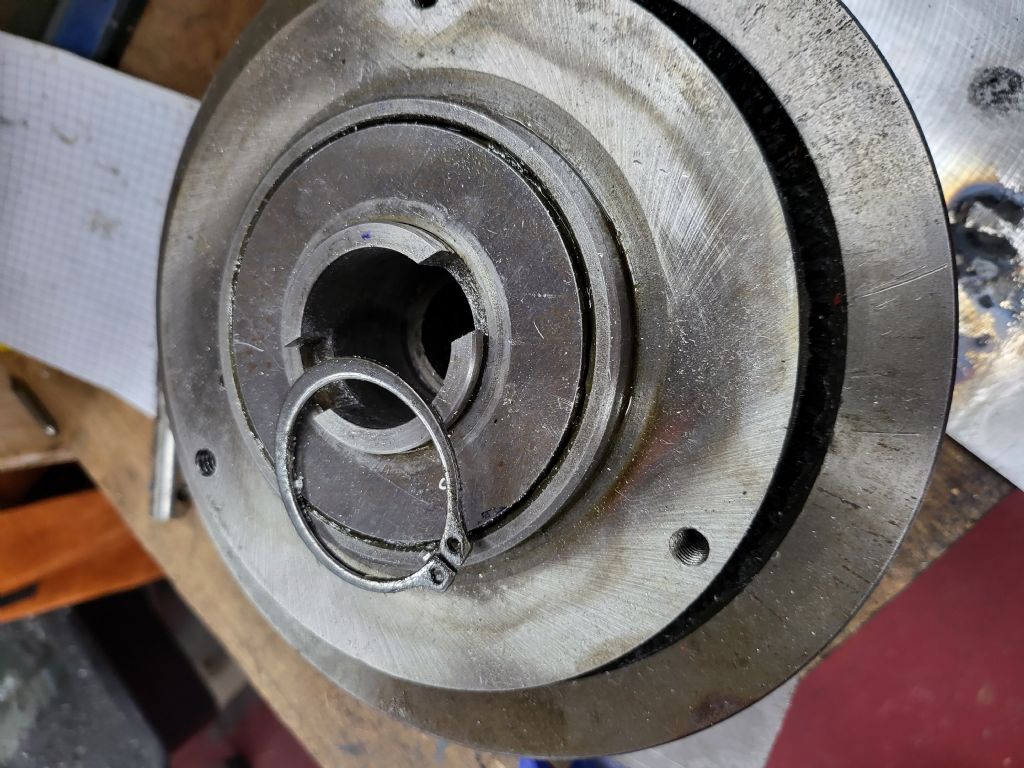

            The drivre dog lives in the inside of the top pulley assembly.

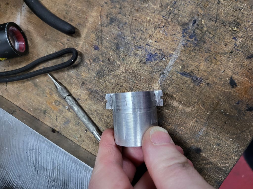

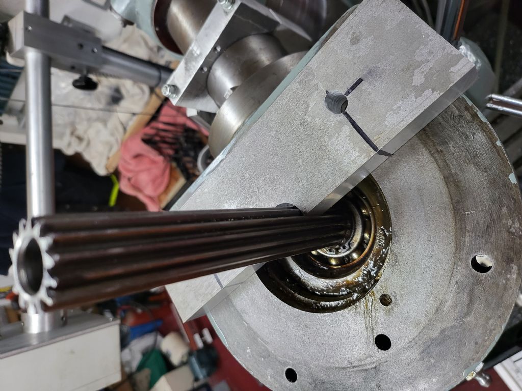

            Decided to have a go at making a new one from aluminium so made up a broaching bar and ground down a bit of HSS to match the spline shape. Made up a clamp of sorts to prevent the spindle from turning.
            The hole on the aluminium plate was drilled off centre to allow the edges to fit into the splines and stop the shaft from rotating to allow mw to cut the new splines.

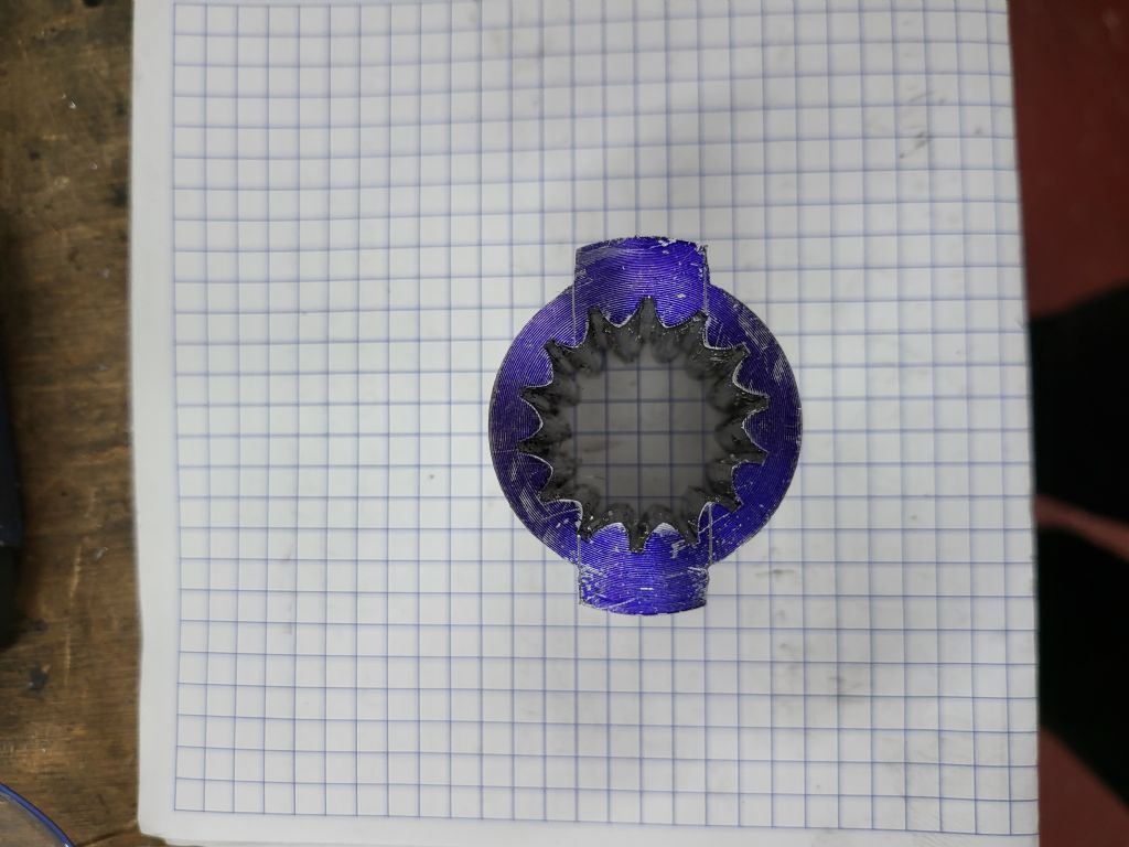

            Carried on and cut the drive dog not realising that the cutting tool was slightly off square to the drive dog so the splines are a bit wonky but it still fits and works ok.
            Cut the groove in the drive dog to allow it to be held by the same circlip that holds the bearing cover plate in place.
            Greased up the bearings while it was apart and fitted the new drive dog and all is well again. First spline I`ve ever cut and happy that it works besides being a bit off.

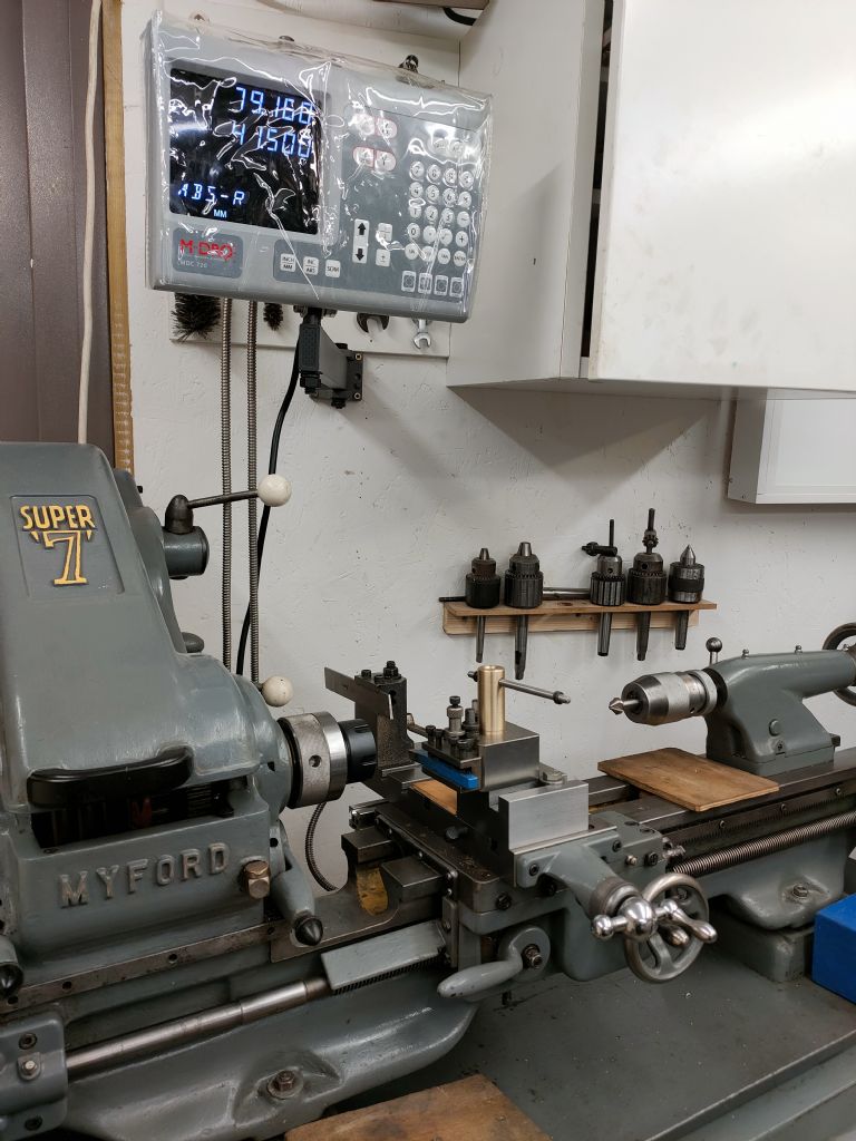

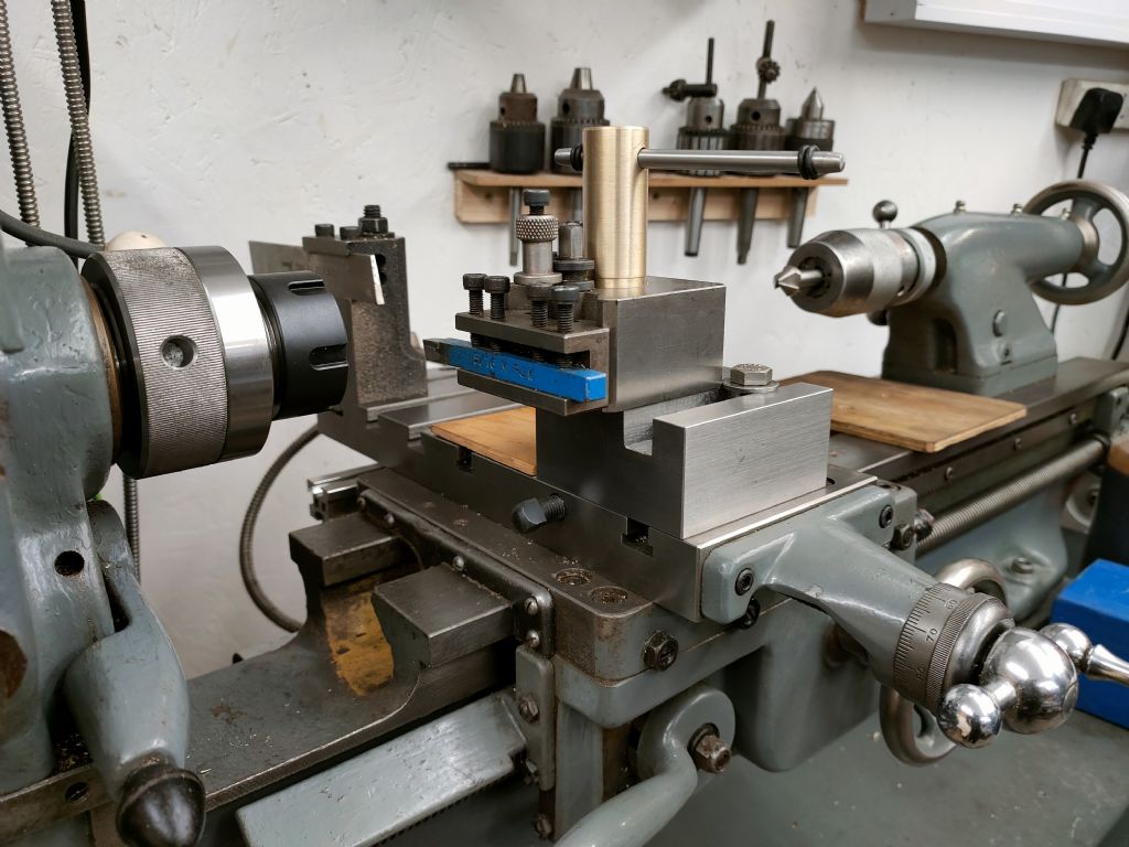

                In the pursuit of better accuracy and to follow on from the recent DRO, I fitted a ER32 chuck and a solid tool post in place of taper turning slide.
                I discovered more gaps in my knowledge…
                7mm twin flute still got pulled down in an R8 collet – which had been tightened this time. I'm not sure what an appropriate depth of cut/speeds/feeds is but I know it I took too much.
                I can't power-tap M10 or even M6 in steel. If I hold tap in chuck then either tap spins in chuck or chuck spins on arbour. I will get a new sharp tap that fits a collet and give it a go.
                I fitted the ER chuck with less than .01mm runout measured on the body, but 0.05mm on the taper. After skimming the taper I got it to less than 0.02 which will do for now until I feel I know better what I'm doing (the cutter was screeching which suggest something wrong) . Putting a 10mm mill in a collet gives .06mm runout – a little from the mill, but most from the cheap collets (cheapest set available). I will get a few better quality collets in specific sizes.
                The 63mm shell mill I got for Christmas works a treat. Makes me think I should have gone for 80mm.
                DRO is brilliant.

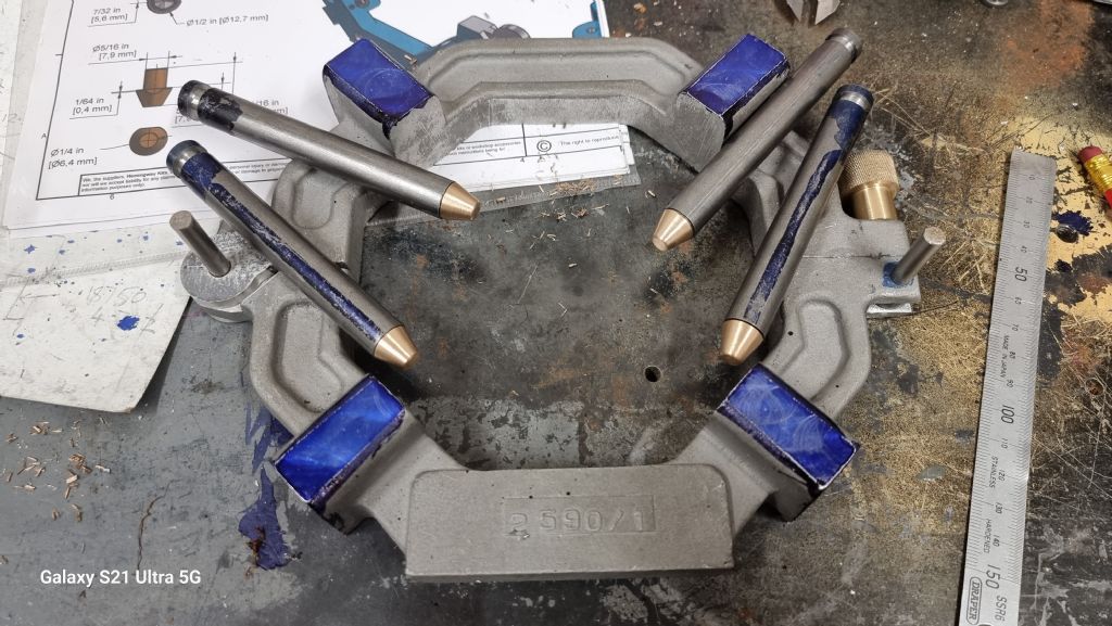

                  Got some more done on the Hemingway Kits large bore steady rest.
                  Made the Phosphor bronze fingers & pressed them into place.

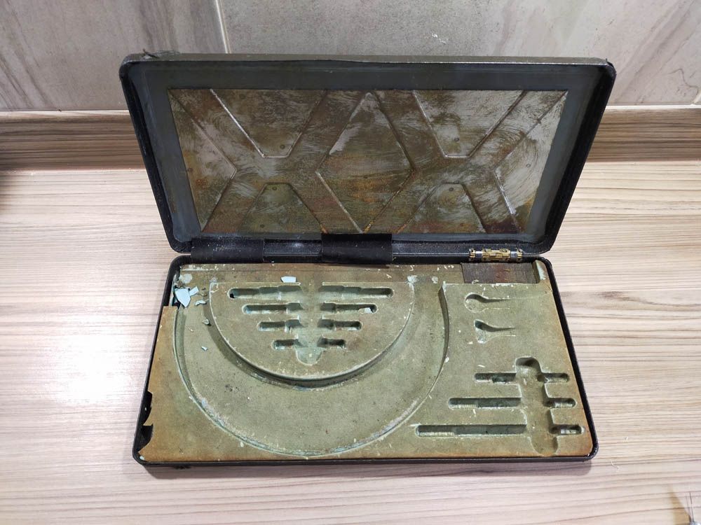

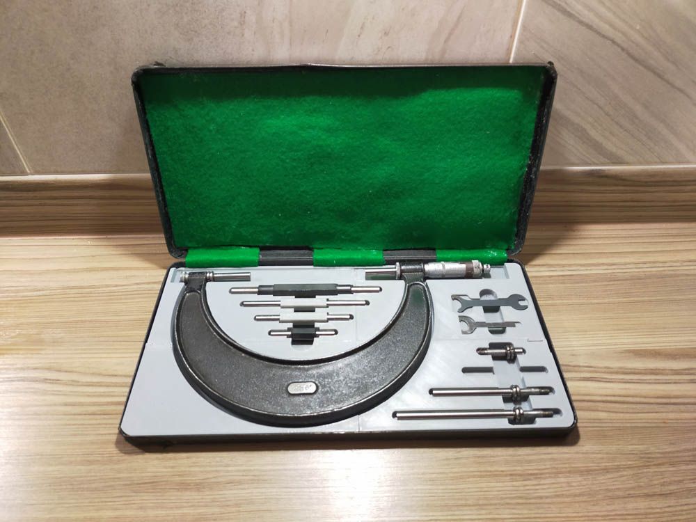

                    I was fortunate enough to be the only bidder for a 2-6" M&W micrometer on ebay. The blown plastic case liner is in a bit of a state

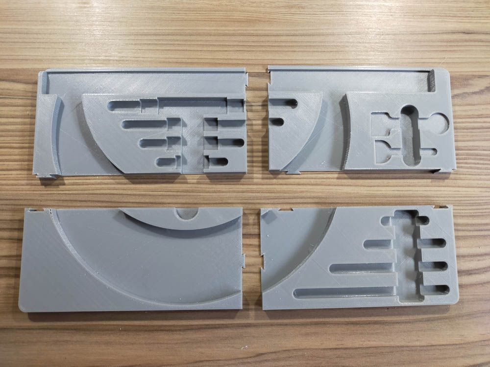

                    My 3d printer is not big enough to print the whole thing, so divided into 4 bits
                    Not sure now about the felt pad in the lid – might harbour damp. 2 of the collars for the standards where missing so I have printed those from PLA. The originals are rubbery so I will have a another go with TPU though not confident of success.

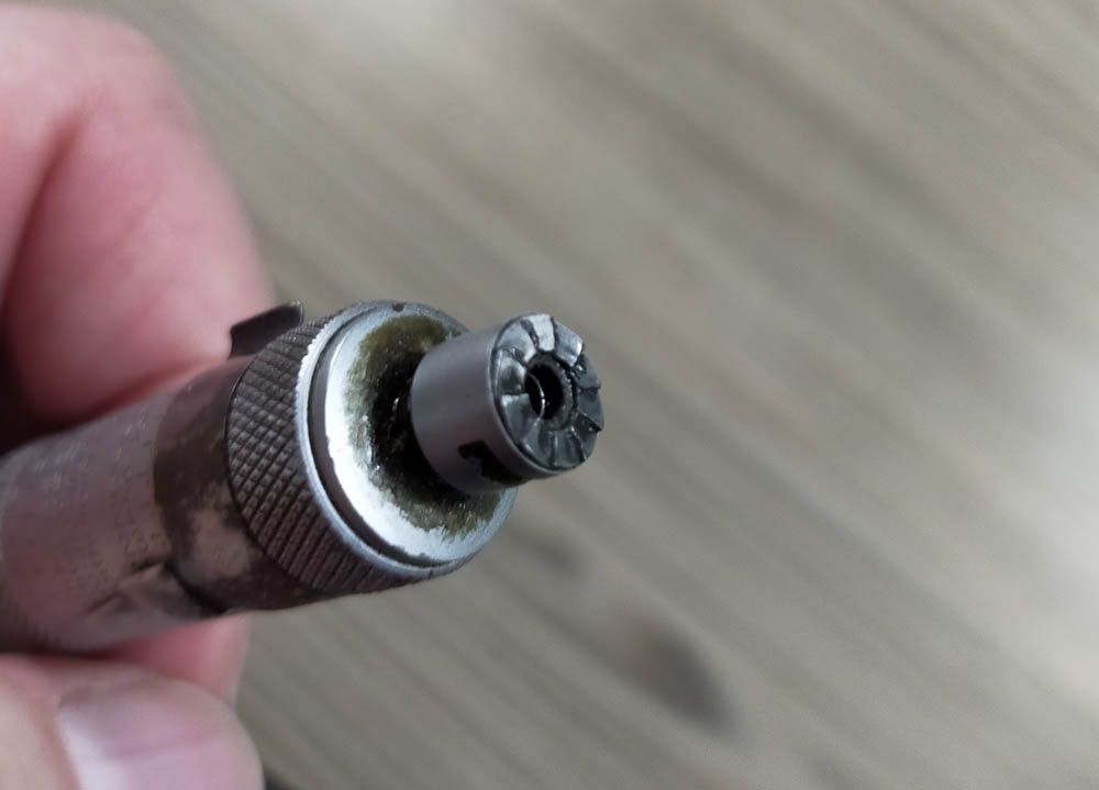

                    The ratchet thimble is missing from the micrometer head. Although I never use it, I feel it ought to be there. I guess I will have to make a matching ratchet to this

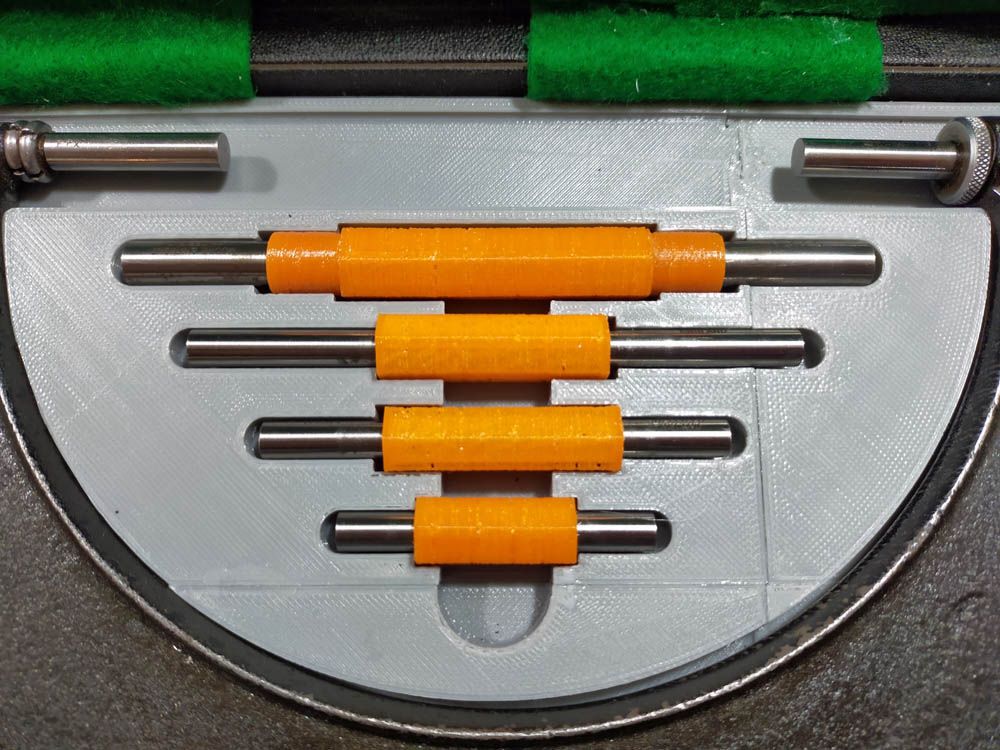

                      That went better than I expected
                      The 2 original black collars were both loose so I printed all 4. Took a few attempts to get the TPU parameters (nearly) right. I think my filament may be a bit damp but I'm happy enough with the result.

                        Looks like a nice job Roderick. Should last for many a year. The other half keeps on at me to get a 3D printer but I have resisted so far.

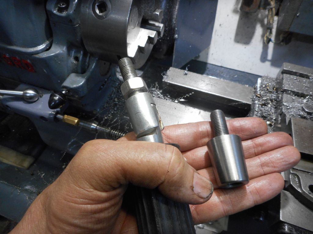

                          There is a first time for everything. Making the tapered footpeg spacer block for a motorbike project, I knew I needed the taper to go from 1" to .880" over a distance of 1-1/4" but did not want to stop, wash my hands and either do the trig or look up an online triangle calculator to set the topslide angle. or set up a dial indicator to set it up on the job.
                          So I turned the first 10 thou on the end down to .880 diameter and then set the top slide angle by eye, just guestimating from the edge of the topslide vs edge of the cross slide that it seemed to taper about the required .110" over about 1.25". I figured I would adjust maybe once or twice as I went, in order to get the dead correct angle. Near enough for a spacer hidden away under a greasy motorbike anyway.
                          But blow me down, it worked out PERFECT and I mean perfect. The tool just kissed the .880" step at the small end on the start of the final cut and the cut ran out EXACTLY at the other end of the section. It'll never happen again. I should have gone straight round to buy a lotto ticket.

                            Looking good Stevie. What diameter are those steel fingers? And about how long are they? I might get around to making my own fabricated knock-off sometime.

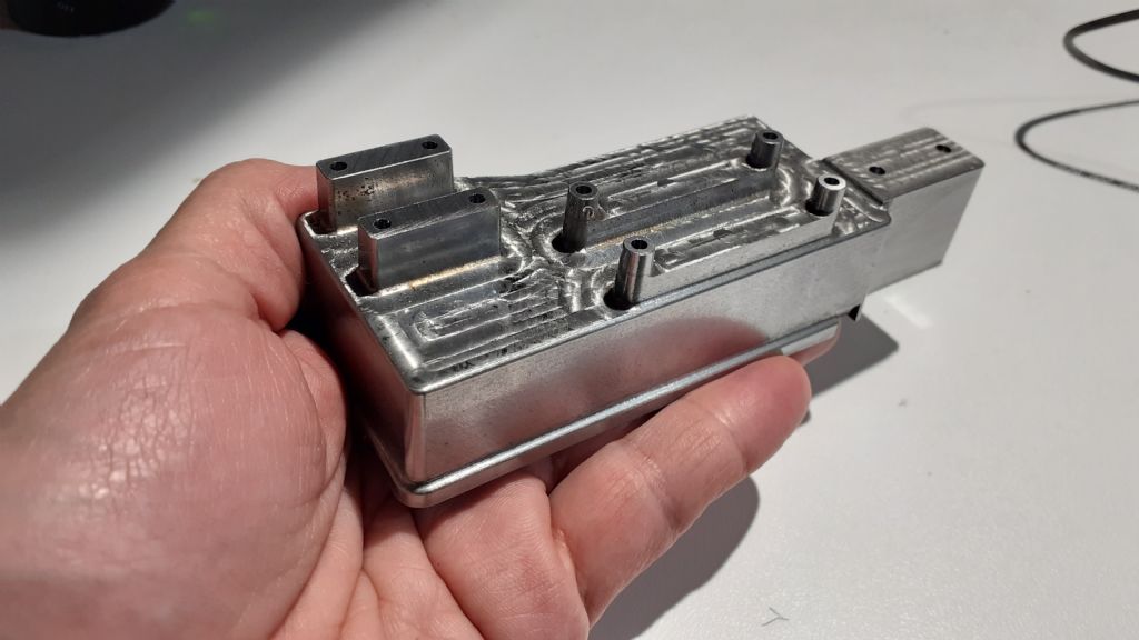

                                        What's that they say about one in the hand?
                                        A little something to produce some swarf while the paint on James Coombes II is drying. Still needs a second setup to get at the underside of the bit on the right.
                                        Can you tell what it is yet?

                                          Hi Hopper. The complete build is here part 1 of many. If you find it a bit boring just skip through. It turned out fantastic. Already used it on another project & I'm sure once i get used to it then a bonus for the workshop.

                                            jason is it the base for a horizontal steam engine
                                            #633477
                                              Yes but do you know which one?
                                              #633479
                                              gary
                                                @gary44937
                                                ha ha no i dont know and miss googles images page doesnt either
