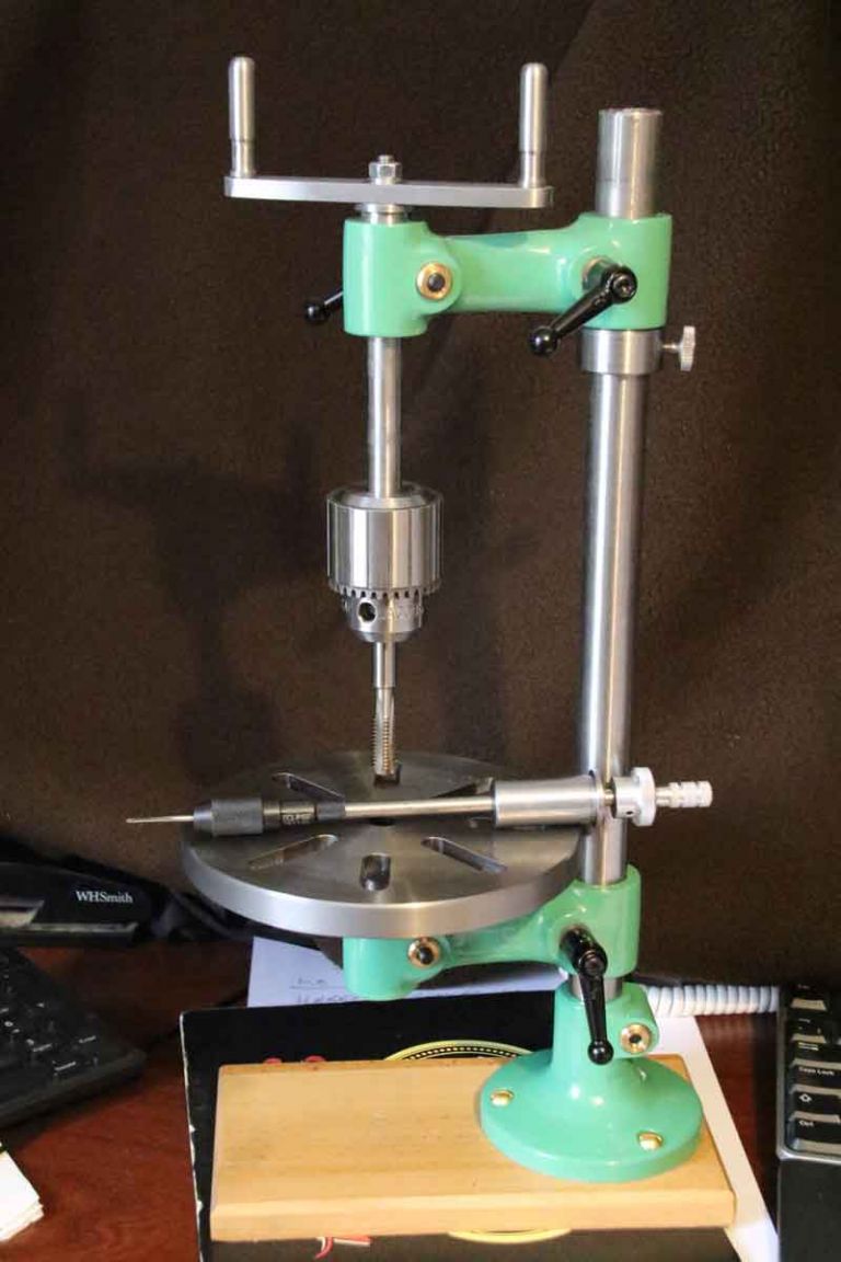

            I bought and started restoring a huge ratcheting arbor press about a week before the world went into meltdown, unfortunately it has sat there untouched since, I decided to make a start on finishing it earlier, just finished welding up a subframe with wheels that sits inside the base, with adjustable feet under the original bolt holes, it weighs I'd guess in the region of 250kg, hopefully should have it finished within the next week.
            R.press
            R.press

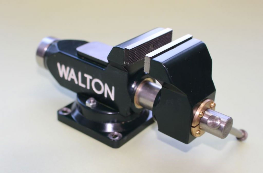

              GoCreate
                @gocreate
                Just finished my 2" Baby Bench Vice build, Finally a nice little quality bench vice. I based it loosely upon the 'WILTON' design popular in the USA. An interesting and worthwhile project.
                baby vice.jpg.

                #529212
                Pete.
                  @pete-2
                  That's very nice Nigel, is your surname Walton?
                  #529216
                  Dalboy
                    @dalboy
                    Posted by tractionengine42 on 21/02/2021 19:37:02:
                    Nigel
                    Have been watching the build on this looks a great little vice. Now waiting for the next part

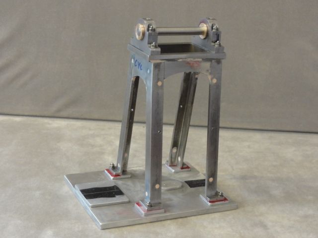

                    Jim Nic
                      @jimnic

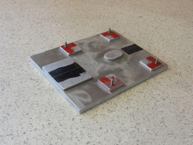

                      For the last couple of months I've used my workshop time to set about my version of Neil Wyatt's Norden engine design. I say my version because firstly the castings that Neil used seem to be no longer available and secondly I like to work in metric measurements and the drawings I have are in imperial units. Following advice from Jason B some time ago converting from imperial to metric was straightforward by taking 1/32" as 1mm.
                      The original:
                      My engine will thus be slightly larger than the original and made mainly from barstock; the exception being a cast flywheel.
                      First off was the base, a simple aluminium sheet with mounting pads Araldited in place:
                      Then the frame. The trickiest bit for me, silver soldering the angled legs to the table was always going to be a challenge but it turned out OK. Still to add the trim strip around the inner faces of the legs:
                      Then the crankshaft bearings:
                      Finally for now a family shot of progresss to date:
                      Next job will be the cylinder.
                      Jim

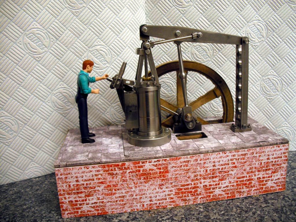

                        Anthony Knights
                          @anthonyknights16741
                          I have now finished making enough components of the Stewart Hart beam engine to be able to fix them together to see what it looks like. (Impatient person that I am). Made a rough looking flywheel from MDF just to get some idea of dimensions when it came to making the plinth. There is still quite a bit to do, but I've already got a little guy to operate it when it's finished.

                            Anthony Knights
                              Hi there Jim. For the flywheel, I can either buy a suitable slice of cast iron or steel and machine from scratch, or buy a laser cut blank. I have not decided which to do yet.

                              mechman48
                                @mechman48
                                Hi Jim
                                What scale is your figure?
                                George.

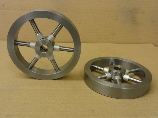

                                duncan webster 1
                                  @duncanwebster1
                                  This was supposed to be made from a slice of thick wall pipe, but the chap who had offered to get a couple of rashers couldn't find any, so he machined it from solid bar. Easy when you have big industrial type machines. All held together with loctite. The idea was to grip the boss in the 4 jaw, set the rim running true, bore and sleeve, but it's come out really well. Held on rotary table to set up for loctite. I've made other changes to Stuart's design, not because I think there's anything wrong with it, I just like to do my own thing. It has a slide valve for starters, couldn't bring myself to have a piston valve beam engine.
                                  And where did you get the little man from, adds a bit of charm I think
                                  Edited By duncan webster on 06/03/2021 14:33:35

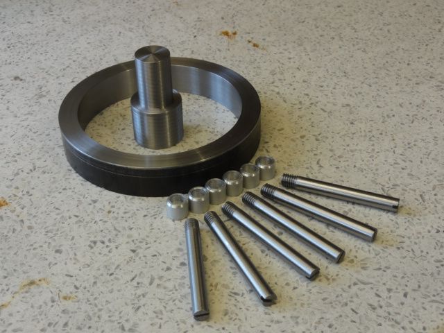

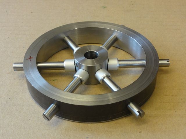

                                  Jim Nic
                                    @jimnic
                                    I make flywheels in a similar way to Duncan's it appears.
                                    Start with the bits:
                                    Initial machine and assemble:
                                    Loctite it all together and finish machine:
                                    Add some car body filler fillets, paint and display:
                                    I have made several like this varying from 70 to 170mm diameter. The rims are steel from M Machine, the spokes silver steel and the hubs mild steel. The ones shown here are 95mm dia, 15mm wide and the spokes are 6mm dia.
                                    Jim

                                    Anthony Knights
                                      I have also made several changes. The cylinder and steam chest are made from cast iron rather than aluminium, purely because that is the material I had to hand. The vertical beam was machined from solid because I didn't fancy all the fiddlely soldering.
                                      The figure was obtained from a British company called "Farol" which I got to via Amazon (although it was made in Germany). Searched the internet with " 1/16th scale workmen figures" and this was one of the hits. He is a garage mechanic and came with a toolbox, a trolley jack and a pair of axle stands. I think it looks about right scale wise.
                                      I have still got quite a bit to do. Bushes for main axle, steam chest valve and the regulator assembly. I also need to make some studs for the steam chest as the 2mm screws I am using are barely long enough and have pozi heads. At least, its now warm enough to get some more workshop time, so I'll report back when I've made further progress.
                                      Regards Anthony

                                                  Pete.
                                                    @pete-2
                                                    Nearly finished my little press, need to cold black the new ratchet mechanism parts I just machined, and the new handle, just need a few broaches now.
                                                    Large broaching press
                                                    #537924
                                                    Jim Nic
                                                      @jimnic
                                                      A fine looking bit of kit Pete.
