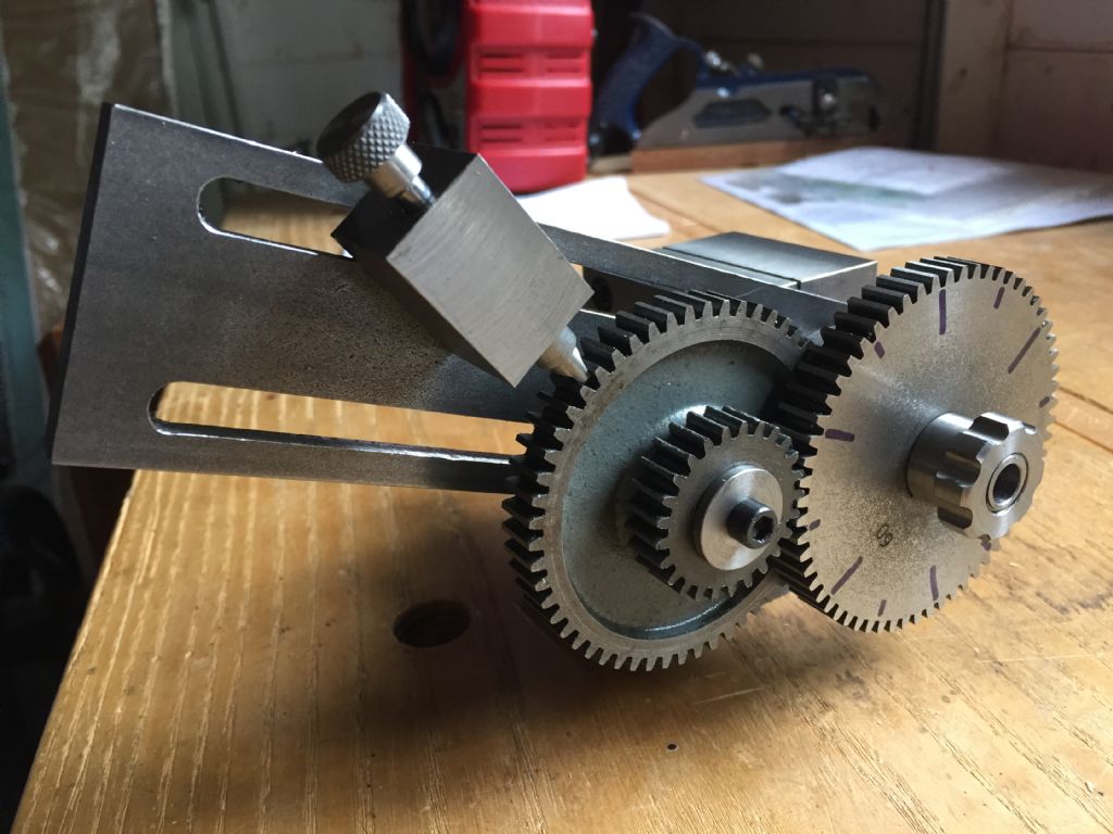

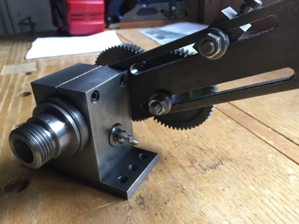

      Completed (mostly) building my dividing head. Having said that, I've got a random dividing plate that SWMBO picked up on a whim; at some point I'll make up a worm attachment for it. Now if only I could remember why I needed a dividing head in the first place……………?

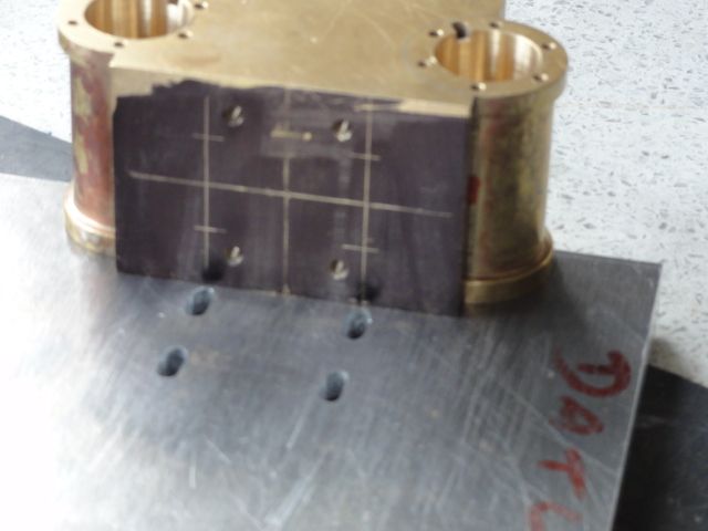

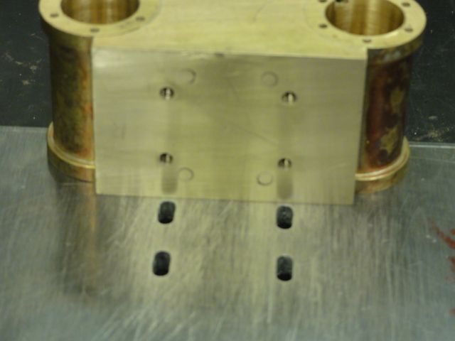

            One step forward and 2 steps back on the Overcrank. I made the base, just a piece of ali sheet with 6 round holes for the crank bearing supports and 4 elongated holes for the cylinder block. What could possibly go wrong?
            When I offered up the cylinder to the base I found out. The holes in the cylinder base were incorrectly positioned and although I could have used them the cylinder would have been 90 deg out and pointing acrtoss the base instead of along it. The correct positions are marked out in the picture below.
            "Oh, pooh sticks." I said, and went for a lie down while I considered whether to scrap the base or the cylinder block. After a while when calm was restored I came up with a simple plan and plugged the M4 holes in the cylinder base and redrilled them in the correct place.
            After that I made the crankshaft bearing supports. Here is the base with one shaped support and 1 blank (the third is set up on the milling machine).

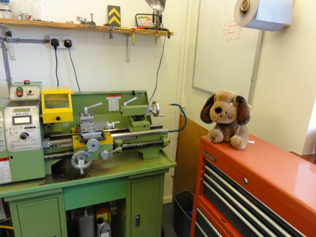

            For some time now I have been muttering within earshot of the Domestic Authority that I could do with somebody to talk to while I'm busy making important stuff in my "playroom" as she calls it. I have let it be known that a dog would probably fit the bill despite her lifelong objection to domestic animals making a mess in her nice clean house.
            Well to day she gave in and came home with my new pet. Meet Doug:
            I'm not sure she is taking this matter seriously.

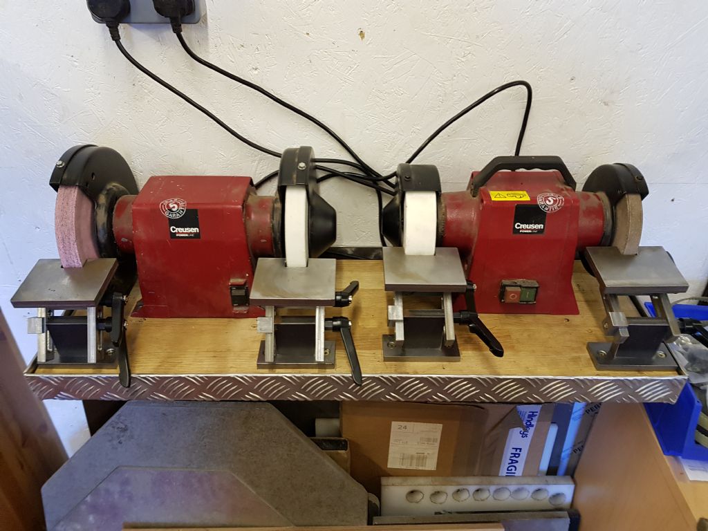

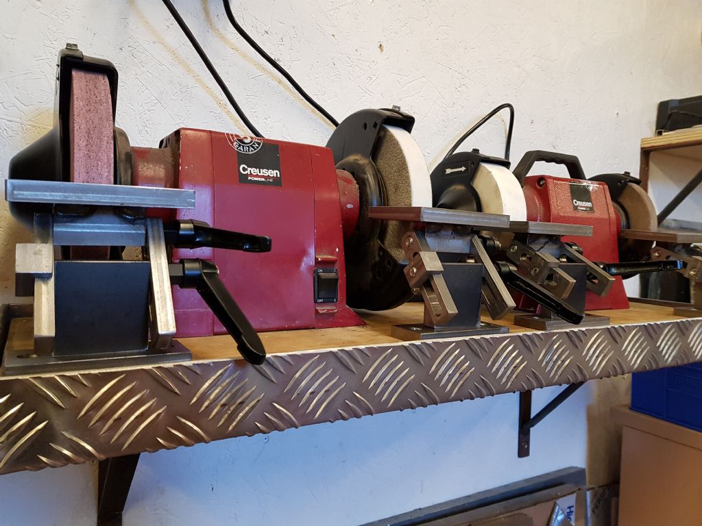

              Finally managed to finish off the grinder tool rests today. Seems like I've been working on them for weeks.

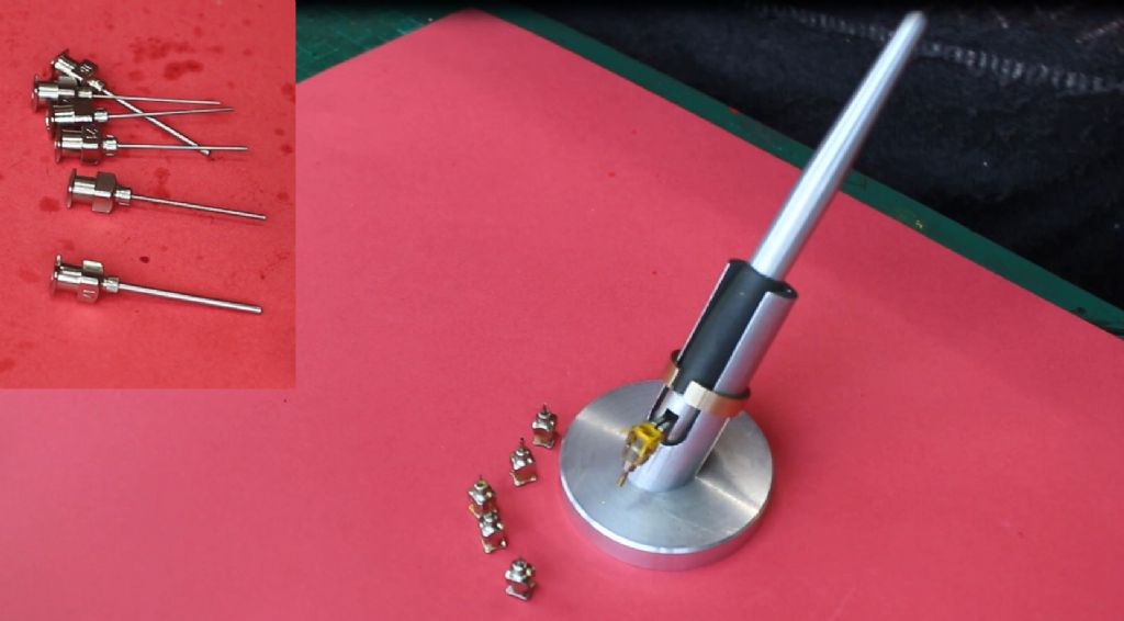

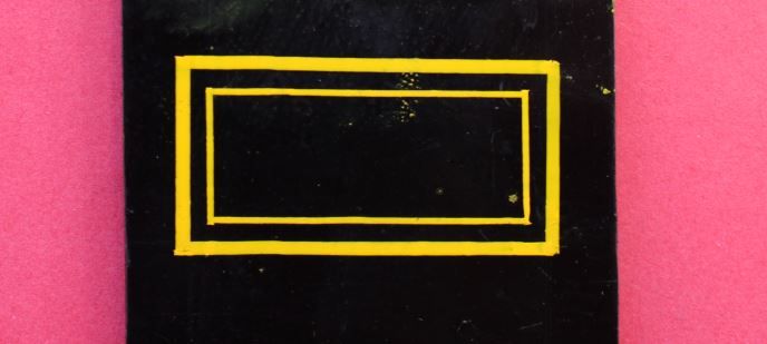

                I have a Stuart 10V i'd like to paint and do a bit of lining on. I've done some lining with an old fashioned draughtsman pen but wanted to try a lining pen. I found some 'blunt dispensing needles' and used them to make a lining pen. My initial trials have given some pretty good results though I need to learn more of the technique. I made some video's to share the idea if anyone should be interested.
                lining pen and nibs
                **LINK**
                **LINK**
                **LINK**

                  Nigel
                  thats very interesting and informative thank you
                  PS the last link won't work but I've managed to view it through the tube

                    Thanks Paul,
                    The needles cost less than £2 the set and all the other materials were just some off cuts so a very cheap and quick project, the practice takes longer than the building.
                    I missed a digit off the last link, here it is again.
                    **LINK**

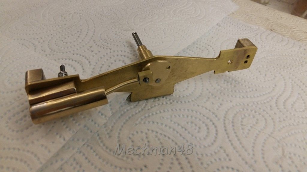

                          A bit more on my Boxer oscillator, trail assembly of 1 Cylinder, piston, back crank plate. Haven't touched it for some time, other stuff came to the fore… face 18. Not really over enamoured with the crank plates assembly as it stands at the mo'… there is alternative arrangement that can be used but will percy veer with this arrangement for now…
                          … and for the eagle eyed can you spot deliberate mistake ?
