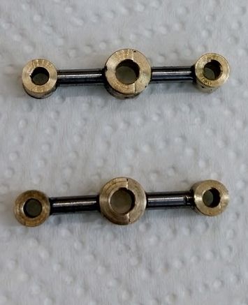

        Small but progressing, remade ( 2nd time ) the swing arms for the Vert.cross engine…Just need to clean up …

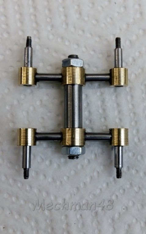

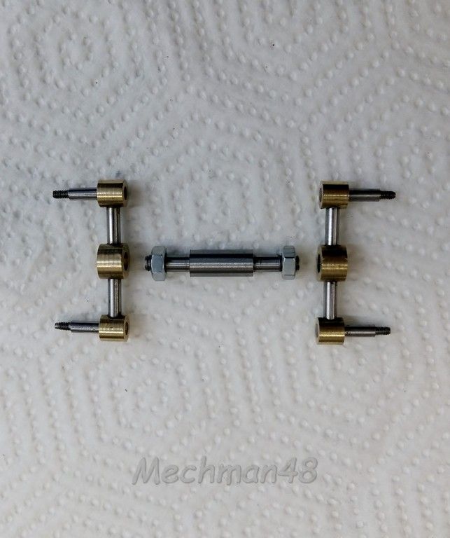

            Finally ! completed the swing arms for my vert.cross engine… on the third attempt wink
            such a faff on… small fiddly bits… getting them aligned & set with Loctite, hopefully it'll stay together. Next up the con rod… thinking

                Swing arms look good George. yes I think that's probably the trickiest bit.

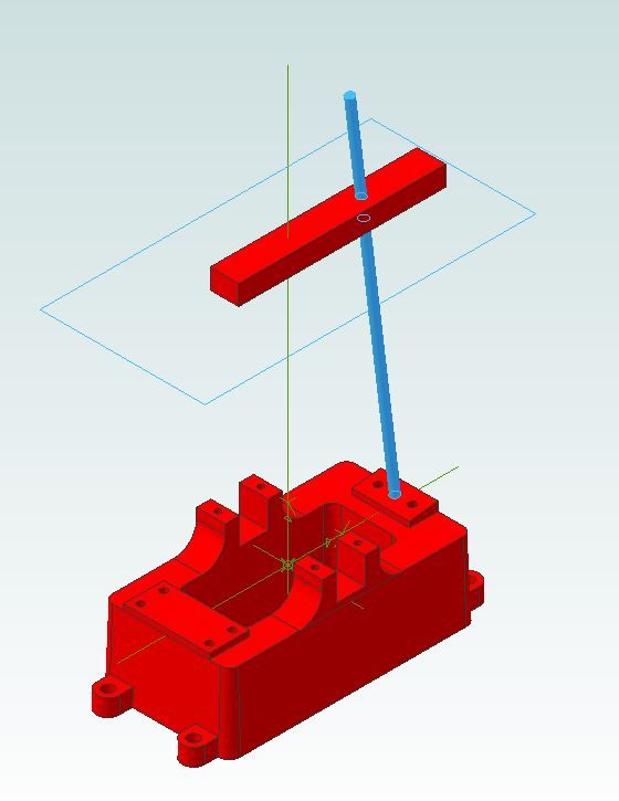

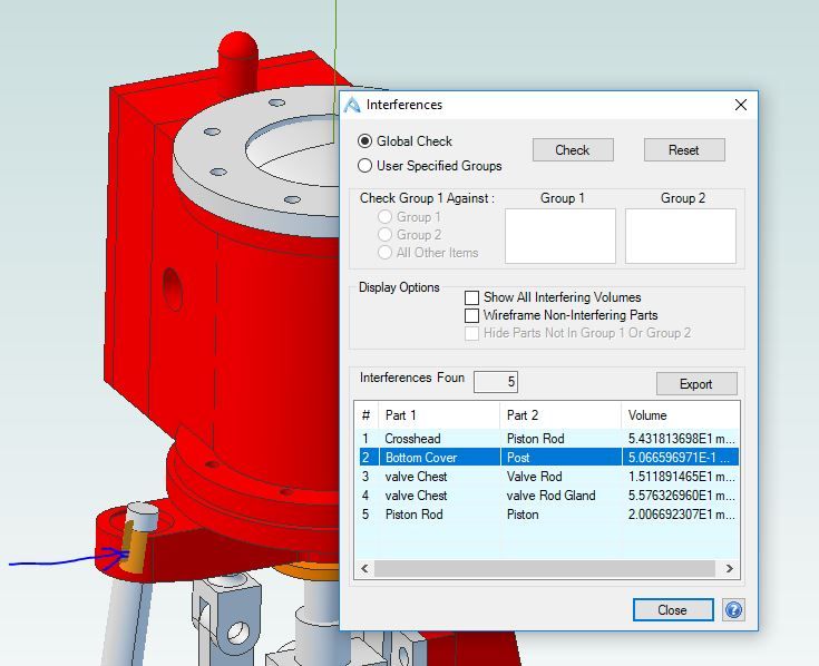

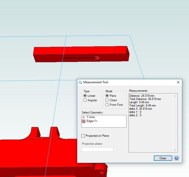

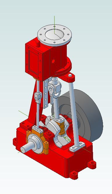

                            I've always wondered how you get the sloping stay bar (which I assume goes on the left hand side) to line up properly. I can see how you would get the angle the same on the base and cylinder support bits, but getting them coaxial? Perhaps Jason could enlighten us.
                            #342301
                              The joys of CAD smiley
                              Yes you assume correctly, there will be a stay to support that side of the cylinder.
                              I'm sure that back in the day the draftsman would have drawn it out and then dug out his slide rule and log tables to calculate lengths and angles.
                              But CAD means we can keep out socks on. What I did was to draw a circle centrally on the pad where the rod will fix to the base and projected this upwards as shown by the blue shaft. I also drew part of the cylinder support at the correct height above the base.
                              I then treated this blue shaft as a cut (drilled hole) which cut a hole in all it passed through therefore giving me a hole in the cylinder support. I can then measure from the central axis to the ctr of this hole which gives me it's exact position which can be used when it comes to producing the 2D working drawings and then the actual part.
                              Once all the parts are assembled it is also possible to check for any interferences, here I have moved the hole by 0.01mm and the CAD shows the clash in orange which I have arrowed in blue. This is for a 4mm spigot on the end of the shaft into a 4mm hole, in reality I will drill with a bit more clearance than I would for a normal fixing as there are bound to be slight differences between theoretical and actual positions.
                              The Cad also lets me check that nothing hits as the engine turns over which I can simply do by holding the mouse button down on a rotating or sliding part and moving it about.

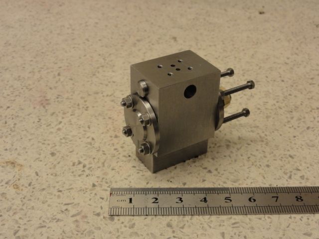

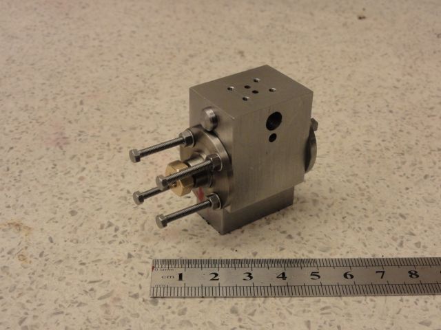

                                My current project is Ray Hasbrouk's No 3 Rocking Valve Engine. This is a fairly simple engine with not a lot of moving features so I decided to reduce it's size. I did this by converting the imperial dimensions on the drawing to metric using a 15mm to the inch conversion factor.
                                After a set back involving a small BA tap and a ruined cylinder I have made a couple of design changes to allow the use of larger threads than the reduction in size called for and now have a completed cylinder assembly.
                                Jim
                                #342413
                                  Looks good Jim
                                  Interesting choice of reduction, was there a particular reason for going with 15mm/1" ? I have done similar and found that 1mm to 1/16" works out nicely to round numbers and gives a very similar size reduction of 16mm/inch
                                  #342454
                                  Jim Nic
                                    @jimnic
                                    Jason
                                    I went with that conversion for 2 reasons:
                                    1. I happened to have a flywheel about 3/5 of the original design size.
                                    2. I wanted to convert the imperial dimensions I had on the drawing to metric so I made a spreadsheet and 15 was a convenient number to end up where I wanted to be and seemed the logical way to do it.
                                    3. I never thought of working the other way (which now you mention it would have been a heck of a lot simpler)
                                    I wish now I had asked for advice on here, but next time ……….
                                    Jim

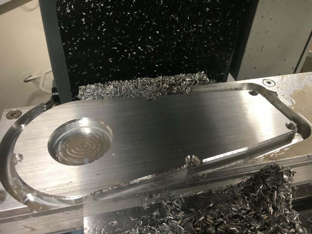

                                          Finally machined up the cover plate for my X axis housing. I had this ready to go a week ago before I buggered my back. Turned out OK but I'm seriously pigged off with the alleged chamfer tool – I'd be better off with a countersink drill. Don't recall much about its parentage but I've struggled to find any uncoated carbide chamfer mills in the UK, so ended up ordering some from Aliexpress. After all, they really can't be any worse.
                                          That's probably the last job I'll be doing on this machine with the Chinese controller. I've just taken delivery of a Centroid Acorn controller which will be going on the Shizuoka and the Chinese controller will be moving over onto the Bridgeport. It's not a bad deal for £400 but even for someone who is used to working with Chinese, the machine translated documentation is truly insurmountable.

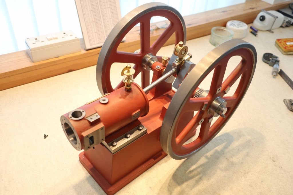

                                          Brian O’Connor
                                            @brianoconnor49474
                                            Just finished honing and lapping the cylinder and piston of my Star Hit & Miss engine to get a nice sliding fit. A first assembly and it's starting to look like an engine. The iron castings were a delight to machine, no blow holes, no chilled margins and all the lumps and bumps very accurately placed. Still a long way to go though.
                                            B
                                            Edited By JasonB on 01/03/2018 17:48:35
                                            #343791
                                              Looks good Brian, the start is a nice engine.
                                              #343849
                                              Brian O’Connor
                                                @brianoconnor49474
                                                Thanks, Jason. You could probably built two of these by now.
                                                When viewing the photo I realised that in reducing the size I had got the aspect ratio wrong. The image in my album has been corrected and although it has the same name as before, my post above cannot find it and I can not find any way of editing my post. Can you help restore the picture please?
                                                B
                                                #343884
                                                Brian O’Connor
                                                  @brianoconnor49474
                                                  Many thanks, Jason, for sorting the picture. B

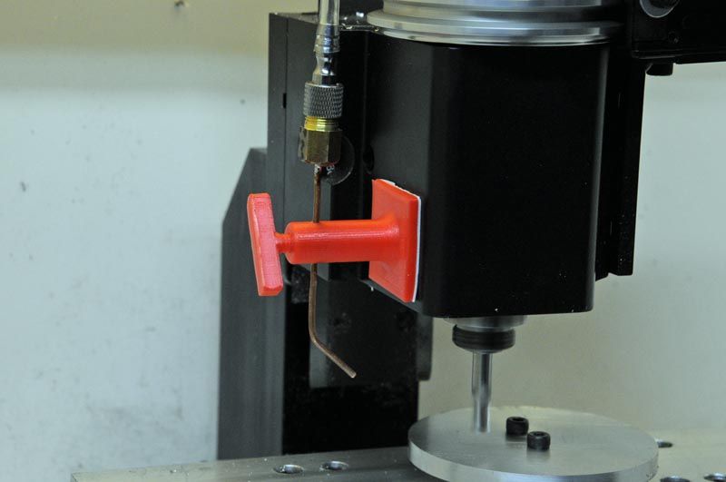

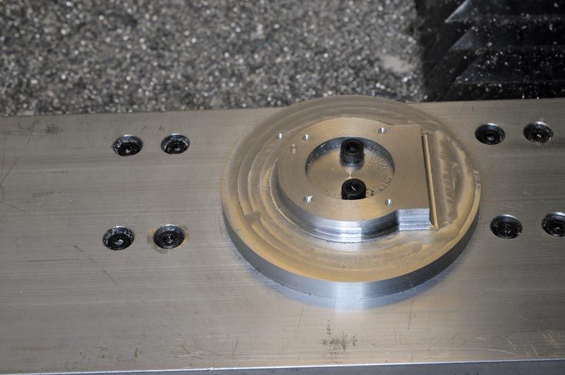

                                                      I decided I needed some mods to my little Denford/Sherline CNC mill to make it truly usable so I have added some bellows to protect the Y leadscrew, a sub table for easier attachment of the workpiece and a blower to stop the swarf choking the cutter.
                                                      Here's a little bit of video of the blower in action.  My little airbrush compressor can keep up a constant 30psi through this nozzle which seems to work OK.
                                                      What was the driver for all this activity?
                                                      Anybody recognise it?
