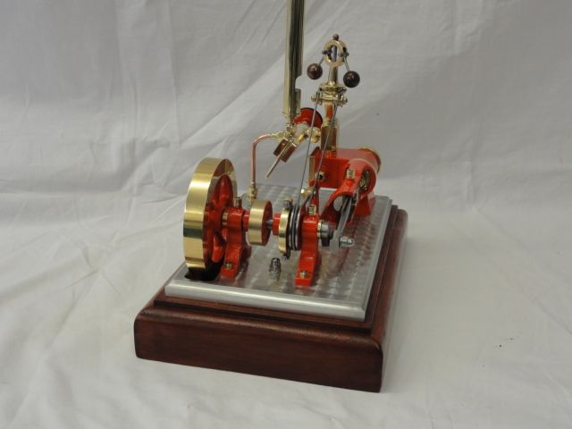

            New Year + New engine running = Happy smiley
            I started this little oscillator on the Saturday before Xmas, got it to the stage where it could be test run today. Quite pleased with how it has turned out, should be finished and painted by the end of the week.
            J

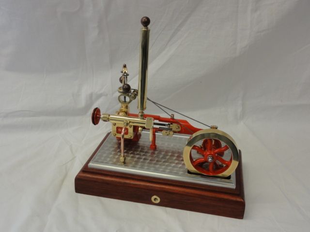

              Well a couple of days doing the last few little bits to make it look nice plus a lick of paint and that is this one done and dusted.
              As you can see I went with the creamy yellow which is in fact U-POL HIGH5 high build primer filler topped off with a clear gloss lacquer. I also kept the wood cleading fairly light too.
              A bit of a vid of it running. These 24mm bore engines are quite a nice size – not too small that they become fiddly and not too large that you need to spend a lot on materials or need a big compressor to run them. At a steady speed it will run for about 3mins before the compressor trips in or if I switch it off I can get about 7mins before the tank is too low.

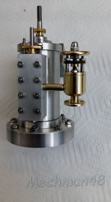

                                  A little more done on the vertical cross… trial assembly of valve chest
                                  ​looking good so far… need to make inlet flange… the valve does actually operate, honestly face 23
                                  George.

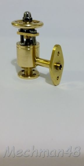

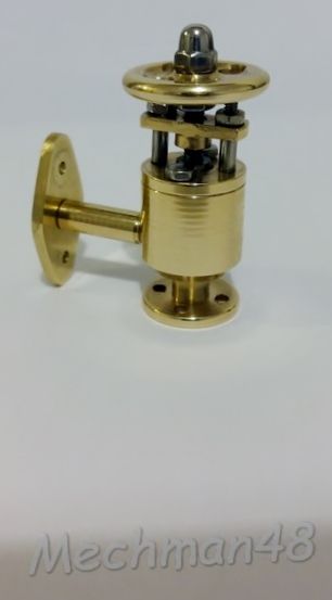

                                          Completed inlet valve with flange Loctited on…
                                          … getting there
                                          George
