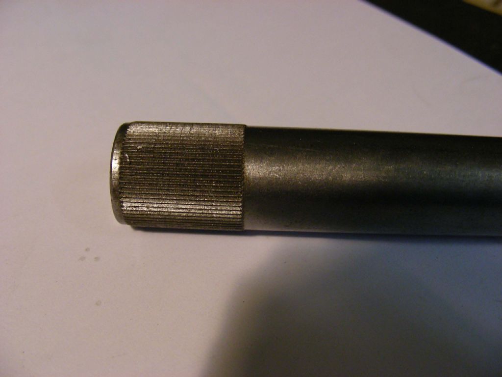

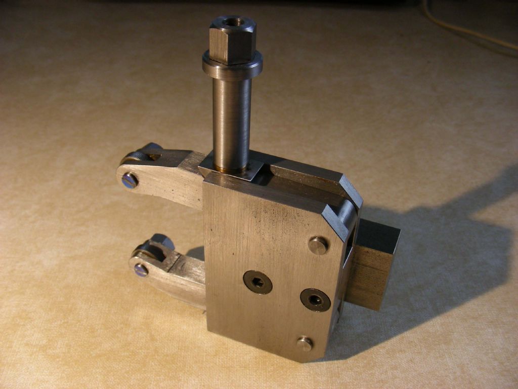

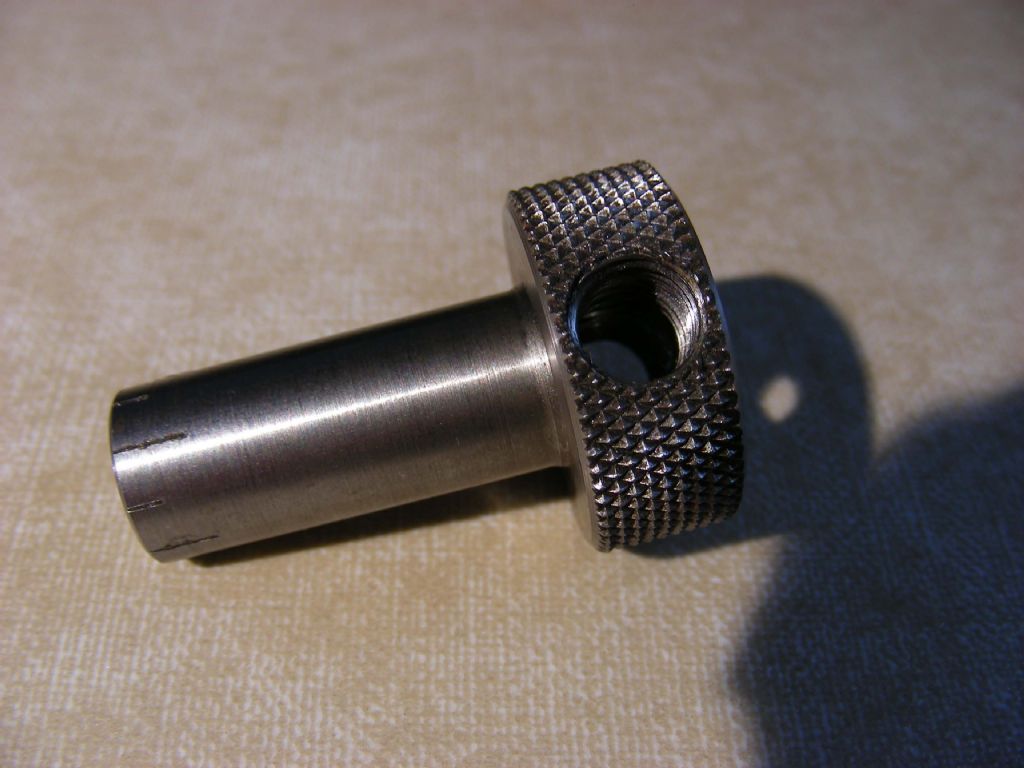

      PPS re HK knurling tool:
      Here is the finished tool with arms reversed and pins shortened and provided with the screwdriver slots which now seem necessary; I left a projection of about 0.050" as an insurance against having to recut the slots in the hard HSS pins:
      First test piece with new arrangement:
      The original adjusting nut knurled by the tool itself:
      The photos are rather poor even by my standards; I dropped my cherished Panasonic compact some time ago and have been struggling with a less familiar camera.
      #301293
      Journeyman
        @journeyman
        Ega, nice job looks to work very well.
        #301303
        Emgee
          @emgee
          Nice crisp knurling Ega, tool works well it seems.

                    Ega, well done, I like the improvments. My pins are made of silver steel, just hope they're up to it.

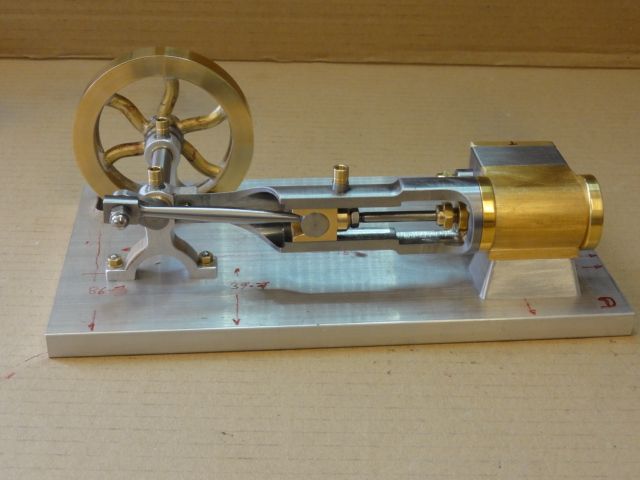

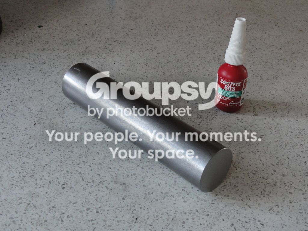

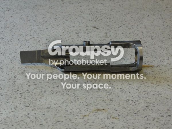

                      More progress (but slow) on the Popcorn. I turned this piece of bar:
                      via this:
                      this:
                      and this:
                      into this:
                      I combined the crosshead guide, for that is what it is, with this, the crosshead:
                      To get this (attached to the previously made cylinder):
                      I'm not too happy with the finish on the crosshead guide but frankly there is so much headscratching and work in it I can't bring myself to scrap it. Probably the more I look at it the more it will grate on me and I'll end up making another one having learned a couple of lessons from the first.
                      Jim

                        Posted by Jim Nic on 14/06/2017 20:38:50:I'm not too happy with the finish on the crosshead guide but frankly there is so much headscratching and work in it I can't bring myself to scrap it. Probably the more I look at it the more it will grate on me and I'll end up making another one having learned a couple of lessons from the first.
                        Jim
                        Don't worry, you are not an orphan there. Seems to be the way it often goes. But the longer you leave it, the better it looks!

                              Making slow progress on the Stew Hart Popcorn engine. Here are a couple of pictures of the first trial assembly of the major bits.
                              Next up is the valve operating mechanism after which I can get it running with a temporary air supply and then on to the air manifold with it's throttle valve, governor and whistle.

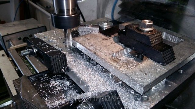

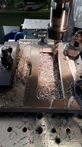

                                Progress on my Vertical cross engine, chain drilled out the major apertures then after some fiddling about setting up …
                                ​…squaring front edge 90 * to datum edge
                                ​Milling out flywheel aperture…
                                end result…
                                George.

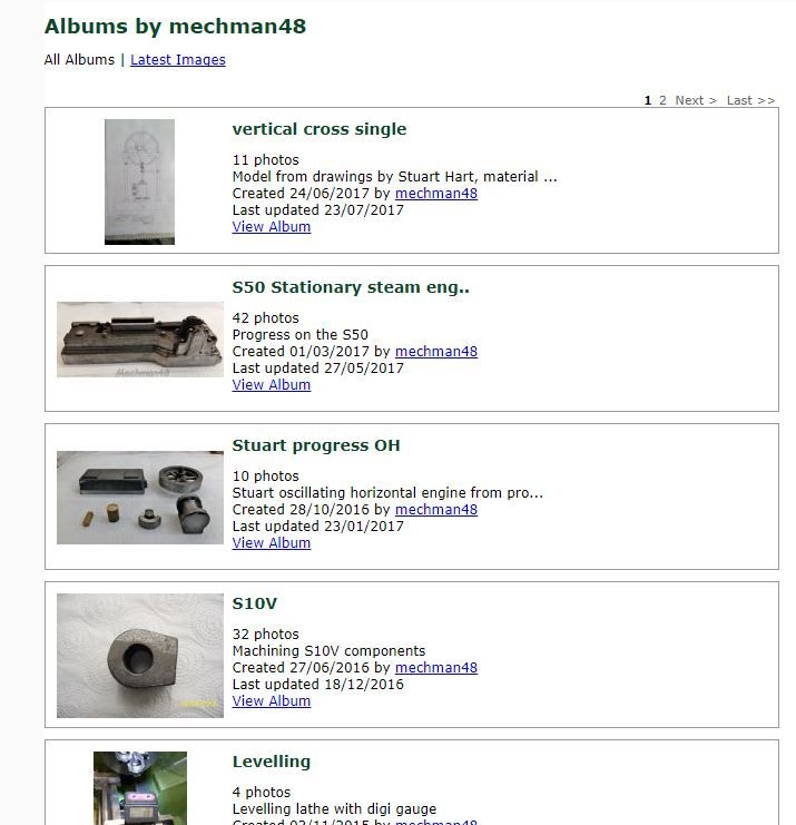

                                ​p.s. somehow my albums have started to overlap the following albums… anyone help with solution, looks as though it's linked to format spacing, started after I inadvertently deleted my miscellaneous album, possibly could a moderator offer assistance ?

                                    On my version of this engine I stood the top plate on edge against an angle plate and cut around all the edges with a 5mm slot drill to make it look a little less slabby.
                                    Jim

                                      Nice touch Jim… food for thought there. looking at your flywheel it seems to be a fabricated one that is an option on the drawing, I have a 4" Stuarts CI flywheel that I intended using so it won't be as wide as yours is… but there again changes can happen…thinking.
                                      George.

                                          George I can't see anything out of place when I look at your albums, can you post a screen shot of what you see?

                                                  … George I can't see anything out of place when I look at your albums, can you post a screen shot of what you see?​…
                                                  These 3 box's seem to overlap in the text & heading area…

                                                    Is the Misc Album the one you deleted? may need to clear your Cache. As I said looks OK to me but will login as you to see if any different.
                                                    #308625
                                                      Try it now, may not have cured the overlapping but your Misc album does now show the 88 photos that were hiding in there.
