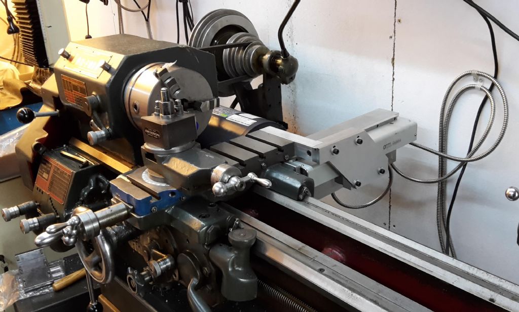

      Hi Sean thanks, it's taken me over 6months before I've taken my first cut. It was sat in the shed for 3. Then I bought a bench set up for it, and even then it just sat. I've been working at it for 3months, and been told off too when i do daft stuff like nearly crack the head stock. (Now has a layer of drinks cans made up to take up the space thats left in the headstock casting, bearing clamp).

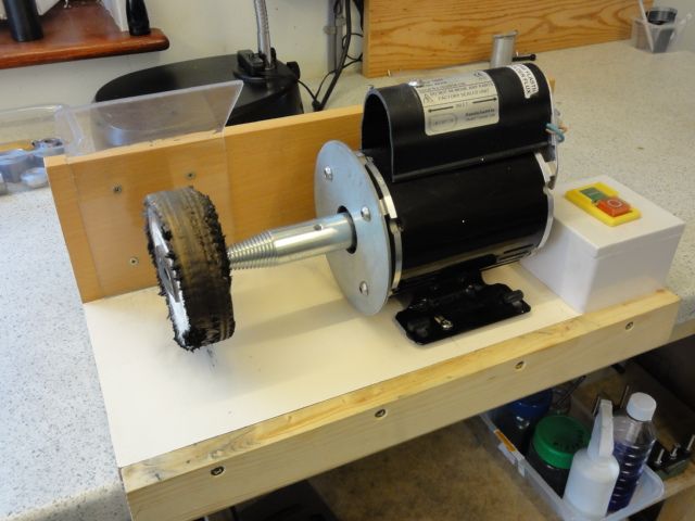

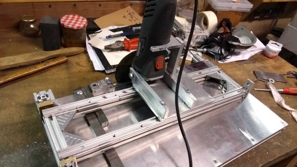

        Today I finished putting together my chop grinder. Made from rexroth (grown up meccano), some (nasty) aluminum plate I had lying around and an angle grinder.

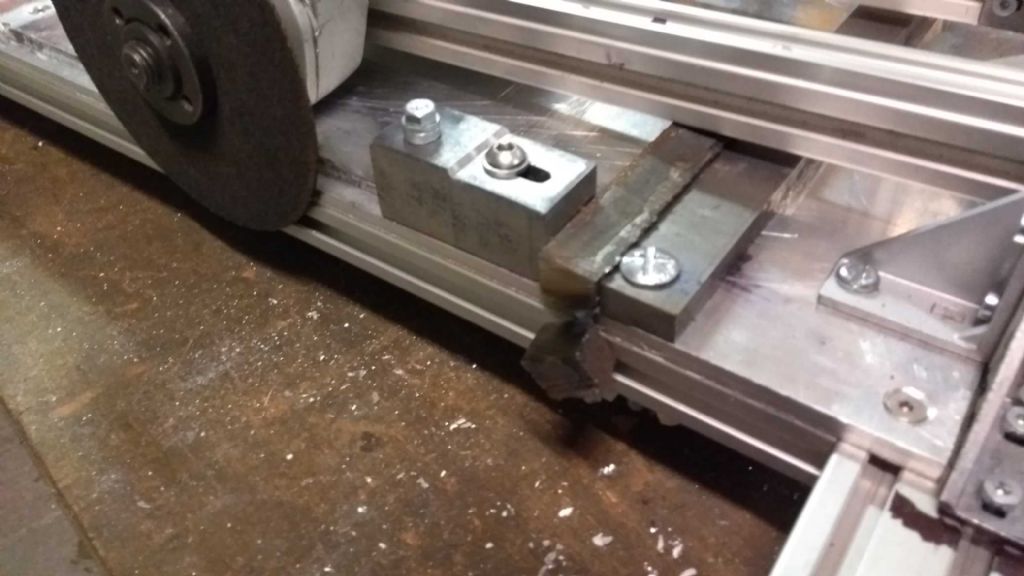

        You'll see my first cut in picture 2. I think I need to make a handle to hold onto the grinder with, but it seems to work!
        In the interests of feeling pleased with myself I didn't venture into any more challenging cuts (my immediate target is a piece of 50mm steel bar – but I'll work up to that) in case it all fell apart.
        Oh – despite appearances it's not intended to cut any foot wide plate, it's just that that's the size of the ally I had.
        Iain

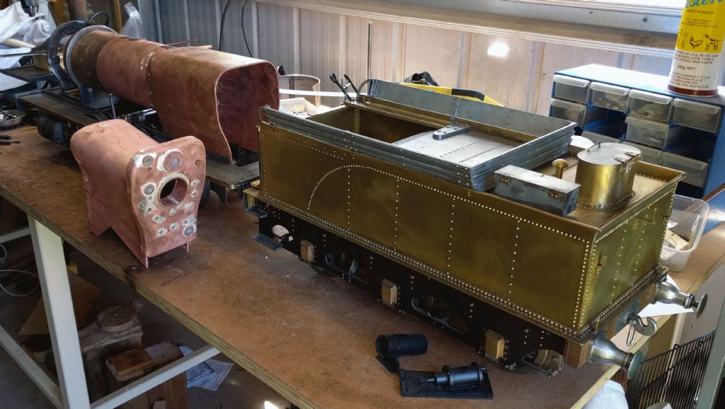

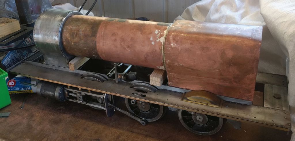

          I'm plugging away on a 5" gauge NSW 24 class mogul. I got it running on air earlier this year so have been working on the boiler. I decided to get the smokebox to the point it can be used to help level the boiler barrel.
          A friend tack welded the wrapper on for me.
          Regards, David.

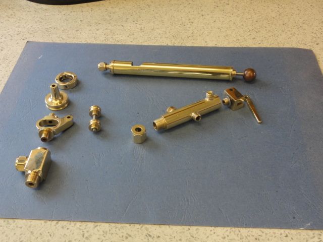

            After much wailing and gnashing of teeth I have completed the steam manifold and governor parts for the Popcorn engine.final trial assembly 3.jpg
            I even managed to get the Swanee whistle to work but I was not wrong when I thought this aspect of the engine would be tricky. The lower section of the governor took 3 goes to get right and the top another 3 before I decided to accept what I had; the manifold was going well until I foolishly held it in the vice after silver soldering the connections which softened the brass and crushed the threaded end crying 2 .
            Anyway, all it needs now is painting, polishing and getting running again then its on with the next project.
            Jim

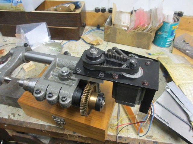

                                                  Finished the mechanics of my CNC Myford dividing head. Pinched the design from John Haine who kindly sent his drawings, and will be pinching the elctronics design off Silly Old Duffer, but some other jobs to knock off firts.img_3023 (small).jpg

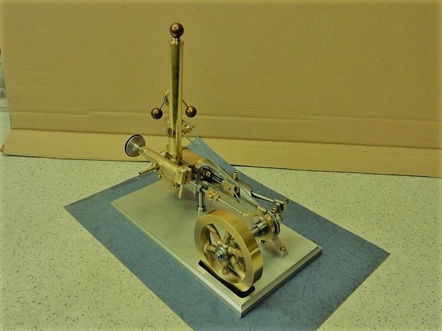

                                                      After a short break while life got in the way of workshop time it was on with Popcorn.
                                                      Having completed the parts of the engine I broke it down for painting and looked at the amount of brassware I had decided needed to be polished up. My conclusion was that I needed a buffing wheel! As luck would have it during my "life break" I aquired a domestic Stuart Turner shower pump with a faulty, vastly overcomplicated, switching module but with a very smooth motor. Said motor looked to be just the thing to power a buffing wheel and after a bit of bodging and the addition of a pigtail and buffing wheel and an NVR switch it turned out to be so.
                                                      Just some of the shiny bits
                                                      Whilst wood butchering for the Buffer I also made the plinth. My first attempt at engine turning on the base looks OK as long as you stand well back, which I recommend when viewing my efforts.
                                                      Jim
