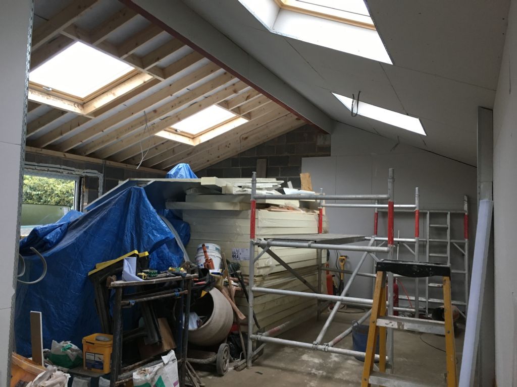

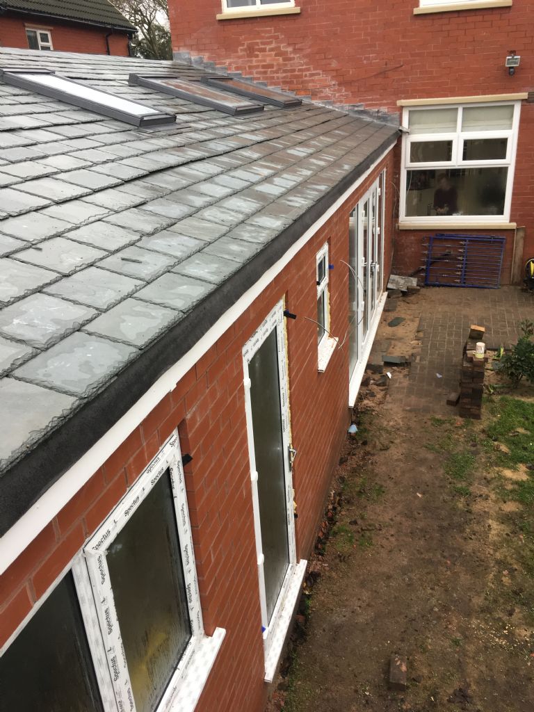

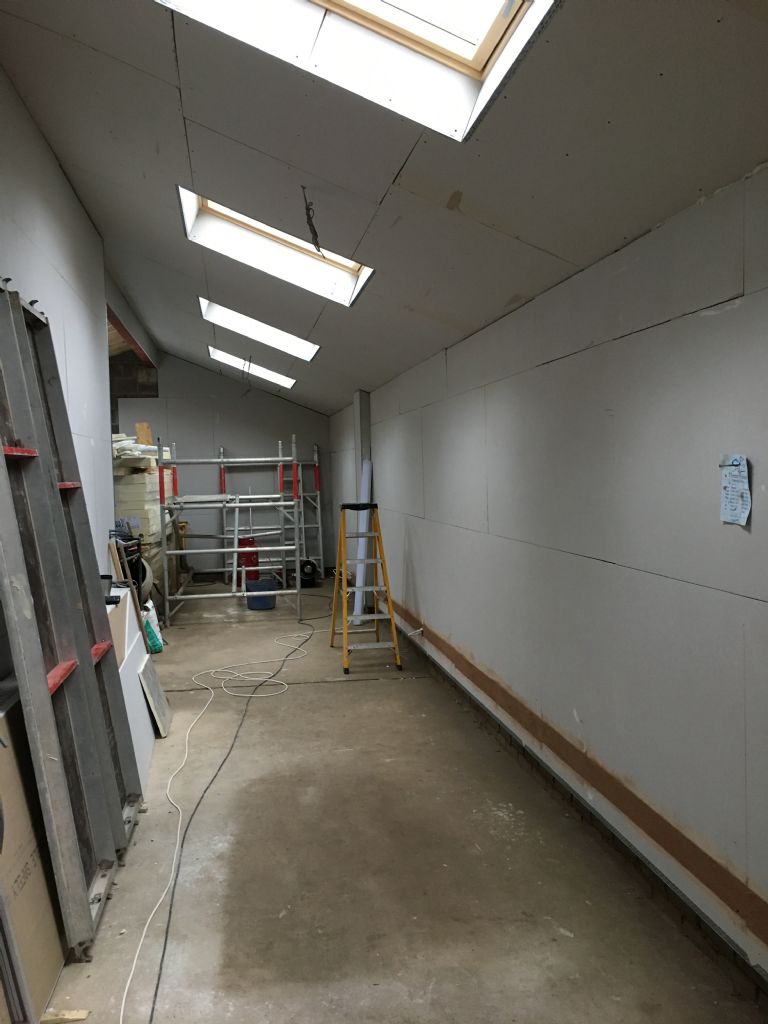

              Well it's called "workshop progress", so I can report recent progress on the build of the…..workshop.
              Now fully insulated, windows and doors in, half plastered (since these pcs taken), first fix water, heating and electrical completed. The sun lounge / dining room / utility room are painted and heated, so we were able to host Xmas and NY dinners. Yes, 1/4 of the extension was conceded to household use in the interests of domestic politics. Even so, with basic internal dimensions of 6.5m x 15m, that still leaves a fair bit for machines.
              Should be finished in a couple of weeks, apart from the second fix electrical, heating and plumbing (my task). Looking forward to being released from the armchair workshop and getting my hands dirty again. It's been like living in an open prison (I imagine) – personal freedom but no workshop.
              Not looking forward to applying two coats of paint to this little lot…..

                Murray,
                It looks like there is a useful 2 storey building at the end of your new workshop that could be incorporated into the new build to give that all important extra space that you are bound to need sometime. Apart from that it looks excellent.

                    Good grief Muzzer that's a workshop and a half. face 21
                    We expect some serious willy waving when you get the rest of the machines installed and the CNC beast running. And we also expect to see some serious lumps of metal being machined. thumbs up

                      Andrew – haha it's been such a long time I worry I may have forgotten how to use them. I hope I haven't become welded to the armchair – it seems to be quite a risk. It's getting there slowly but there is still a fair bit of work to be done.
                      David – you are correct of course but I'll have to think carefully about how to frame that concept for my wife's consumption. We have planning permission to convert the loft already, although we don't have enough beer tokens to get started right now. Obviously it's vital to avoid valuable workshop space being wasted on storing household possessions. And it goes without saying that no vehicle will cross the threshold. It's a workshop, not a garage…..

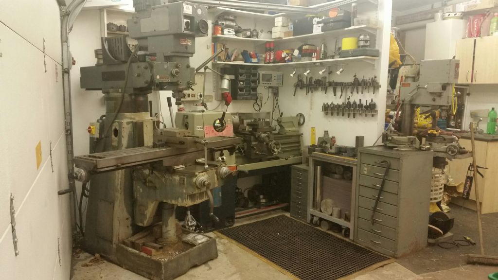

                          Like many home workshops, mine has to have space related compromises, however the corner where the lathe and mill live just didn't "feel right" at all…….so today i got stuck in. Still many compromises but feels so much nicer already. yes

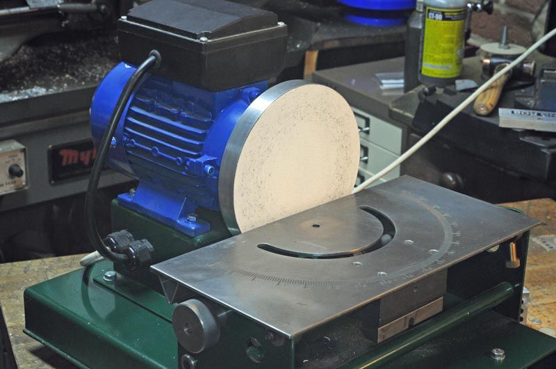

                            Made the Hemingway linishing disc to go on my Worden, just a couple of hours work. I altered the design slightly: My 11mm reamer gives a fairly tight fit on the motor shaft so it really needs an extractor, which is just an M6 thread down the middle so a screw can push on the end of the shaft. I made a short 1/2"BSF stud and screwed this into the disc centre with Loctite retainer and then drilled and tapped for M6.
                            Performance is actually quite impressive.
                            The supplied 80 grit discs are a bit coarse for finishing but seem to be very good for roughing out HSS. Can anybody recommend a source for some finer self adhesive 6" discs.
                                  Looking good, Rod. You can get some fine 6" discs from machine mart, by Clarke. I don't use them for cutting as such but giving an even surface finish to a part.

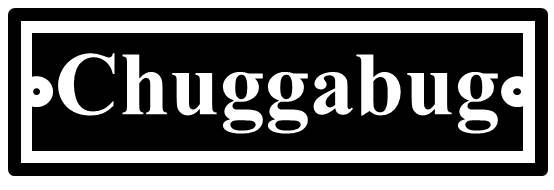

                                    Inspired by a previous enquiry on here about making nameplates for a Tich I've spend a while working out how to engrave them on my Novamill, and made a couple for the OP. I created the G-code using an excellent program called F-Engrave, which allows to to do text or "V-Carve" from a bitmap image. I created the image in MS Powerpoint and used the "right-click save as image" option to save as a .bmp file.
                                    Here are some photos of the process.
                                    The starting image used by F-Engrave. This translated to about 7000 lines of G-code for the cutting operation (which outlines the letters) and the cleaning operation. Everything black will be cut away to a depth of 1.5mm (3 mm parent material, engraving brass). I used a 1mm diameter TC coated end mill from Arc, which worked out brilliantly, I ordered two cutters and didn't break any! My max spindle speed was ~5000 rpm so I limited the feedrate so it took a long time, about 4 hours per plate.

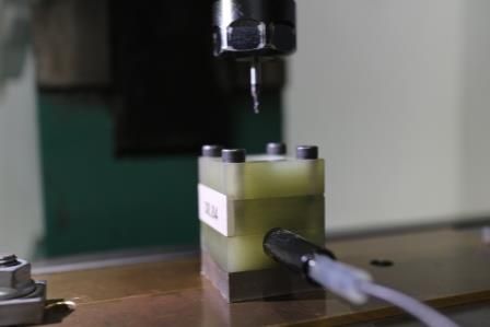

                                    Setting the tool height so zero is on the top of the plate. I run a macro which lowers the tool until it touches the top of my height setter, backs off, then lowers very slowly 'til it touches again, the raises the tool up to 50mm above the surface the setter is sitting on.

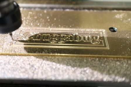

                                    Cutting in progress for the first nameplate.
                                    One down, one to go.
                                    Both plates done, ready for sawing out, cleaning up and painting. I know a lot more about engraving now, but I don't think I'll go into the nameplate business!

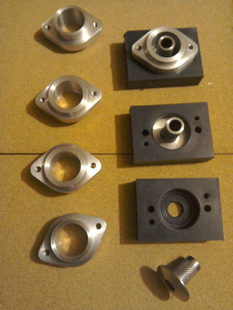

                                      Moulding assemblies for rubber bushed axle blocks for this year's "Trojan" monowheel.

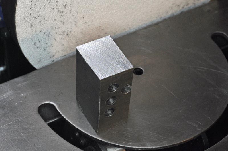

                                              Made .22 rimfire cartridge effective length gauge #16 today – This one is off to the IBU (International Biathlon Union) world championships in February.
                                              I have been asked to quote on 50 so it might be time to farm the blocks out to a CNC facility. Fortunately I have the CAD drawings.
