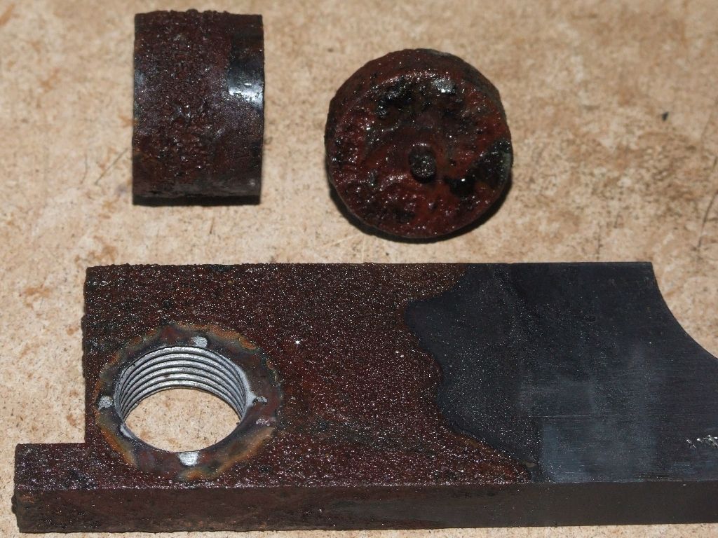

      I was asked in another thread to amplify on my comment about a silver soldering foul up. So here goes!
      The jobs were for the gear change mechanism for my 4" scale traction engines, so largish (3/4" by 1/4" and 1-3/8" by 3/8" ) steel flats. I prepared all the parts, cleaned them in acetone and adjusted the fits to leave a gap of about 4 thou, as per the CupAlloys advice sheet. I was using Easy-Flo2 and an appropriate flux, both manufactured by Johnson Matthey. I mixed the flux with a little water and liberally applied it to the joints, before assembling the parts. So the flux was intimately applied to the joint area. I was using a Sievert burner and propane. After a gentle waft of heat to boil off the water in the flux I let the heat build up. As expected the flux dried out. It eventually went clear, like water. But when I applied the silver solder rod to the joint it didn't melt. So the joint isn't hot enough? More heat was applied until the joint was glowing dull red, and the silver solder did melt, but by this time the flux had disappeared and the solder didn't run properly.
      It is ironic that my previous silver soldering has been on brass, using oxy-acetylene, and I had no problems. Using the Sievert torch I seem to have all sorts of issues. I can think of some potential problems:
      1. Both the silver solder and flux are old, 35 plus years
      2. I'm not getting enough heat into the joint area to reach the required temperature before the flux is exhausted – this is my current working hypothesis. The assemblies are fairly large, up to 10" long.
      3. Once up to temperature the gaps I had formed were rather bigger than 4 thou, so may be too large?
      4. Some other foul up I haven't though of, or a defective operator. sad
      Even the part that I did manage to silver solder was covered in crud after it had cooled. Most of it came off with a soak in vinegar overnight. But it still comes nowhere near the standard of finish that I want. Hence the note in another thread about hogging them out of solid. Until that is the Bridgeport decided to call it a day.
      Some days you're better off staying in bed; I've had three days in a row like that. Roll on tomorrow! And now…..beerbeerbeer

          !, "The silver solder and flux are old", that 's not the problem, I'm old but I can still silver solder alright!
          2 Heat, it could well be a lack of heat where it matters most, a job like the one you describe needs to be well surrounded with reflective refractory material to concentrate the heat on the job.
          3, .004" is getting to be a fairly large gap but with the correct grade of silver brazing filler rod it shouldn't be too much of a problem.
          4, Your flux gave up the ghost long before the job had attained the correct temperature, you will need a flux capable of prolonged heating and when conditions are right, warm the end of the filler rod, dip it in your normal flux and the silver solder will run easily.
          To clean off flux residues on steel fabrications, let the job cool right down and pop it into a bucket of clean water, leave it in there for a couple of hours, when you fish it out the residues will just wipe off leaving a nice grey finish to the steel.

            I find silver soldering steel much harder than copper and it's alloys. You must have a higher temperature flux. If you use Easyflow type flux you have no hope. HT-5 or similar is the go. You still have to get the job up to temperature smartly, and 4 thou is bigger than necessary and likely to cause trouble. I admit I hate it and get stressed every time. I would never attempt a steel assembly 10 inches long!

                Torch soldering / brazing etc can be a bit counter intuitive. What I think you will find you have done is put the torch too close to the work. The flame is more than hot enough to boil the flux off before the work has heated to the correct temperature. The answer is to move the torch back away from the work and heat things up more slowly. You could look around the web for flame temperatures but it would be better to find out for yourself on a couple of suitably sized pieces of metal. Find the distance that causes the flux to melt is a good starting point. You will probably then have to go closer once the work has reached that temperature to get the silver solder to melt but not so close that flux boils off. Done this way it will take longer to heat the work – that's the catch. People are inclined to heat it up as rapidly as possible and might even put the end of the blue cone on the work.

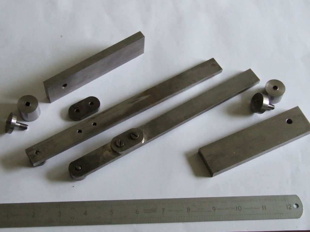

                    I couldn't give a ****** if people laugh at me, smile, so here's a picture of the parts I did/was trying to silver solder:
                    I have the small set of vermiculite blocks sold by Cup Alloys for a hearth. The SIevert burner is 2941, about 7.7kW, as that is what came with my torch kit.

                      Andrew,
                      Looking at those shapes … It may be worth trying the Silversmith's approach instead of the Engineer's … i.e. make Pallions of strip, or form rings of thin wire Silver Solder, and include these in the joint space … When the solder melts, it then flows outward through the joint, towards the heat source. Remember to position the parts such that gravity is your friend not your foe !!
                      P.S. … Some helpful notes, here

                        Going by the sizes you state ( & pics ) you would be far better off stick / mig / tig welding those pieces, or if you can oxy/acetylene brazing; not saying it can't be done but you would be using a lot of gas & flux to get those items hot enough & mechanically strong enough for the use you want to put them too. Back in the day when I taught apprentices I used oxy/acetylene torch, cleaned areas with emery, flux paste applied, heat with a neutral flame till red hot, then dipped heated brazing rods into flux & applied to red hot area, dipping & applying rod as you pushed heat along joint with the rod flowing into joint ( steel plate, butt, lap, Tee, pipe to plate etc. )… just my 2 pence worth.

                              Your torch should be upto it, mine is a bit smaller and will do large steel though it does take a while to get it upto temp. These bits are 1"x1" at teh bottom, 1×5/8 ate the sides and 1×3/4 at teh top and done with on a similar hearth.
                              As you can just see the solder has flowed through teh joint which was gapped with punch marks.
                              This is 3" dia and the two L shaped bits from 1.5"x0.75"
                              You didn't say what the flux is, I used Tenacity No5 for that.
                              One other thought have you got the propane regulator turned up, you want 2 bar min 4 bar better.
                              For your levers I would have fluxed it all up and started by working on the round boss at the end, once the solder had flowed on that I would move along to the bosses around the slots. Could be done as two separate heats but as the round boss will have put some heat into the bar you may as well use that and carry straight onto the second.

                                              JOLT (Just One Little Thing), Tenacity #5 leaves a glass-like residue that is not soluble in water – it has to be chipped off. I don't know about HT5 'cos I've never used it.

                                                Silver soldering of steel takes longer. Steel requires more heat to reach brazing temperature than copper. It takes longer. Be patient! Watch the flux. When it goes into a colourless liquid you are at brazing temperature
                                                The answer is to stop heat loss (brazing hearth/insulation blanket) and burn more gas. Fit a bigger burner. The 2941 burner generates 7.7kw heat at 2 bar. It might not burn enough gas to generate the heat required.
                                                Or using the regulator, increase the gas presure or fit a 2942 burner.
                                                Use a long life flux eg HT5 that accomodates the slower heating rate and matches the melting range of your solder. Fluxes have a very long shelf life but I suspect 35 years is pushing it a bit! Replace it.
                                                Borax is fine if you are using brass as the filler metal. It does not start to work until the joint is at 750 deg C. Brass melts at 830 degC. Your silver solder melts at what 650 deg ? The alloy may well melt but it will not flow until the flux works.
                                                A real concern is that if your alloy is 35 years old, then it probably contains cadmium. Getting the alloy to the temperatures required for borax will definitely give rise to the production of harmful metal fume. The alloy will also take on an "orange peel" appearance.
                                                Overheating a joint is one of the most common reasons for poor results.
                                                Do not use borax flux with cadmium bearing solders.
                                                Getting the heating right is the skillful bit associated with a simple process! Get it right and it's simple. Get it wrong and it's frustrating (?)

                                                  Keith: Thanks for the advice. I have read the notes on the Cup website. Having bought some HT5 flux and 455 grade silver solder I had another go over the weekend. Another complete failure. crying 2 The flux did change, but the job never got even dull red and the silver solder didn't melt when touched on the job. So clearly the job wasn't hot enough. Another possible clue is that the job doesn't just get discoloured with thin oxide layers as one would expect. Instead it seems to 'grow' a thick pitted layer, mostly where the flux was, that makes it look like it has been rusting in a field for decades. It comes off when pickled, but looks 'orrid, and clearly isn't going to help the silver solder flow:
