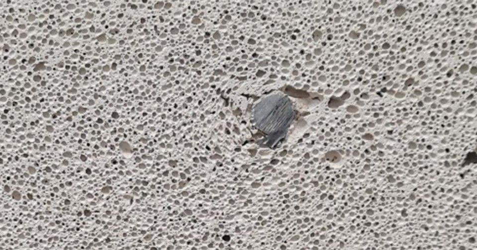

                        #658866
                          Posted by Justin Thyme on 02/09/2023 14:40:34:
                          Is it the same or simlliar to what used to be known as Concrete Cancer? The steel reinforcement within the concrete rusts and expands thus destroying the cement, so I would guess it can't really be stabilised.
                          Yes in principle … but the special feature is that this stuff has similar structure to a Crunchie bar in the first place.
                          Image credit is in my album.
                          Edited By Michael Gilligan on 02/09/2023 17:56:50

                              @madmike
                              The problem AAC concrete is caused by the fact that in manufacture it is aerated. Cut it in half and it looks like Aero chocolate, but does not taste so nice. It has a number of benefits on which it was sold.
                              Lightweight: It floats in water.
                              Cheap to produce.
                              Great thermal efficiency,
                              Great noise insulation value, so ideal for multi occupancy dwellings.
                              Can be easily cut if necessary.
                              However in their haste to use these characteristics some body in just about building design/architects practice forgot to check and compensate for its reduced compressive (load bearing) strength.
                              Edited By JasonB on 03/09/2023 06:51:32
