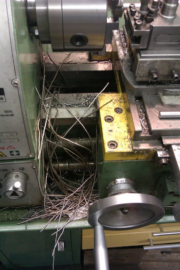

                    Plenty of other suppliers other than Glanze, Mine were JB Cutting tools, look for SCBCR and SCBCL such as the ones from APT
                    Not sure why Clive's one can't easily be used for facing, could be as his are pin location rather than the screw location I have and why my codes start with S for screw .this is mine in action
                    Although you get an angled shoulder when turning diameters they still work well for shifting metal, seen here roughing out an EN8 crankshaft and not so cumbersome that you can't use tailstocck support
                    Firefly138
                    Firefly139
                    And a deep cut in aluminium with CCGT using the spare corner

                    Clive Foster
                      @clivefoster55965
                      Jason
                      Mis read my post I think. Mine are OK for facing but thats about all.
                      Being pin lock on a 20-20 shank for the CCMT 12-04 size inserts I have its all bit cumbersome.
                      Your smaller inserts and screw lock shanks are vastly more handleable. Doing something like your second picture with my bigger inserts and shank is barely worth the hassle.
                      Even working 12" to the ft scale.
                      Which is why I've never bothered to get a right hand holder.
                      Size really does matter and for the normal model engineer I can see no reason for setting up to use -12- size inserts. Go smaller.
                      Locking into -12- size over a decade ago because the price was right may have been a mistake on my part although there are no issues with plain turning and the insert in normal configuration.
