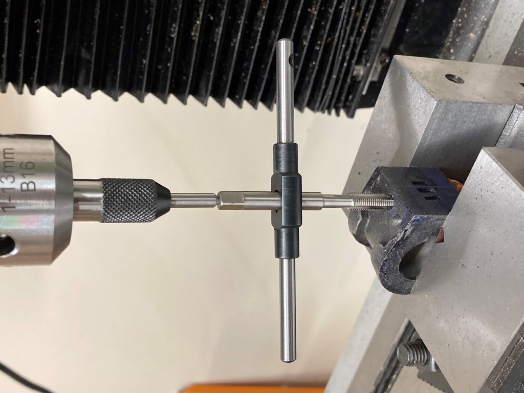

            #609578
              If using the drill chuck I tend to leave it slightly loose on the tap and drive the tap with the wrench part way down the round shank. Trying to turn the whole spindle by hand will not give much feel on small taps.
              The alternative is to make up a simple guide which can just be a short bit of 1/4" or 6mm steel with a point turned on one end and deeply ctr drilled at the other. This can be held in the chuck or collet and brought down with light quill pressure as the tap is turned again with the tap on the round shank.
              having the tap on the round part acts a bit like a slipper clutch as the wrench will hopefully slip before the tap brakes if it bottoms out or jams.

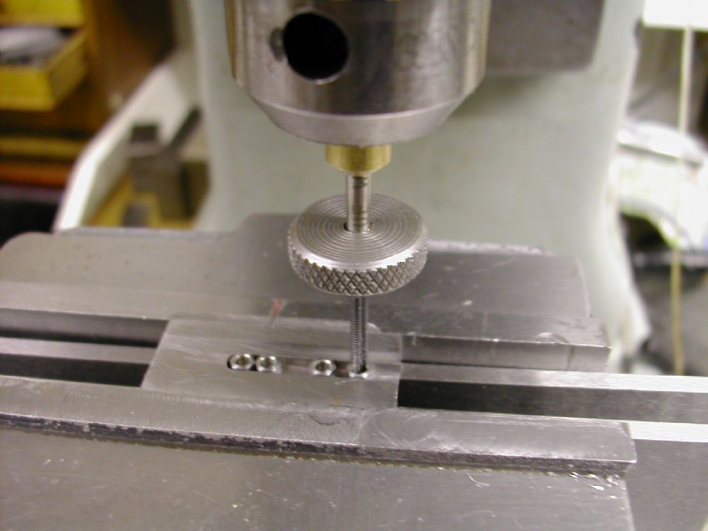

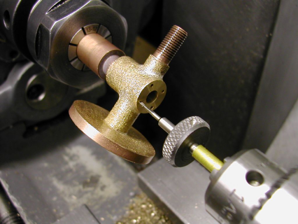

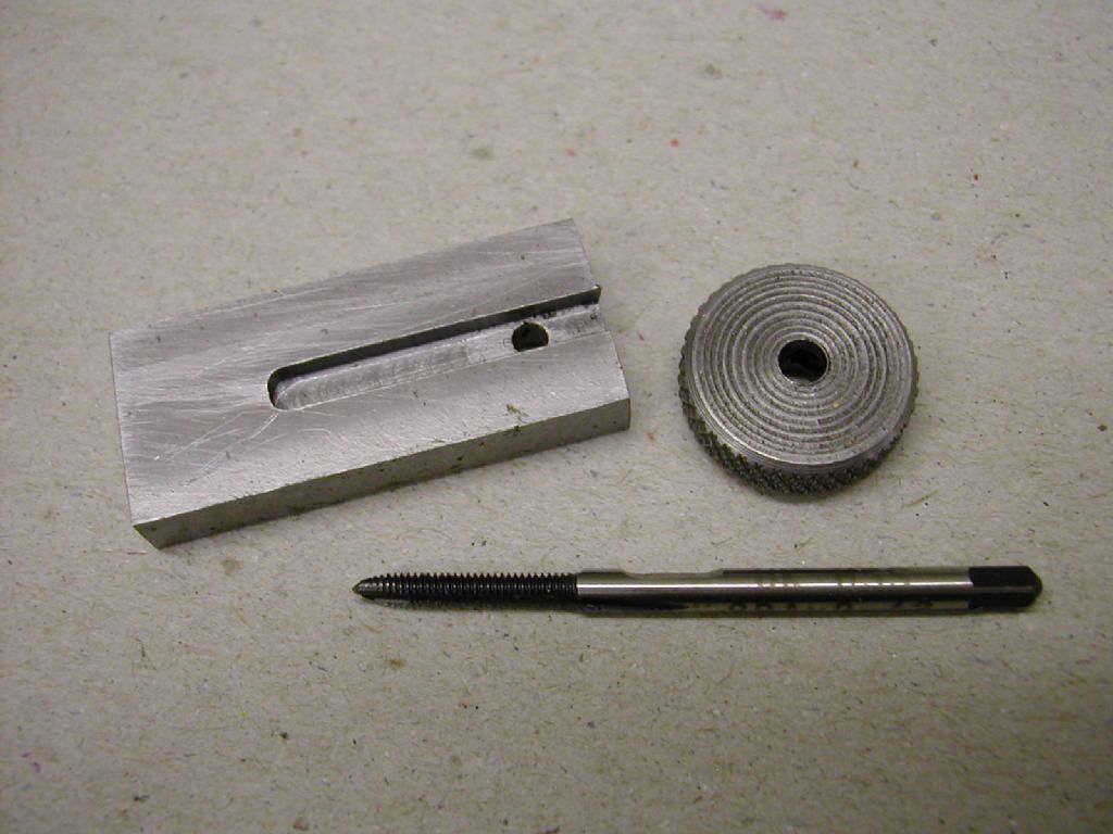

                    I don't like the internal support cone centre for one reason – you need three hands particularly to keep the contact with the tap as it drives forwards.
                    I much prefer to hold the tap very loosely in the chuck and use the method Jason shows but always grind a small flat on the side of the tap for a positive drive even on small taps down to 10/12BA. Tap shanks are not always a standard size but if a brass tube can be drilled or found to fit and held in the chuck as a guide even better
                    I don't think these small Eclipse tap wrenches ae available any more but are ideal for this. This is tapping 8BA – 48 holes on two cylinder blocks without a hitch. For the smaller 10 BA and below taps I use a circular tap wrench – just a slice of 3/4 dia knurled MS with a grub screw in it to drive the tap – again on a flat on the shank. The tap is turned between finger and thumb – very sensitive feed back from the tap
                    I don't know how many small (5BA down) holes there were in total on the above build but all were put, without breakage, in this way or by gently gripping in the drill chuck, turning the drill on then off and as the spindle runs down use the residual motion to drive the tap in four or five threads until the drill stops. Release the tap, remove and finish by hand.
                    Hope that's of interest too
                    Tug
                    Just realised I had these images too – shows the smaller wrench n use

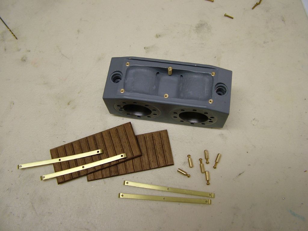

                            Ramon Wilson
                              @ramonwilson3
                              You are more than welcome to what castings I have Steve – no charge but help with the postage would be appreciated. I'll have a look what's there this morning then send you a PM later.

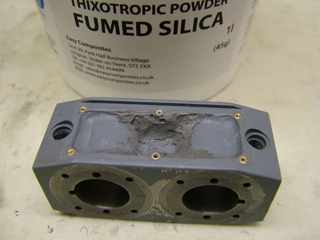

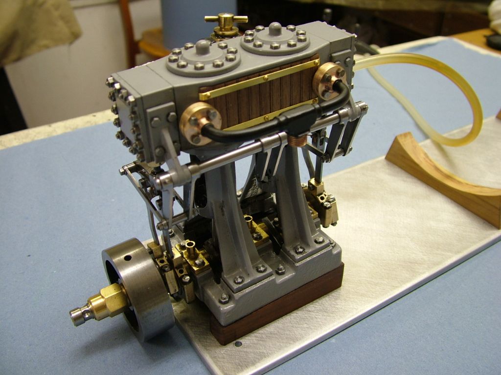

                              With regard to drilling and tapping very small holes in cast for such things as lagging bolts things can be eased slightly by using a slightly larger tapping drill but a much safer way (safety as in looking after the tap) is to drill and tap small brass inserts on the lathe and Loctite them into pre drilled holes in the casting.
                              If you are unfortunate enough to break the tap then at least it's not in the casting.

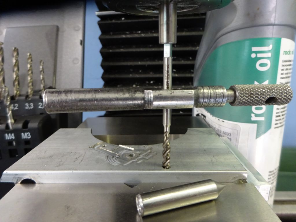

                                I feel things have moved on since the UPT was published in the 70s. back then very few would have had a mill so drilling could have been done with a tailstock pad, on the vertical slide or with a basic bench drill. None of these are ideal as tapping guides.
                                Move on 50years and the number of hobby workshops with a mill has increased considerably, many of these also have a DRO added to them.
                                This to me is the perfect tapping guide as after drilling you can go back round an position the spindle exactly over the hole and then tap using some of the suggested guide methods mentioned above. If odd shaped castings have taken a while to set up at an angle they will still be at that angle without having to transfer the setup to a UPT. If it's a hefty casting or block of stock then will a 10BA or M1.6 tap really pull 1kg of iron exactly below the spindle?
                                You also have the option to power tap if you mill can do that, though best for through holes. Add in modern spiral point or spiral flute taps and you also eliminate the backing off needed to break the swarf which is cleared from the hole by the tap. Yes they will even lift CI swarf up out the hole.
                                £150 cost of castings, materials and a chuck would go a long way towards the cost of a small mill.

                                  Hopper
                                    @hopper
                                    Ramon — Now that's a darn cunning trick with the brass inserts Loctited into a larger drilled hole. yes

                                        Posted by DMB on 15/08/2022 09:22:19:
                                        …Just one fly in the ointment, quoting LBSC, will the Loctite withstand the hot steam? Is it a special heat resistant type?
                                        Yes. Loctite 620 is good for 230C so good for most model steam use. O
                                        In LSBC's day there was not such a wide range available. The original Loctite was basically a sugar solution. You could taste it. And anyone who has worked in a sugar mill or refinery knows what a universal threadlocker sugar is. Oxy torch is the order of the day for undoing bolts and nuts on process pipework there.
                                        Edited By Hopper on 15/08/2022 09:33:59

                                          Ramon, it certainly is not the best option for all jobs and one I rarely use on a model but do on jigs and fixtures. Smallest I have power tapped is M3 and largest M12 all through holes not blind. My main mill is the X3 which does not have the tapping function so probably why I don't do it so much but the SX2.7 has it and it works quite well, if I had a DRO on that machine then I expect it would see more use. The standard quill spring provides all the lift needed Quite a few of the Hobby benchtop mills will have this tapping function so they have the means.
                                          Yes most of my imperial stuff is still traditional straight flute taps though I have a couple of BSP spirals. That brings us onto costs. I think Tracy double the price for spiral flute but that is for what are now lesser used BA threads. Again moving on Metric would bring the price down, that M6 tap in the video is £5.10, a M2.5 which is close to 8BA £4.64. I use that brand for general work but on the Models I use a slightly better YG-! range which would be a couple of quid more. I rarely seem to use BA these days and even ME is getting used less as I have Metric fine in the common sizes found on our sort of models
                                          But that is only half the story, with spiral flute you only need the one tap not three so you are actually paying LESS and a spiral flute will work just as well in through hole so a single spiral flute will do for all your tapping needs. This is why I bought the Spiral flute BSP taps as I was tapping a hole that was quite shallow and blind and the taper of the taper tap hardly did a thing and 2nd was not going in.
                                          M£ about 3mins 20 into this video as well as M5, 1/4BSP and M12. Green buttons on teh quill levers reverse the spindle

                                                    Hopper – I don't know about 'cunning', just something I came up with as the inserts are 14 BA and I didn't fancy tapping the cast iron using the only tap I had – again. I had previously done so on another engine and, as mentioned previously, used as DMB suggests, a larger size drill. Whilst that certainly eases the tapping pressure on such small sizes it raises another issue of the thread engagement being marginal at best in such small sizes. It worked well so will be used again on the Marine Compound.
                                                    Loctite used would have been basic 638 – as said the temperatures involved on steam had no effect – the engine shown was run on steam under 'working' conditions powering a model boat
