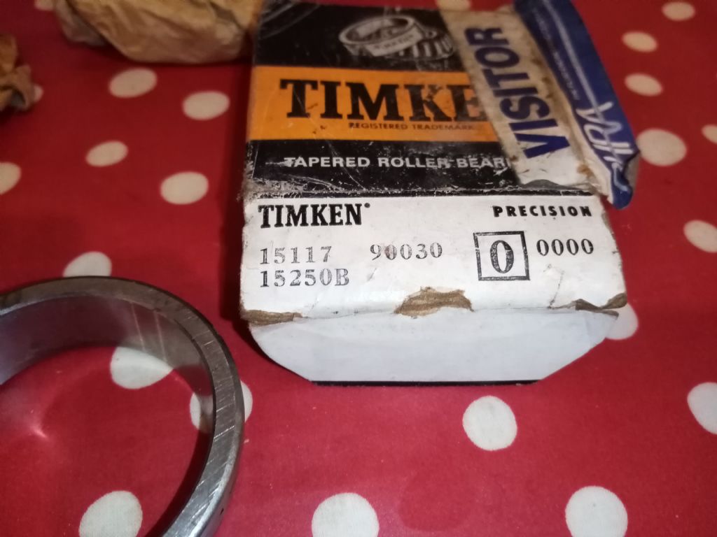

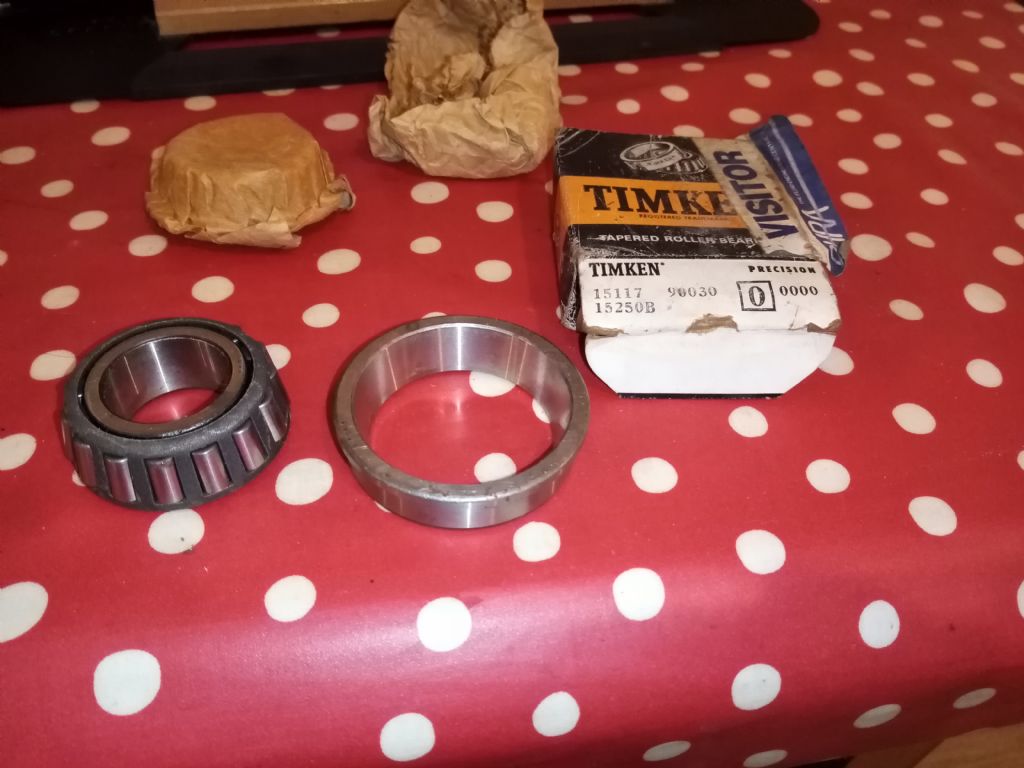

            #534736
            duncan webster 1
              @duncanwebster1
              I
              I've had this for many years, cant even remember where I got it from. Little bit of surface staining but not on races. If it's any use it's yours for the cost of postage, send me a pm
