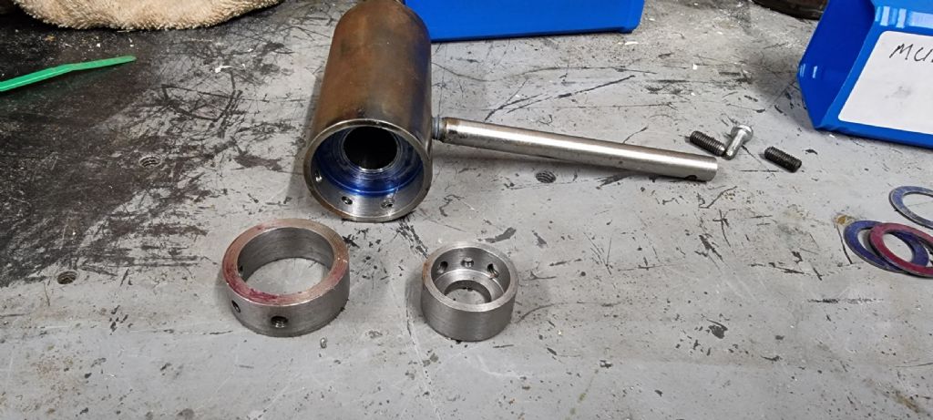

                #538057
                Steviegtr
                  @steviegtr
                  I made this one a while back , that holds all my different dies. Cheap as chips & not a lot of time to do.
                  Steve.
