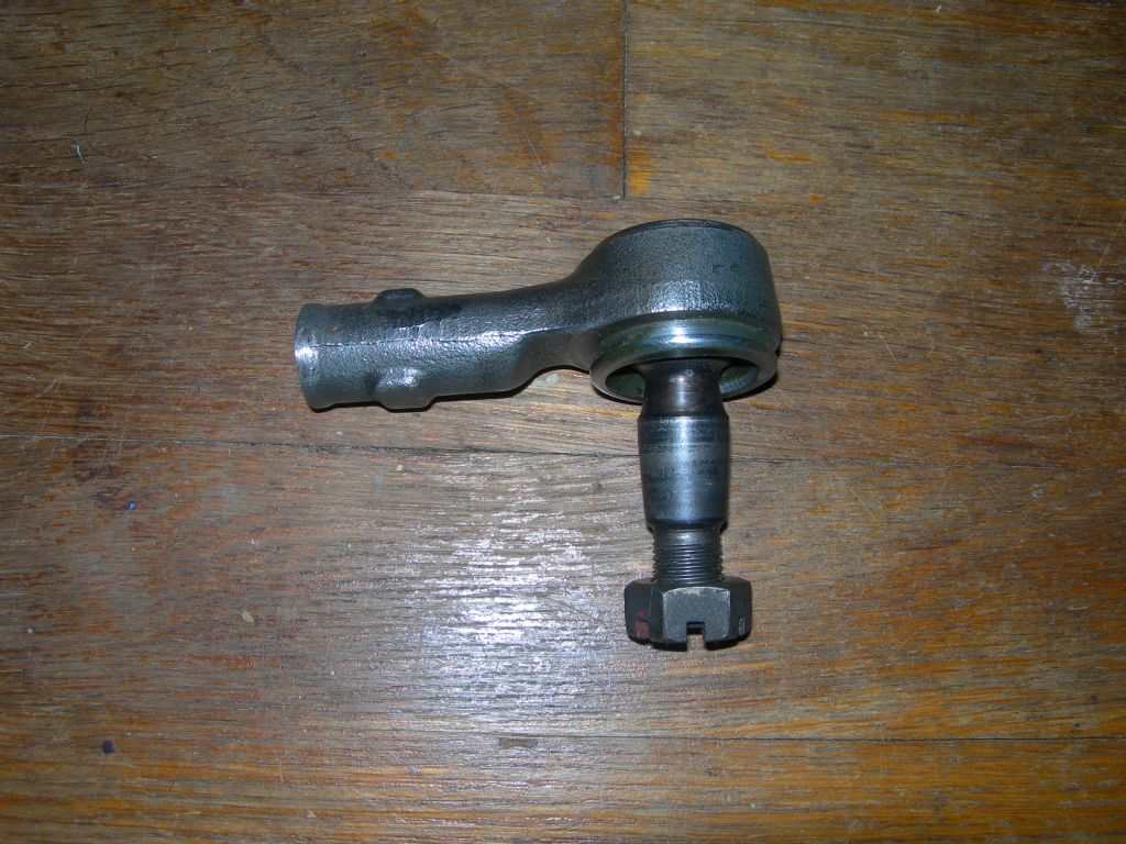

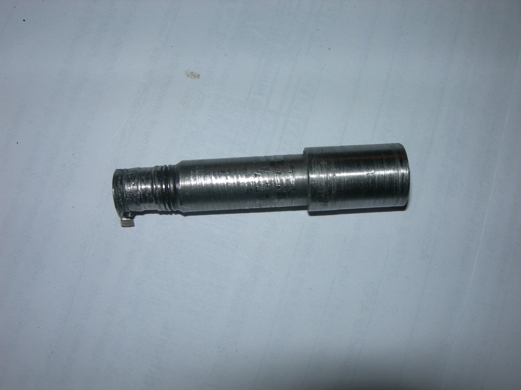

                      Anyway, as stated, saw drawings in old MEW and made what is basically a specialised fly cutter.
                      slot depth of cut was about 4mm and width of cutter about 3/16"(I grew up before metrication so switch back and forth easily)
                      I found another tie rod end, the main shank was made from, worn out but probably a pretty high grade steel (pulling the steering around on couple of ton old ISUZU 4WD my stepdaughter used to have)
                      Used that so I could make the part that fits into collet a larger diameter – more surface area, probably better grip?
                      The article gave instructions for grinding a tool bit for clearances, the angle it's set at (7~10 degrees) means you don't even need to grind anything from lower edge. I'll try and get picture from magazine,haven't used scanner in years and not sure it even works any longer (plus could be copyright issues?)

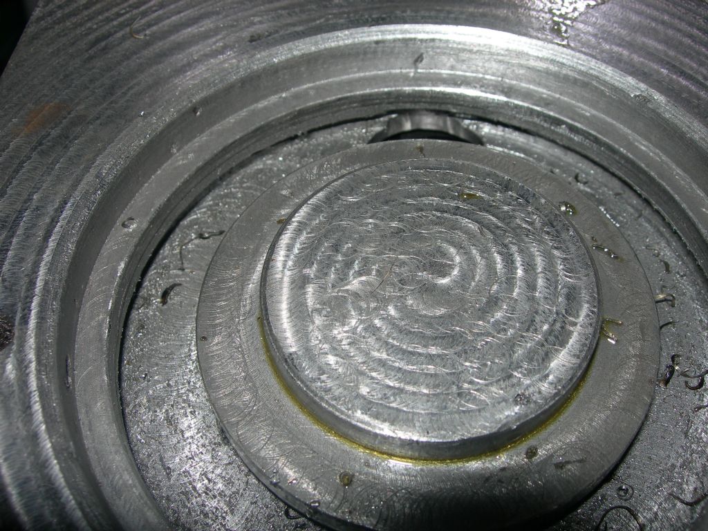

                        I created and album so here is a picture of 4 bolt tool-post mount (4 bolts to bolt to carriage t-slots)Lathe parts
                        The large hole was for the t-slot cutter and to get t-head bolts in

                          Used T-slot 'flycutter'
                          T-slot flycutter

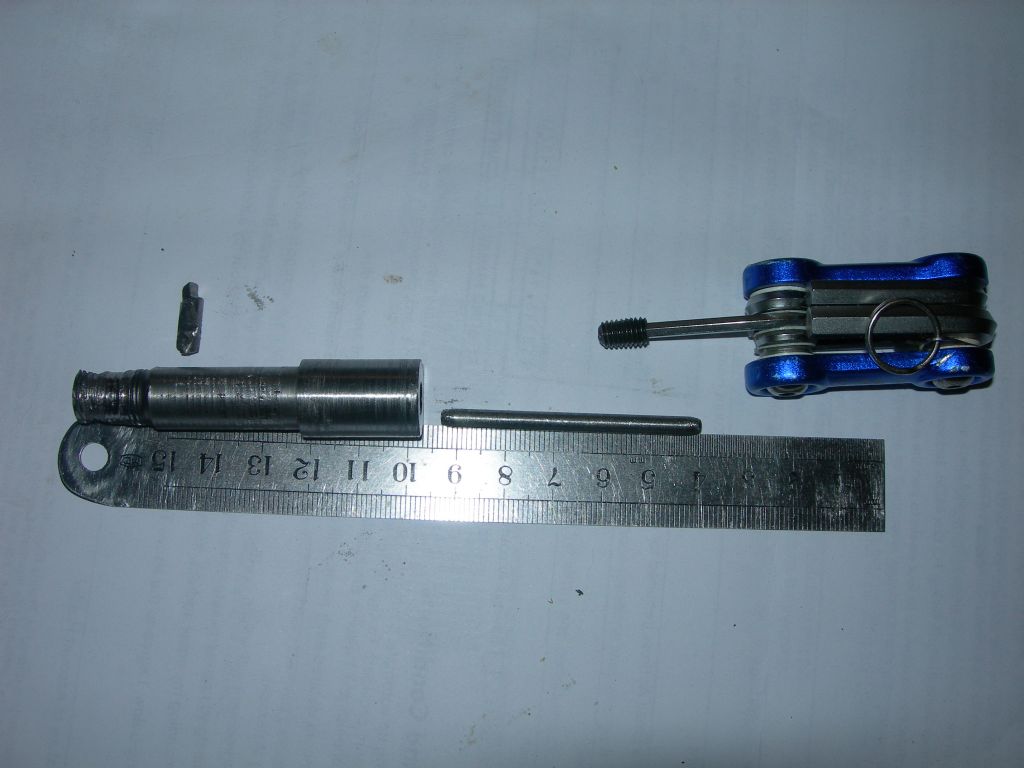

                          Tool disassembled, 6mm Allen grub screw, push rod, main body and not very well ground cutter
                          T-slot cutter parts
                          'Raw material, Isuzu track rod ends
                          Raw material
