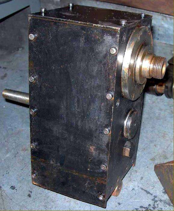

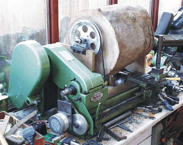

                              In days gone bye when new large Chinese lathes and ex-industry old British iron weren’t readily available, one of the options was to bolt a second headstock to the bed that was driven by the lathe spindle:
                              big swing
                              Image from Lathes.co.uk
                              A suitable riser for the tool was also required.

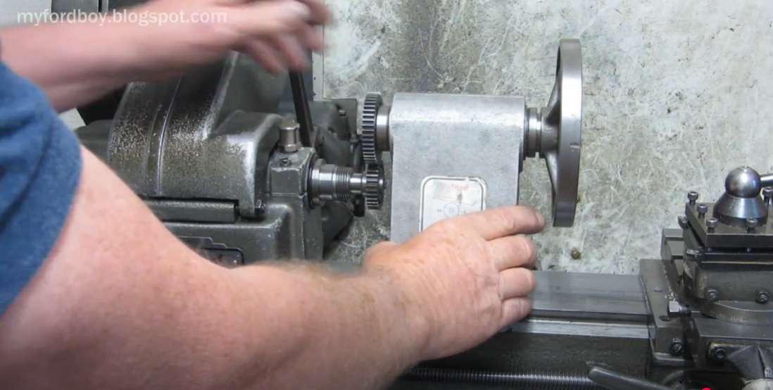

                                            Julie’s comment about mounting on the horizontal arbor made me take a second look at these wheels which are offered cheap
                                            hul

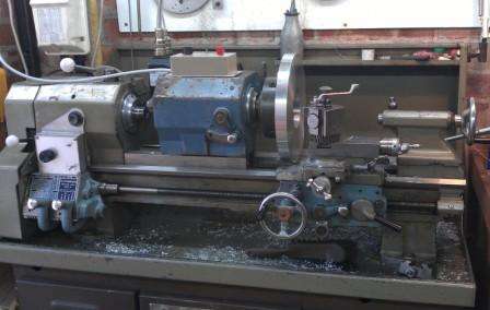

                                              Been there, and have the Tee shirt!
                                              This is a 5″ Boxford temporarily modified to machine a 12″ diameter aluminium part. I was fortunate in that at the time I needed to manufacture (an end cap for underwater camera housing) I had a spare headstock off a 4.5″ model A
                                              Lathe with two headstocks
                                              The headstock is packed up on on some 1″ square MS barstock, not visible in this picture is a (second) motor on a bracket hidden behind the headstock. I used the lathes power cross feed to do the facing.

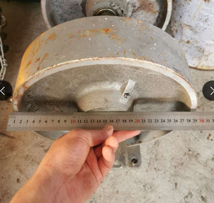

                                                I made this for my ML10 and can turn 12″ flywheels now!
                                                ml10

                                                  Nice! Where did you get the casting?
                                                  #815131
                                                  Engine Builder
                                                    @enginebuilder
                                                    I made my own castings.
                                                    Sadly i don’t have the pattern anymore so cannot offer it to others.
                                                    I had a big clean out of all the patterns i had made and never thought anyone would want on of these.
