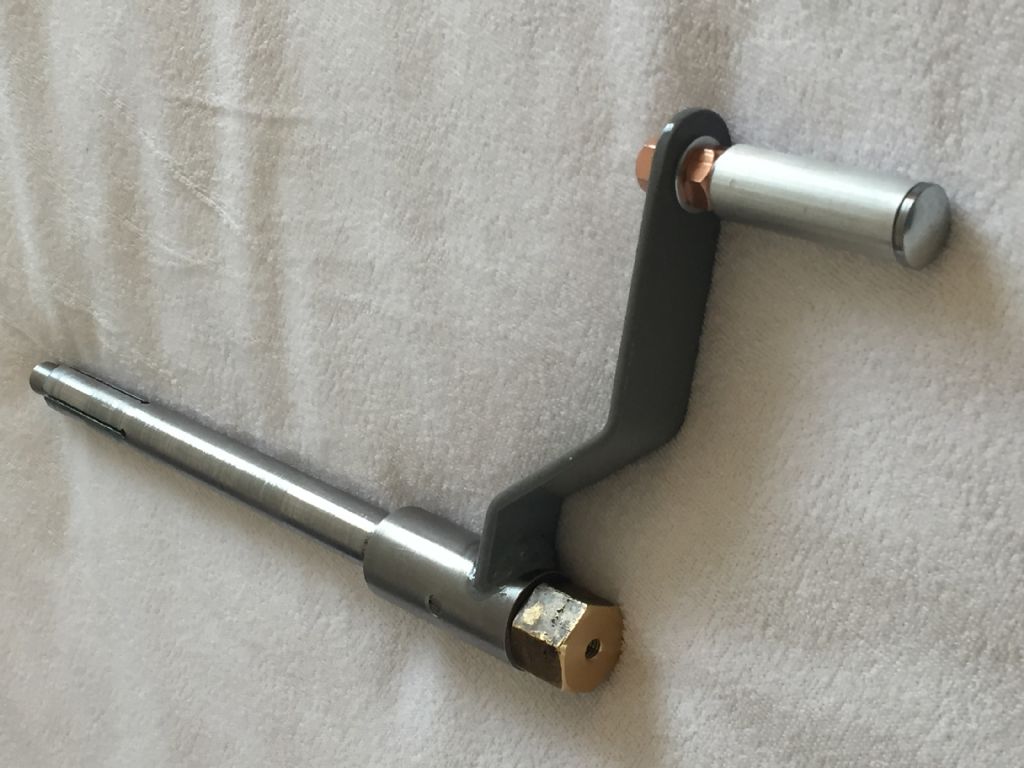

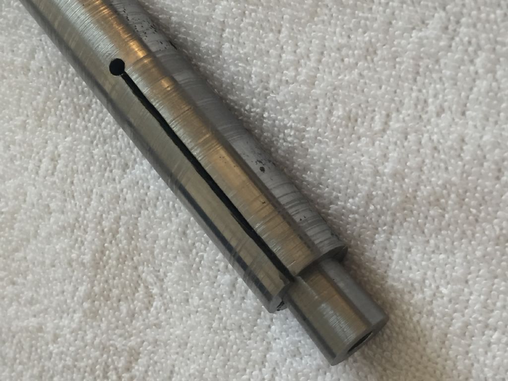

      My take on a spindle crank handle for my Super 7 lathe who's bore was more like 16mm than 19/32". I made the main shaft from bar so had to push a 6mm drill bit through 210mm which took a bit a bit of clearing!

          I made something similar a long time ago but was always fearful of forgetting to remove it after use. I bought a spoked wheel off an exhibition junk stand and fitted it to a spindle like yours but shorter so easier to drill out. I still have to remove it before turning but at least I feel safer, should my sieve like brain let me down. There is a small lever handle on the rim and I think that it causes a small out of balance load resulting in chatter when turning. That is why I still remove it.

            I get distracted very easily so I'll have make a big "Check for handle" sign next.
            I made the handle for cutting short threads instead of playing Russian roulette with the clutch!

                And I cut the slots with a hacksaw too.

                  Why does it need to be so long it would drive the spindle from the end without having to be so difficult to make?

                    The bore of my spindle tapers slightly towards the middle so I thought to position the expanding part at the point but as an aside I suppose a longer shaft helps the he handle to run true.
